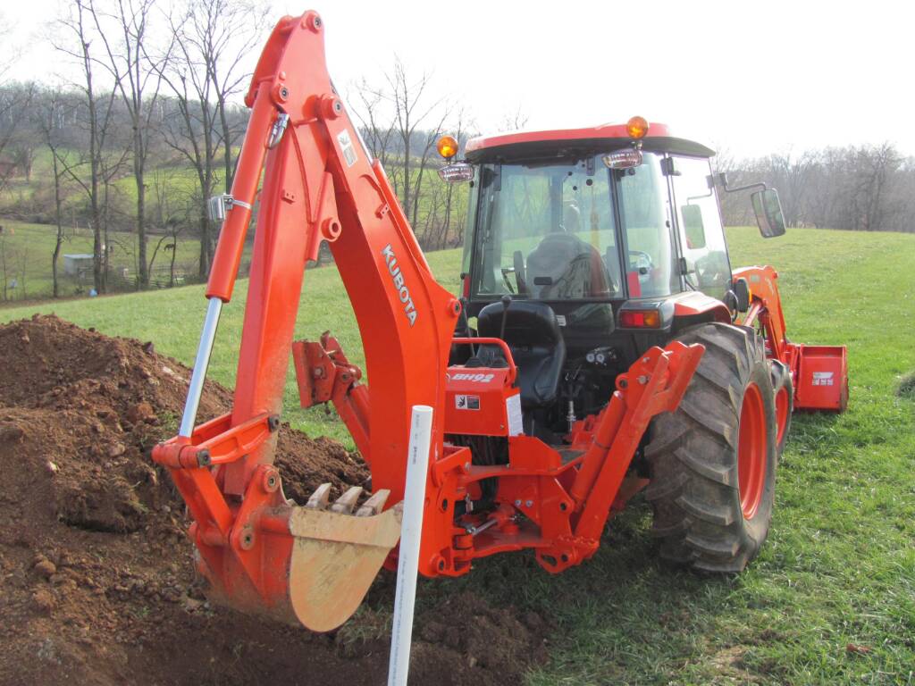

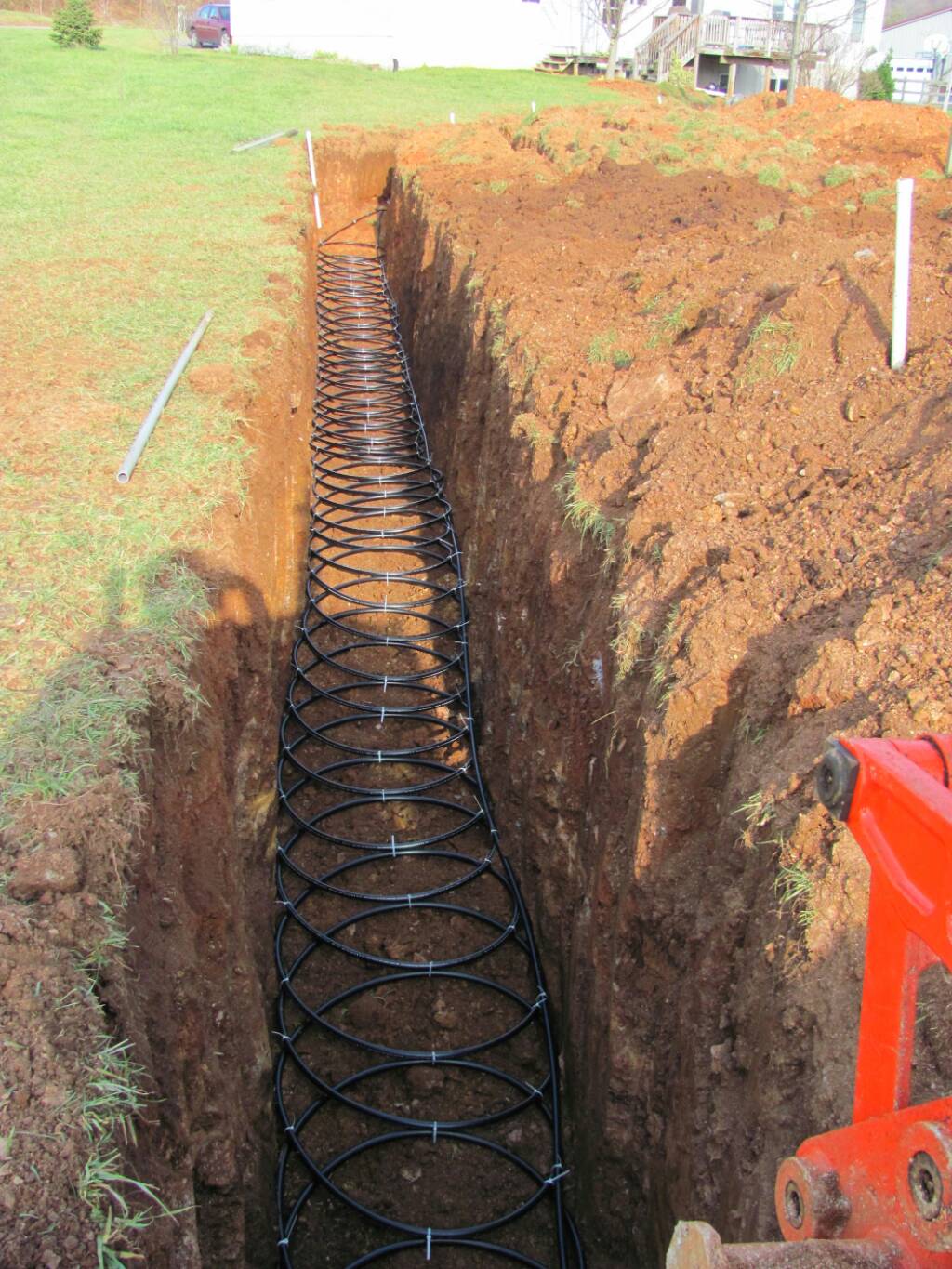

Thats true, i got quotes before deciding to install my own. Prices may have come down now with a lot more people doing installs. I took the money i would have paid someone else, and bought this.
My slinkies are 65' long, 3' wide, per ton. I put in 2 units, 3 ton and 2 ton.
   / Actual cost of firewood #148
