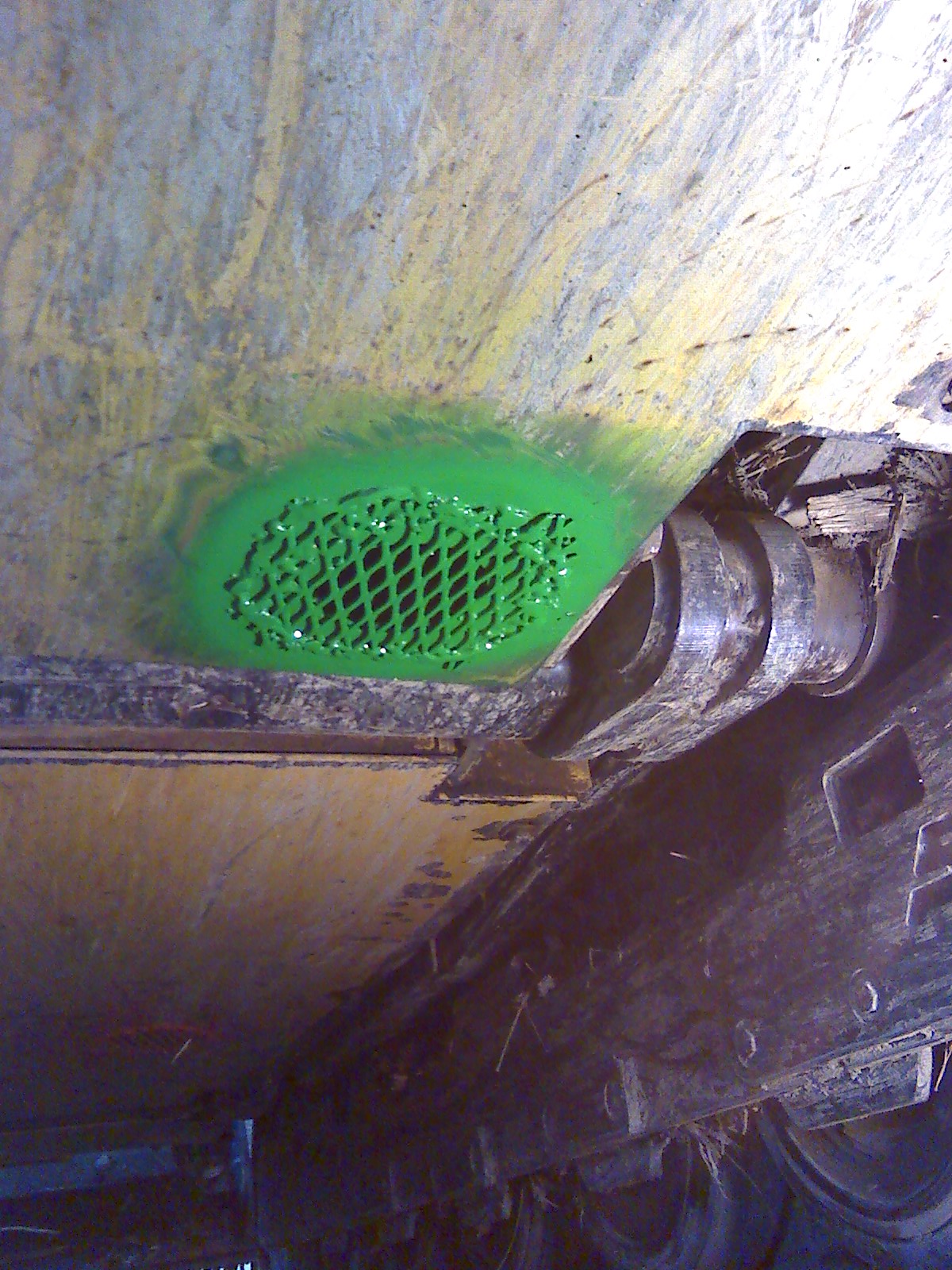

Higher track repair costs are typical to forestry usage. Turning on cutoff brush digs into the track. Debris get lodged into the undercarriage. Material in the track is impossible to see from operators view. As in picture below, debris can be quite damaging. Combined with continuous full throttle usage and major heat generation, forestry is really tough on any machine. After denting the oil pan with a branch, I welded some mesh over the access holes under the engine and pump.

I know that type of work is going to be tough on a machine, but having rocks, gravel, mud and concrete getting in the tracks and UC is pretty damaging if not more so. $10.00 per hour for UC maintenance is crazy.
I am surprised that your oil pan was that exposed, aren't there skid plates under it? Mine has 1/4" skid plates under it from front to back.
I do enjoy seeing a well set up Cat or ASV doing forestry work... love to seethe wood fly when they get into a tree or heavy brush. :thumbsup:
I feel your pain on the track issues, but I'm curious about the mesh you welded over the access holes. What do they access, and what do you do when you have to go in there?
   / actual repair cost by hour usage of skid crawler undercarriage #37
I don't know why there are two 4" holes in the skid plates. They originally had rubber plugs, but they got mulched a long time ago. The holes are not convenient access to anything. I figured drainage. The expanded metal stopped the debris problem. In addition to denting oil pan, another stick pushed the wire connector off the oil sensor. The skid plates are heavy, I use a floor jack to drop & lift when cleaning out machine.

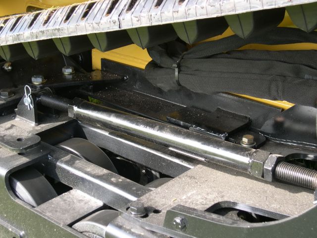

I also added some after market hose protectors to the undercarriage. They work well in stopping branches from damaging hose assemblies.

The holes in the belly pan are so you can access the oil drain plug on the engine without dropping the pans.
On mine I got a 1/4" x 3" plate and drilled a 1/2" hole in it. Then I got a 1 1/2" x 3" plate, drilled a hole in it, then welded a nut on it. Slide the skinny piece in, then run a bolt through it to squeeze it together. Then you can take it off later if you want.
