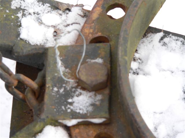

Ergonomic improvement....grabbing the pin with a gloved hand was a little tough....call it what you will, but God bless bailing wire!

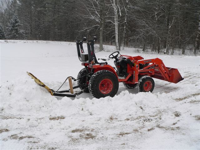

I thought a little 7610 would have trouble pushing a full load of snow...no problem pushing this load anen when I got back on and resumed pushing. Granted the tires are loaded but the turfs in 4 wd really grab well.
I bought chains which I don't think I'll need excapt maybe for a really deep wet snow with some ice under it.
I really like having the plow on the back and the FEL on the front. I'm glad I did not tie up the FEL by adapting the plow to the front. My driveway is only 70 yds long....If I had a 1/4 mile driveway I think looking over the shoulder that long would give me a pretty sore neck and back but for me this is great!

That, sir, is a classic of its kind! I got a kick out of that "cellulose fiber strut", also being a cheap Scot.
Good work!

Nice lookin job, won't be long before you will be adapting it to the front.

I know this is a very old post. I'm considering similar choices with a snowbear snowplow. Have you continued with this setup? Or did you change your mind eventually?
Thanks for any updates... or links to updates that exist already...

Nope....remains the same to this day. I replaced the wood with another block after the original rotted from storing outside. Very glad I didn't tie up the bucket.
I have plowed a crusted-over 2 1/2' with snow coming over the moldboard and it has handled it with chains on all four wheels. That was extreme and with the plow angled fully it would fishtail the front wheels. The instant solution was to pick up a massive chunk of frozen-solid snow from the old banks in the bucket for additional downforce out front.
I highly recommend this rig if your driveway isn't too long. Having the FEL available on the front is VERY useful all winter.
I would imagine the deflection with the plow angled would be far more pronounced with the plow way out in front of the bucket and from a damage perspective, 3 point hitch parts are a heck of a lot cheaper that fixing bent FEL arms.

That's great! I haven't made up my mind yet, whether bucket mount or 3pt, but you have renewed my interest in trying the rear approach. Thanks.
