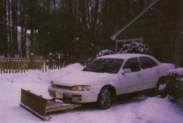

Perhaps this future creation will be on a lower budget with engineered weakpoints to take the stress like my last homemade plow...yes, I drink ocassionally

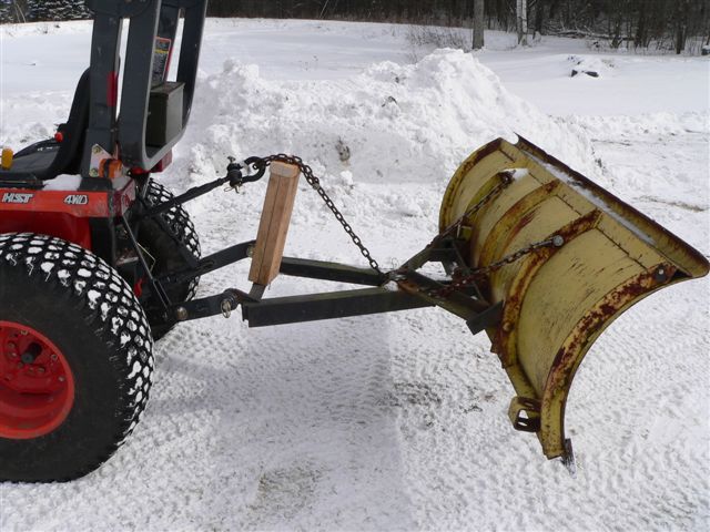

Here it is! I took the plow of my buddy'e old IH Scout jeep before New Years and finally got up to the Vermont place this weekend and had a bit of snow tho test her out on. (you call this a winter?)
This works slick. I plowed 5" off the driveway into one huge pile for the kids starting ramp for sledding....hard telling who had more fun, Dad or the Kids!!!
   / Adapt 6ft snowplow to 3 pt hitch???
#19

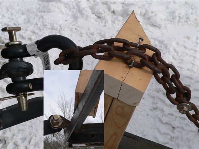

With no downward force on a 3pt hitch, the critical thing is to drop the lift arms BELOW HORIZONTAL so the force doesn't push the arms up.
I was all ready to buy $45 worth of steel and have the guy who gave me the plow weld up a 3pt frame but my advanced Celtic engineering skills (cheap Scotsman) kicked in and with the addidtion of a cellulose fiber strut and rigid ferrous cellulose attachment modules (block of wood and 4 ten penny nails) success was acheived.
I have $18 into this thing.,,(2) 3pt hitch pins (@ $6ea.) and a Clevis hook thingy (another $6) and some scrounged wood and nails (priceless) .
It's a manual angle--stop, get off pull the pin, move angle, get back on--works slick. If I already had rear remotes, I'd probably make it power angle but $18 beats $500 plus.
