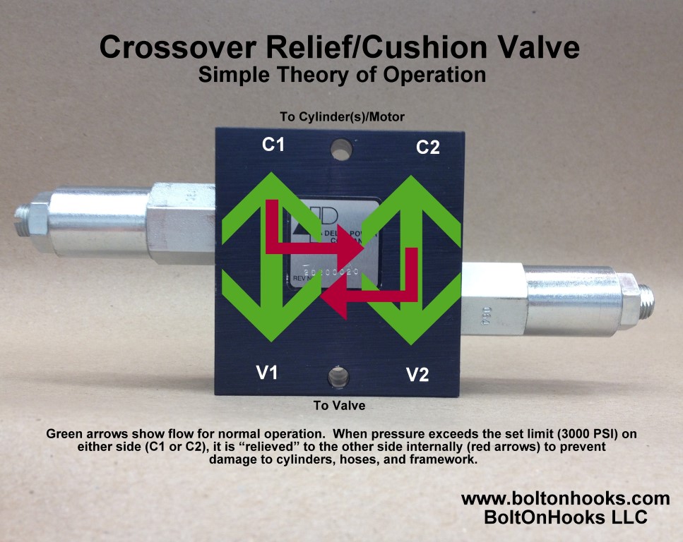

The CRV (crossover relief valve) goes between the two cylinders, and the valve:
Bailey is well respected in Hydraulics, they will stand behind anything they sell you.

Your hydraulics are not going to work as-is. You need another valve. You need to be able to control each wing individually. So on your FEL valve, up and down can be up and down on the plow. Left and right can work for one of the V-wings. But you need a valve to control the other. If you hooked the two hoses of the SA cylinders to the two curl ports, the plow would only act as a straight blade, with no V or no scoop.
I also dont advise the single crossover valve. You will need a separate pressure relief valve that will return to tank for EACH of the angle cylinders. Cause with a V plow, if you are in scoop position and catch something with one of the extended wings, there is no room to dump the fluid into the other cylinder as it is already extended. So it is possible to blow BOTH cylinders and lines if you hit something hard.
