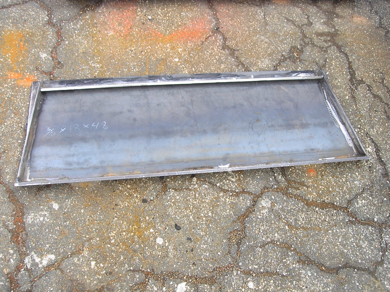

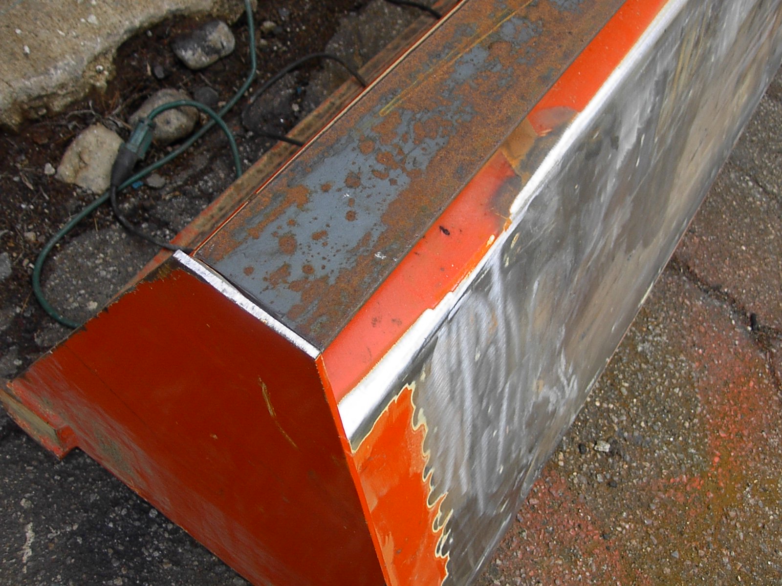

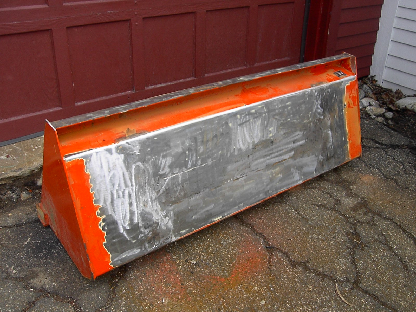

I finally got around to doing my bucket. I had to have a local shop cut the factory brackets off the back of the bucket. I local steel shop cut me the steel I needed. Originally, I planned on simply using the backside of the bucket itself to mate with the QA on the loader. Unfortunately, it got a little warped when the brackets were cut off. Not bad, but it was no longer as flat as I would have liked. So........ back to the steel shop I went to get a piece of 3/16ths plate cut to 4' x 18". I cleaned up the areas on the bucket that I would be welding to with a flap disc.

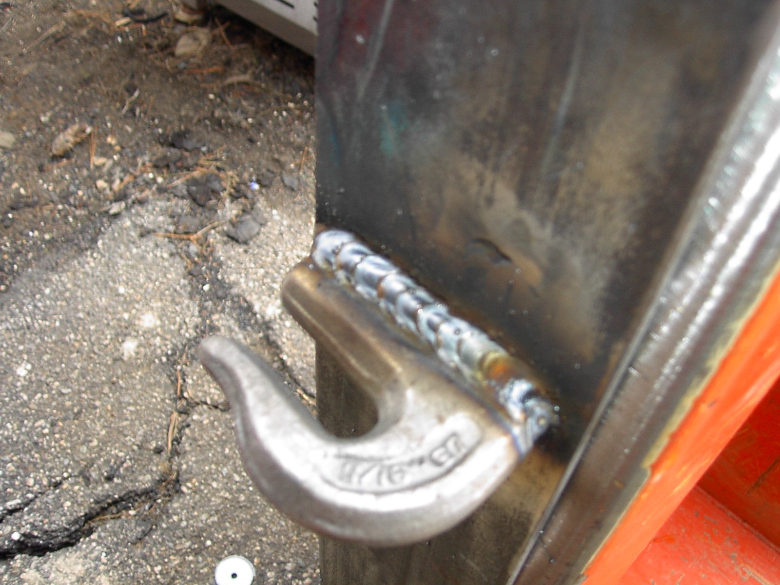

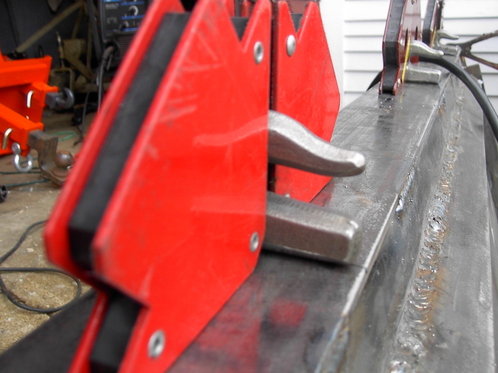

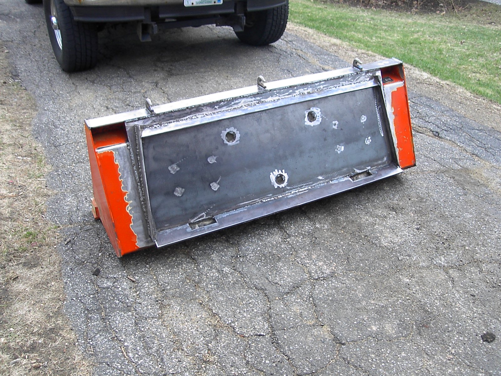

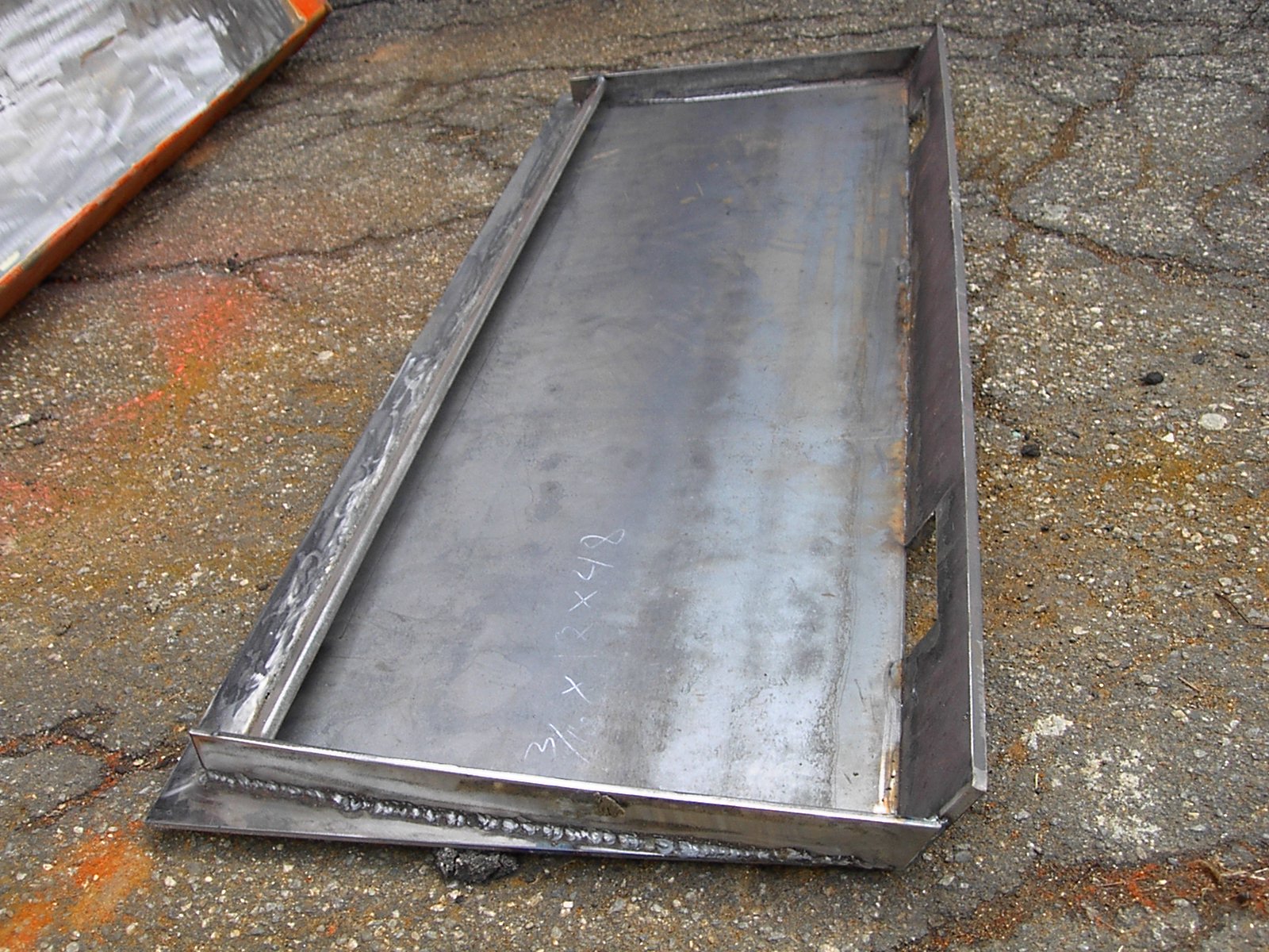

Next I assembled my QA plate. 3/8ths for the top and bottom bars, 1/4 for the two sides. I also added some 3/16ths to the top of the bucket, effectively doubling the thickness. Not only welded on the edges, but I drilled holes, especially near my bucket hooks, and plugged them. Then I added three grab hooks across the top.

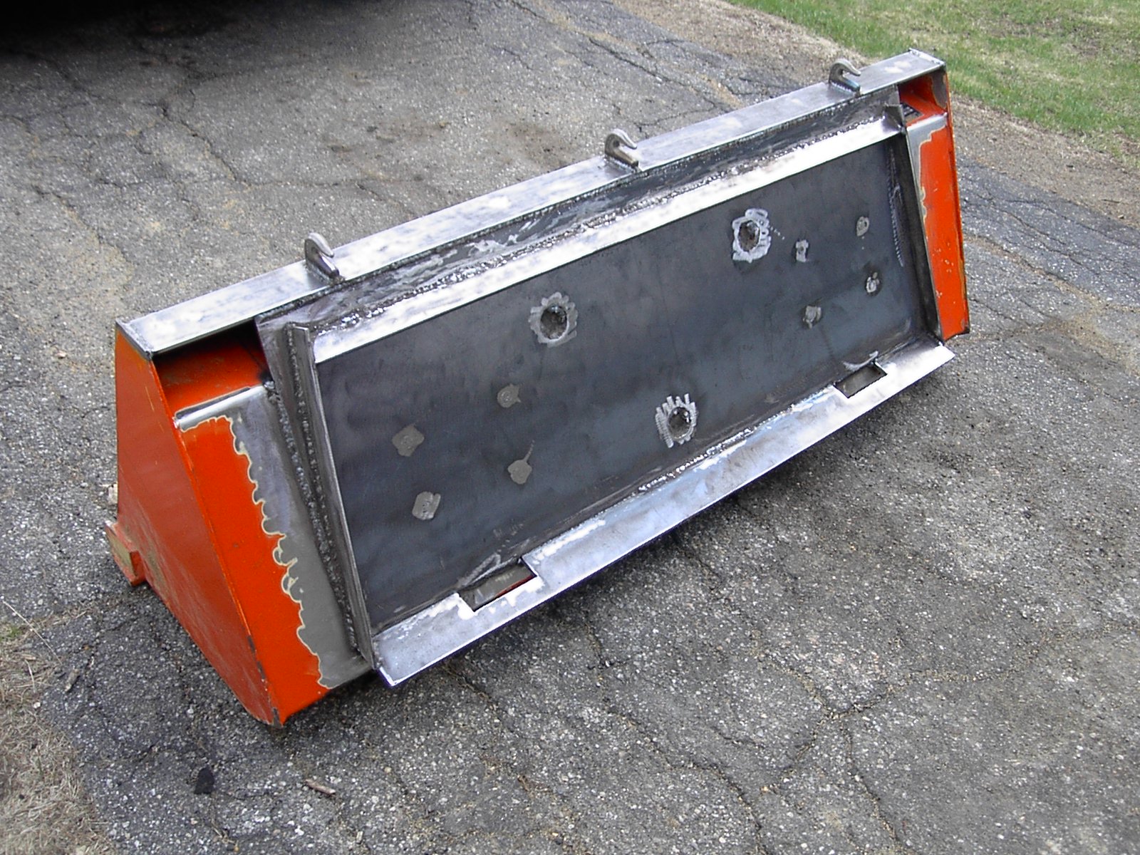

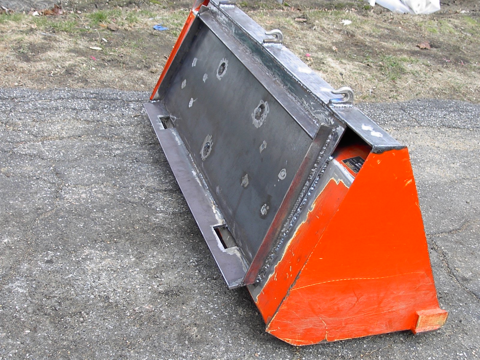

I welded my new QA plate to the back of the bucket, and voila !

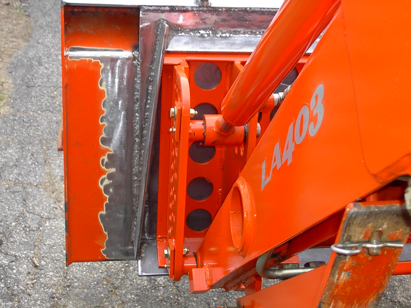

I notice a couple of the QA buckets I looked at down at the local dealer were tapered on the backside. I decided I'd try this. My QA is 44 1/2" at the top, and 48" wide at the bottom. This will (in theory) allow the bucket to self center as i drive into it and lift it.

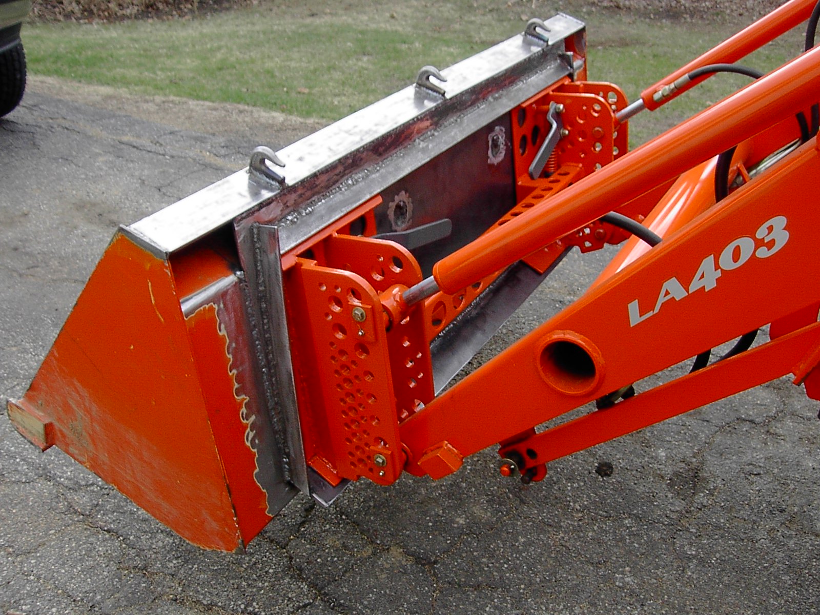

Fits like a glove. The pic of the back of the bucket shows the taper.
