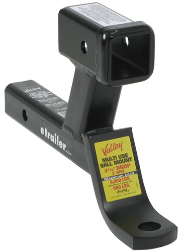

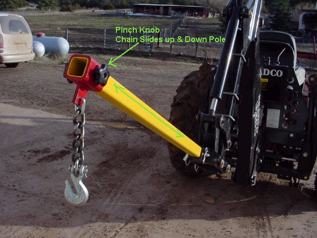

Its actually just an eight foot piece of tubing I'm going to use to make a couple different attachments. I wanted to see how much reach it would give me.......... but I'm thinking if I left it that long I'll end up flopping my tractor on its side with it. My plan at this point is to make something around four feet to be able to reach into my truck or trailer.
That being said, I'm always open to good advice !

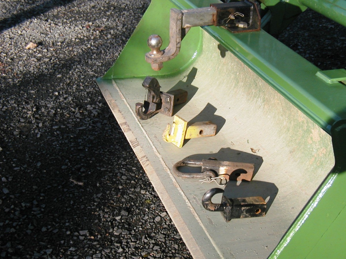

Ductape, The advise that I was going to give is that if you are installing a 2 in receiver, on the bucket, also add a 6 in high x 2 in vertical extension on the top of that with a weld on chain hook on the top. On the end of the boom, also weld a weld-on chain hook on the top, and a large half ring on the bottom. This will also give you an extra chain hook in the center of your bucket. These two chain hooks, and a chain between them will let you pick up a load without bending the boom or receiver, Easy to put on, and easy to take off. You could also weld more hanging points under the boom for different weights. The closer in you lift, the more weight you can lift. Did you notice all the other accessories someone else had in his bucket, hooks, 2 in ball. ring. etc. You could even go longer on the boom if you use the same guidelines
On the yellow boom pole, the red bracket can be locked on anywhere on the boom. You will still need a chain for tension.
