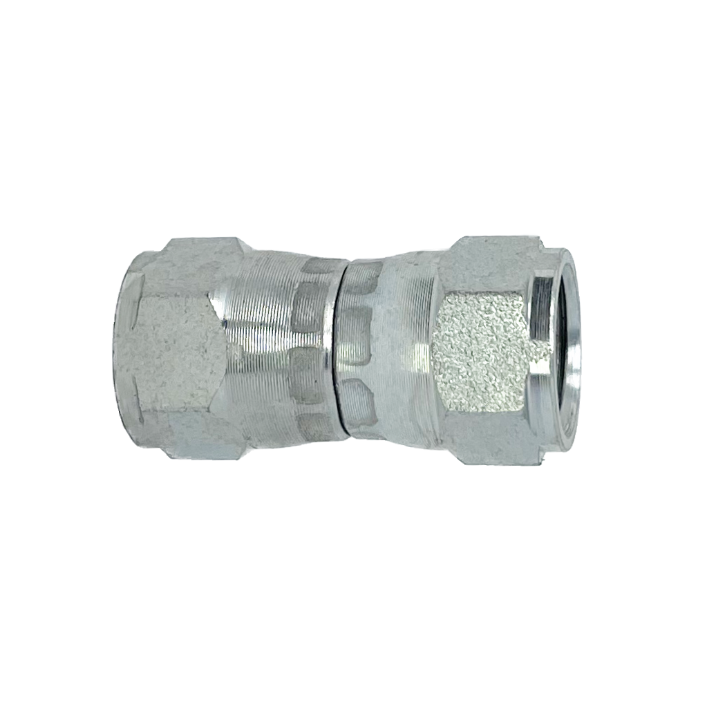

This project has turned out to be more complicated than expected and I’m barely halfway through.
I simply want to connect a control valve to the quick couplers. The control valve has six 3/8” male JIC ports with 9/16”-18 thread. The six quick couplers have 3/4”-16 male JIC threads.
So simply put, I want to connect a steel line to a device with a 3/8” male JIC on one end and a device with a 1/2” male JIC on the other.
It seems like a simple process but I can’t find a way with either 1/2” or 3/8” steel lines. Is this possible.

The valve has adapters screwed into the ports, they are most likely ORB/SAE ports. So, just get different adapters.
   / Adapting JIC from 3/8” to 1/2”?
That was my original plan and where it became complicated.
Each spool has two ports with fittings. One fitting is a standard ORB however the other is special. It appears to be an ORB with an additional groove cut into the bottom with an O-ring.
If you look carefully at the above picture in post#1, you may see deformation on the sealing surface. If I can’t achieve a seal under this condition I will deposit braze or weld and re-cut the end.
