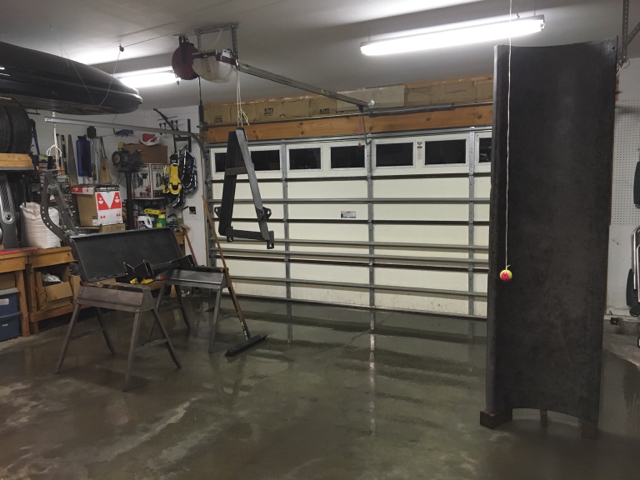

Got things painted today.
I also picked up a 3/4" thick 4'x6' mat from tractor supply. I'll try using that for my cutting edge as others have done.

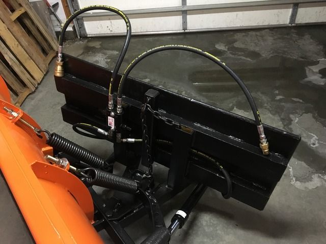

Got things assembled today.
I still need to get the cushion valve and hydraulic lines to finish it up. And also get a piece of 2" wide steel to run the width of the plow to better secure the rubber cutting edge.
Here is the plow at full angle. There is probably 6" clearance at the corners of the QA plate.
This is about how it would look when running it without down pressure from the loader.
Curled forward to provide down pressure.
Overhead view.
View from the back.
So now to get the hydraulics finished up and get some snow. I'm betting on the 2' storm in march this year. We've had almost nothing this far this year. Kind of sad...

#60
Finally got the hydraulic goodies from Surplus Center and got it all finished up tonight.
Got some 3" wide x 3/16" thick steel to hold the cutting edge on a bit better.
Here is a pic of how I mounted the cushion valve. Drilled and tapped the C-channel.
Last a view of the fittings and angled lines to avoid pinching when I pivot the plate forward for down pressure. Out of every female NPT fitting I converted it to JIC and then used JIC 90* fittings so I could reliably angle the fitting wherever I needed.
We had about an inch of snow when I finished up so I had to test it out. Worked great. I did not test the down pressure yet, Maybe tomorrow.
Also, there is no interference between the frame and the cylinders. :)
