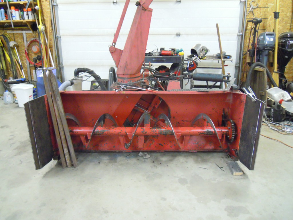

My new tractor is wider than the previous one and now my 74" snow blower is only 2" wider than the rear tires. I know this will be a problem when blowing snow in the areas where the driveway is curved. It was bad enough with the old tractor. I don't really like my old blower anyways, so I'm considering getting a new one. The only choices I have locally are an 84" Farm King with an open gear box and a Kubota K74-24-09 (74" width).
The downside to the Farm King is the open gears (not sure if that would affect it's durability or not) and the smaller fan, at 23" x 7". The Kubota fan is 23" x 8" and therefore would move more snow or just move it faster. The downside to the Kubota is the width. I would have to make some extension wings for each side, which I don't mind doing, if it will still perform properly. Both blowers are the same price and come with hydraulic chute rotation.
Open for discussion and recommendations.

Bolt on extensions is a cheap and cheerful solution to try. If you are unhappy with the results get the bigger blower.

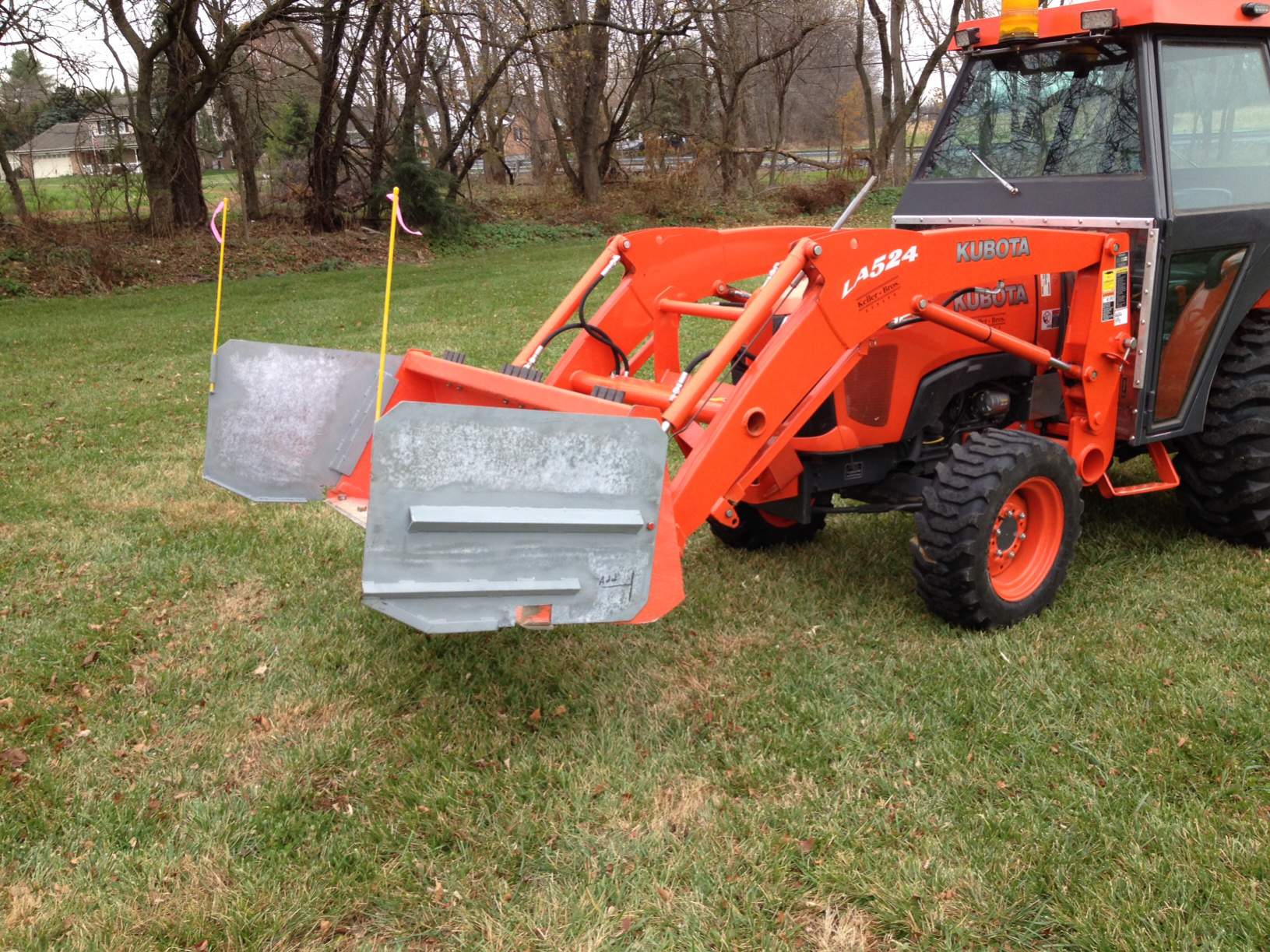

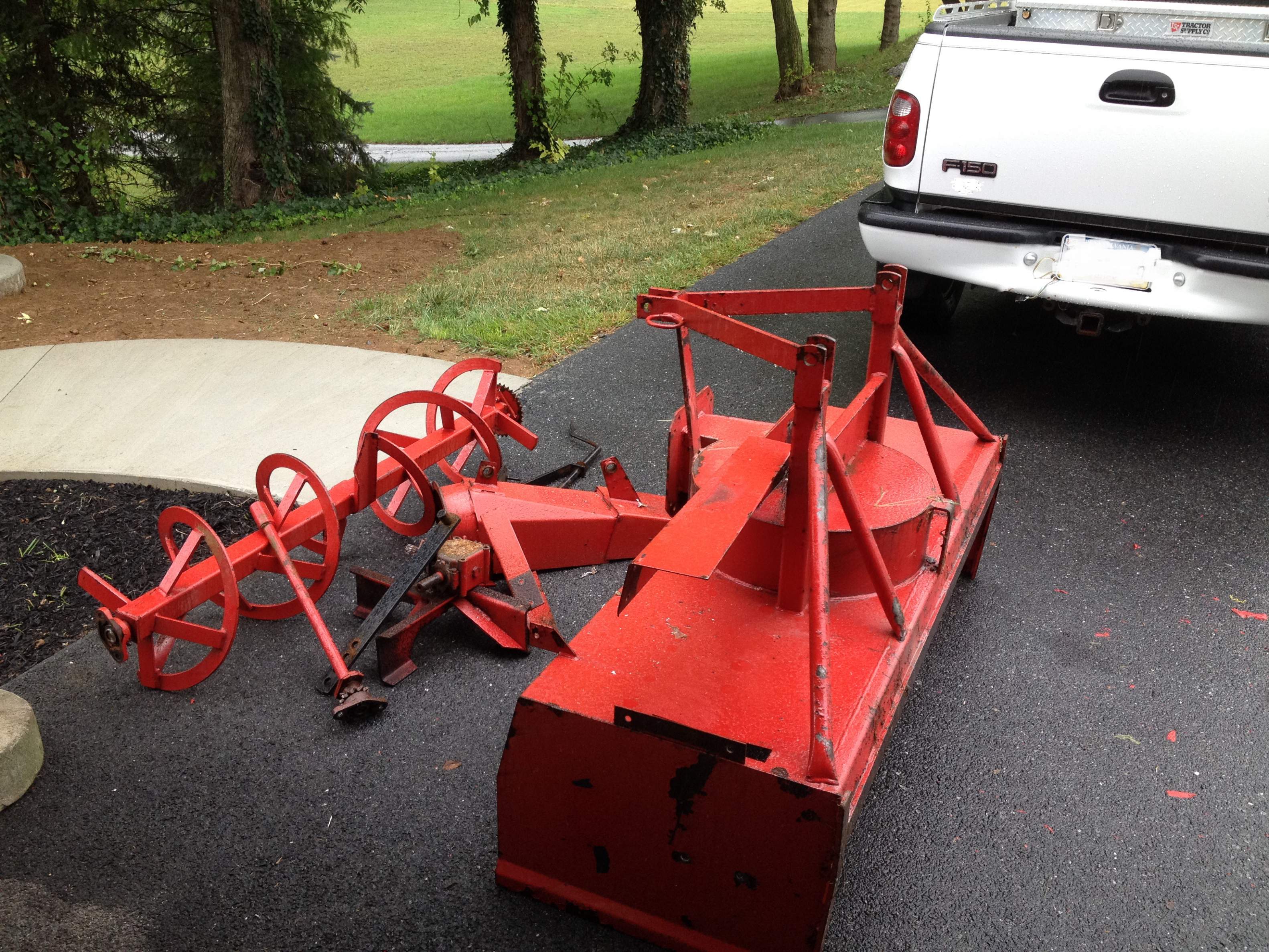

   / Add SNowblower Extensions or Get Wider Blower #5

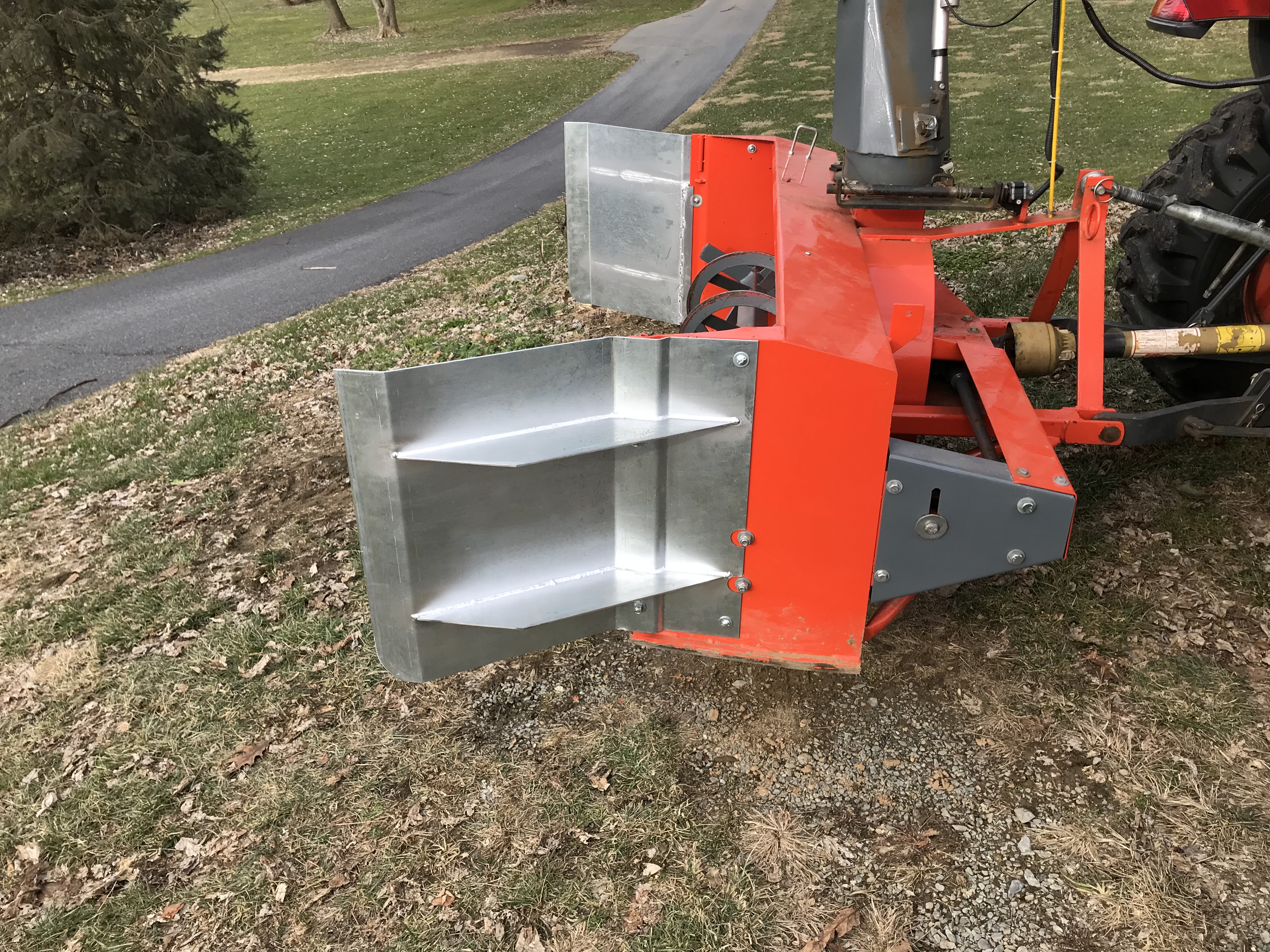

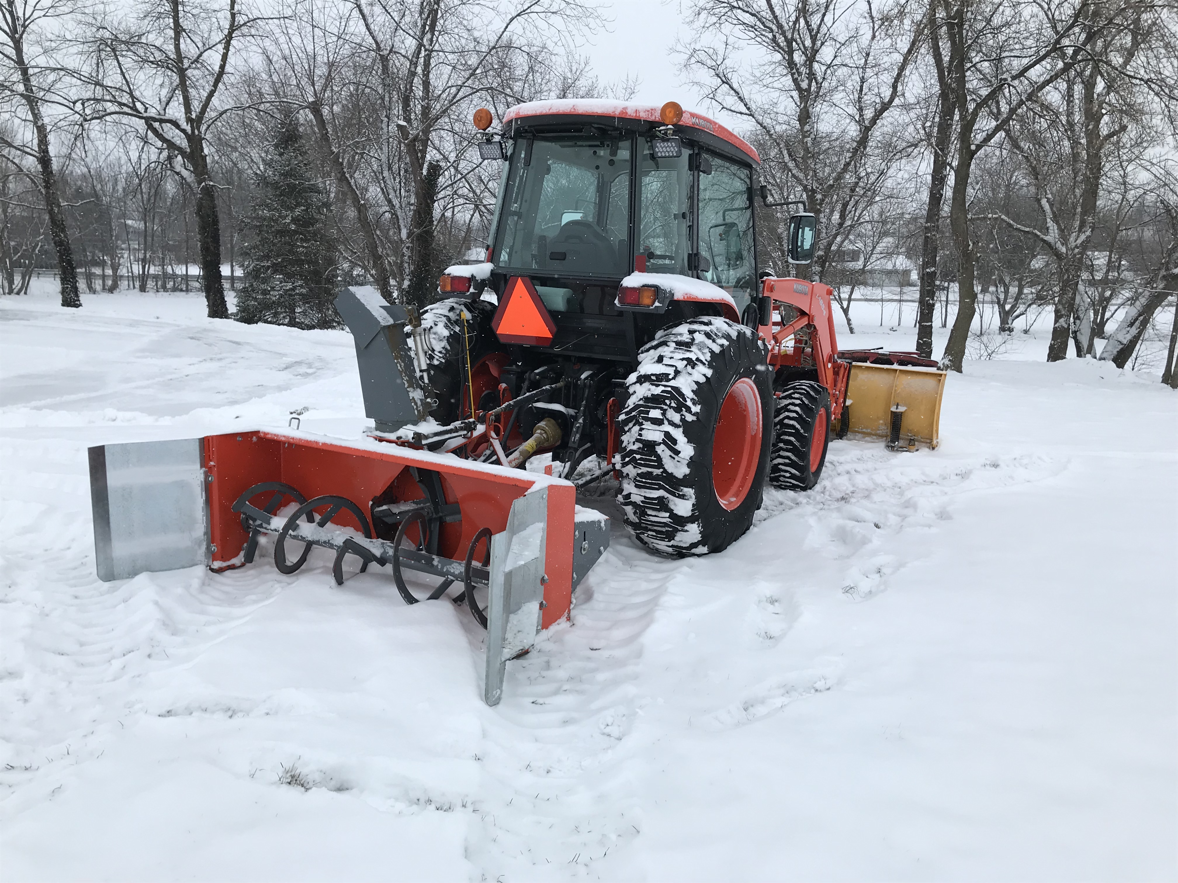

This is what I did last year for switching the blower from the L3200 to the L4240. Can't see the details, but there's a strip of steel welded to the inside of the extensions that sandwiches the ends of the blower housing. This locks the extensions to the blower. Four bolts on each extension hold them on.
After using the blower and the 8' Fisher blade on the front, I decided the blower will probably be sold with the L3200 as part of a package. I do a couple parking lots and the blade works a lot better. Nothing I clear has anything in the way of pushing the snow off the sides, so there's no real need for the blower. It is quite enjoyable to use the blower and watch a big arc of snow and see the driveway look like someone came along and cleared it with a huge dado blade:)

Chim, I have some questions for you, if you don't mind.
Is that a Kubota blower and if so, which model?
Did you have to go slower with the wings added?
I'm wondering if the blower could process the extra volume at the same travel speed or not?
Also how much width did you add?

I have extension plates for the snowblower on my Unimog. When dealing with the really stiff drifts the plates add just enough resistance that I cannot push into a drift to break it up. In which case I have to remove them. But for normal (loose or lightly packed) snow the gathering plates work great. So I'd say if you have difficult conditions go with the wider blower. If you only deal with dry, loose snow the gathering plates work great. Wet snow is another issue -- but that's why they invented lubricating sprays.
