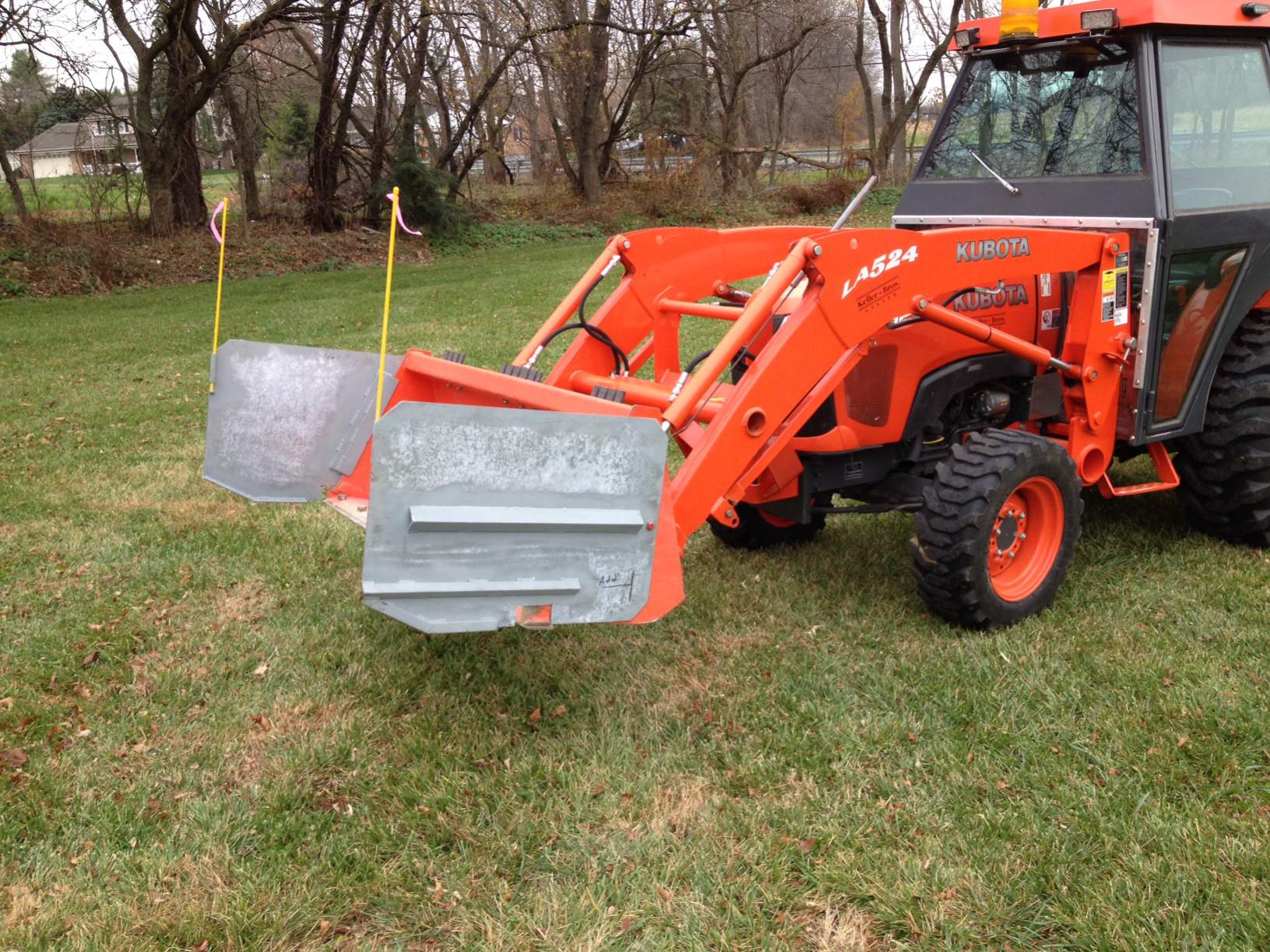

The last picture shows bucket extensions I used on the L3200. With this "Amish Snow Pusher" on the front and the blower on the rear, I thought it was the greatest thing. So the theory was to make the blower wider for the new-to-me L4240 we got last December and make bucket extensions for it. Then instead of making bucket extensions for the L4249, there was a deal that couldn't be passed up on the 8' Fisher and the new project was adapting the plow. After using the plow, the snow blower was relegated to being rear ballast.

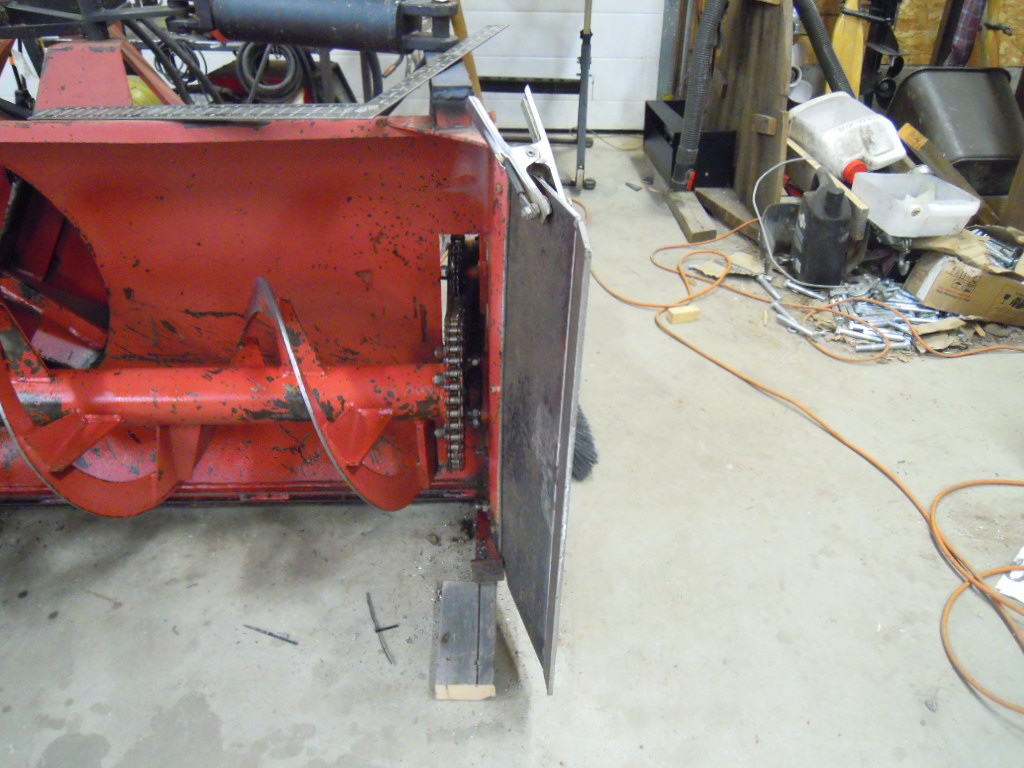

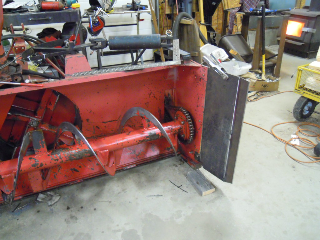

I finally got around to making some extensions and will give them a try when we get some snow. I went with 3" on each side, which gives me a total width of 80"
Here are some pics of the partially completed wings. Just need to finish the welds and then add some support brackets / stiffeners.
