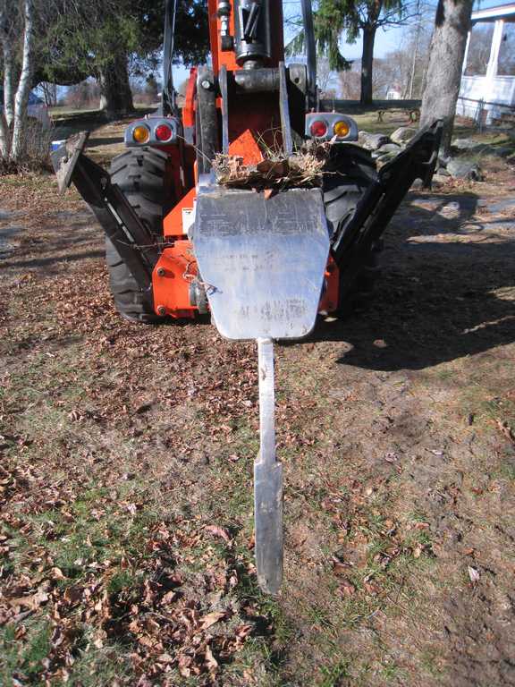

After searching for several years I never found a supplier for a smallish BH (Note: I forgot about Brotek, they do sell a ripper for the BH70x I believe. Lighter duty than the MIE ripper) so I worked with Michigan Iron to custom build mine. I can tell you that Woods does not have one for their BH line. They did provide me with the drawings of their bucket mount which was very helpful.
I too thought of an add-on bucket attachment but having used the ripper now I can say pretty confidently that an attachment would not work. The lever arm would be too long and would not have the power needed to rip.
My BH90x has enough power to easily rip 2-3 inch roots with one motion. For larger roots I use the tip and down force to spear the root and then curl to rip it in half. A few small teeth front and back would enhance cutting larger roots.
A BH70x has less power but an appropriately sized ripper like mine should work well. Certainly it would work better than the bucket. The correct size is exactly the length of your bucket face including the tooth. I'd guess 18 inch for a BH70x but do the measurement.
Michigan Iron has fabricated a number of the BH90x rippers and they are great to work with.

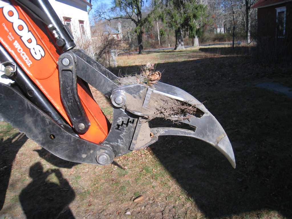

I tried getting a large maple tree stump out with my BX24, and after trenching all around with the BH, found the remaining tap root system still held it solidly in place. My pickup wouldn't budge it with chains. I want a Bro-tek ripper, but it isn't in the budget.
I went to Tractor Supply and bought a ripper tooth for $38, bought a new 5/8ths drill bit for $14, and some 5/8ths 2" bolts, nuts, flat and lock washers.
A short time later, I had a reversible ripper tooth attached to my backhoe bucket. Originally I mounted it "tine up", but found "tine down" worked better to spear under the main root ball and strip away soil and break apart the underside roots that kept the maple in place. As soil accumulated in my perimeter trenching, I still had the use of the bucket to pull it out, without switching between a dedicated ripper, and dedicated bucket. I mounted it in 'bucket neutral' alignments, so I can pull in or thrust out; and it doesn't hit the BH frame when I curl the bucket all the way in.
The ripper is very solid, and I was lifting the tractor with the torque applied at times. I may sharpen the inner shaft edge above the tooth, to cut through roots rather than snapping them, but I'm extremely happy with this multipurpose adaptation, that cost less than $55.
Being able to switch it between "tooth in" and "tooth out" in five minutes with just a ratchet wrench adds to the versatility! I've only been playing with it for an hour before losing daylight, but I used it to grab some surface roots I've been bouncing over, on the way to the storage shed, and that worked like a charm, too.
Photos attached, in the "tooth out" original position.
Nowhere near as powerful as your BH90X ripper, but apparently works for someone.

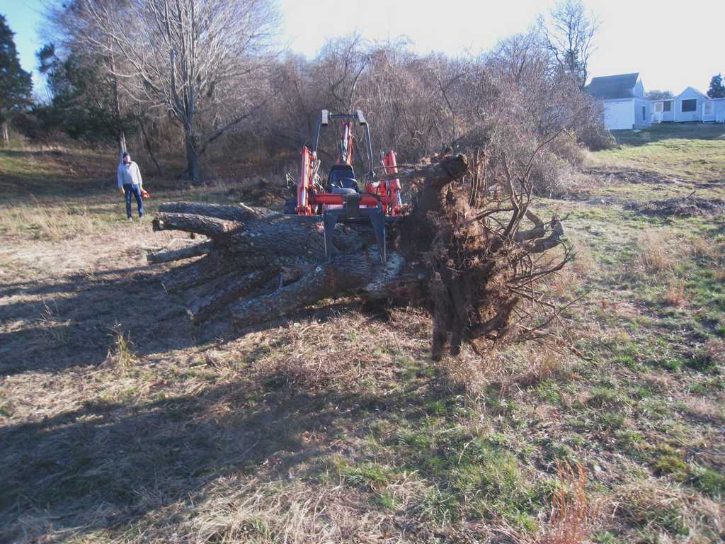

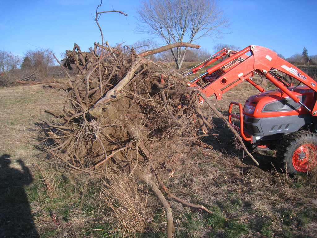

Update on my tree removal project with the MIE Ripper: I've made significant progress in the last couple of tractor days. All the larger trees I wanted to take down are down. Most of the smaller trees are down and stacked too. I've been cleaning up some old stumps and even pondering takng the BH off for the winter now that I mostly have just clean up to do.
Practice makes perfect and I've gotten pretty comfortable with the ripper after 100+ trees. I'll try to summarize my "final" technique. For smaller 4-6 inch trees I now cut on both sides then use the BH to push the tree over in stages. If I can get it to lean then without moving the tractor I can get the ripper in behind where the upright trunk was and usually just pop the tree out with help from gravity. Those are satisfying as I don't need to move the tractor.
Larger trees 7-20 inches or so I now try to cut a V shaped area with my BH at the bottom of the V. I can then just "plunge cut" the area directly in front of the tree and disrupt the roots on three sides before needing to move the tractor to reposition. Sometimes that is all it takes as I usually try to push it over with the grapple/FEL while getting ready to reposition the backhoe to cut the final side. I've gotten braver and when working on windless days am not worried about cutting all four sides as none of the big trees have ever budged until I pushed.
Here is a photo of the stump of the single largest tree removed with the ripper. Had to saw it up after dropping it as it was too heavy to move. I could barely lift the stump/trunk after cutting all the branches off.

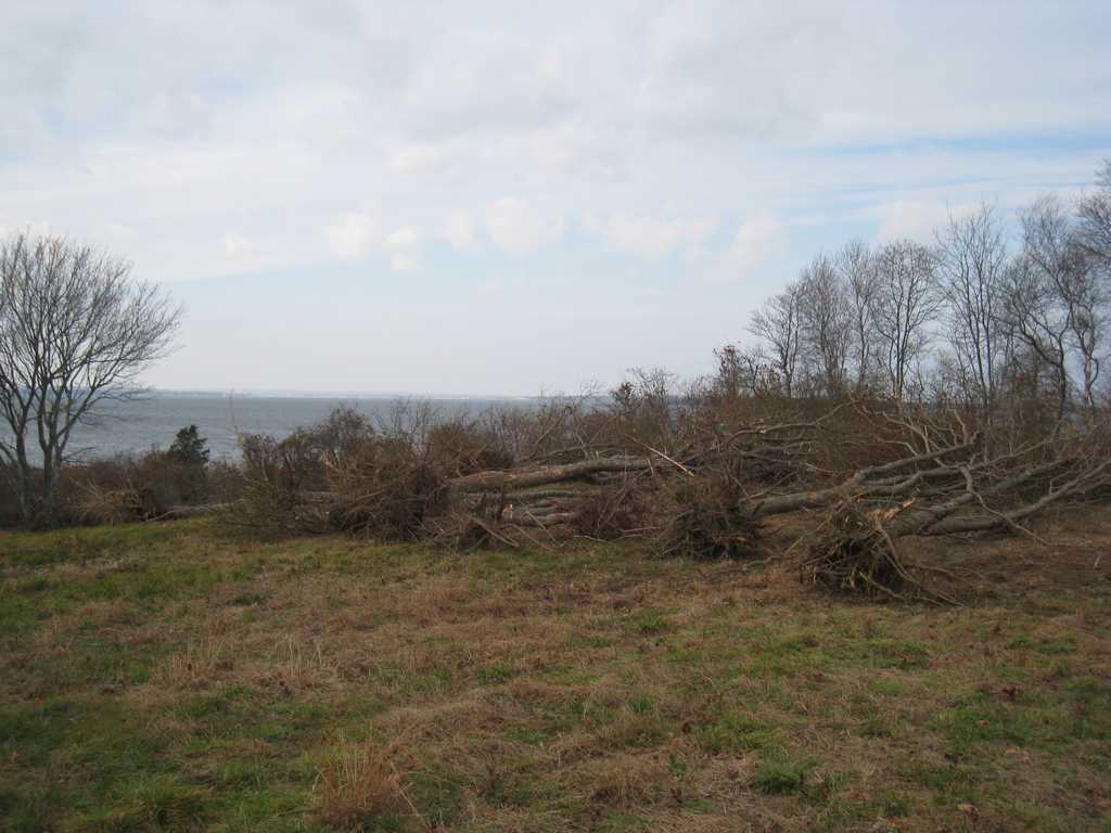

Also have a few photos of downed trees waiting their turn for chainsawing into firewood.
