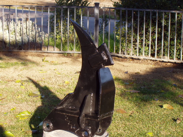

Since IslandTractor started this thread when he and Michigan Iron Equipment came together to produce their first backhoe ripper tooth, I find it ony fitting to add my MIE ripper tooth modification to this thread.

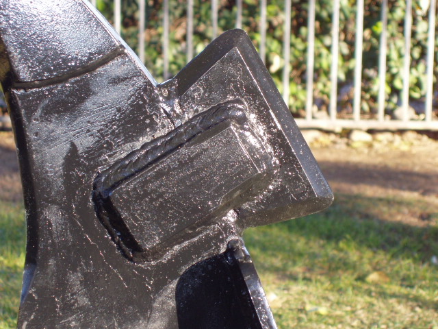

I used the tooth several times this past summer on a lot of small to medium stuff with the removal of several larger oak trees coming up this next spring/summer. Seeing several large exposed roots on these trees made me also think about adding a knife blade to the rear of the tooth just in case a couple of swipes might be needed rather that unnecessarily jacking the TC-40 around trying to do the same without it.
I took an eighteen week adult ed welding class and have just finished it up-one project was the ripper tooth knife blade. The blade itself is 3/4" thick and the two ears are 1/2" thick both welded with 7018-1 rod. My instructor further showed me how to anneal the blade through heating, adding carbon and quench water cooling to temper.
Re-painted and put up for the next tree removal.

Nickel Plate, that looks great. Have you used it yet?
I have not posted a followup on my own similar, but much less elegant, modification. I welded short pieces of drill tube both front and back. I haven't had a chance to use it yet.
Your knife edge is better and the ability to hook the root so it can it slide off is IMO an important element. That allows both slicing and ripping.

No, I haven't used it yet-just finished the welding and paint last week. That part was easy, the design, cutting and shaping of the blade and ears took the most time. I also thought of adding a blade to the front of the ripper tooth but my Woods BH90-X has a hydraulic thumb and therefore possible interference between the two. I'll take a closer look in the spring.
