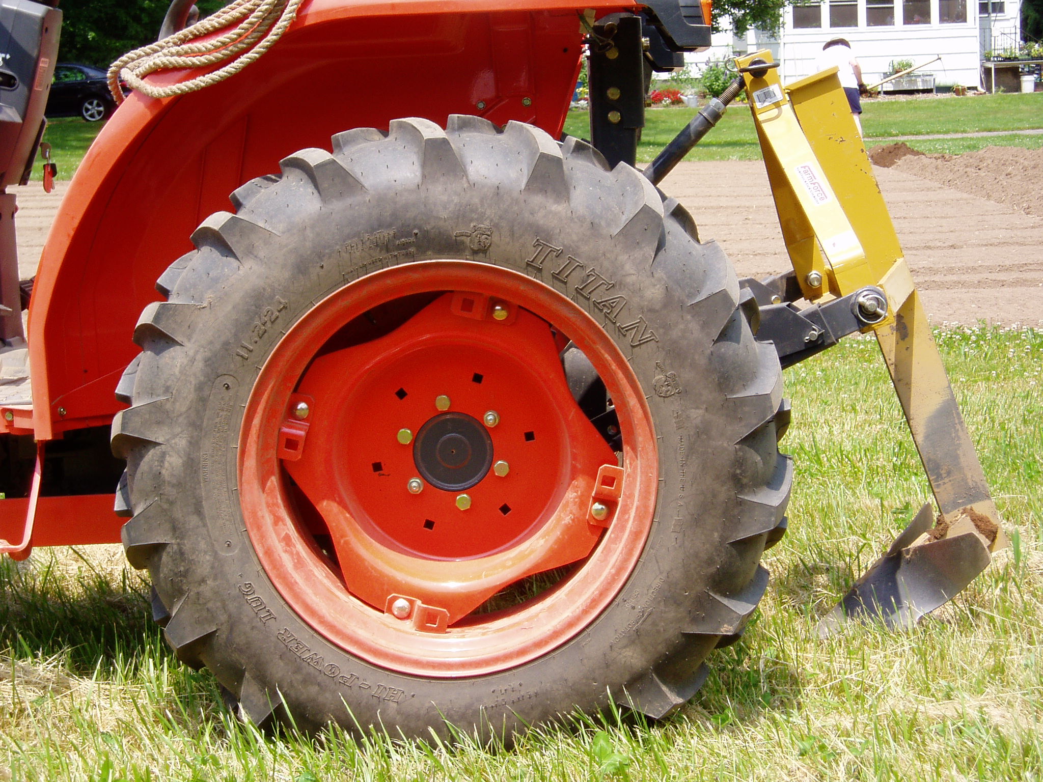

Hm.. I am not exactly the worlds best welder, but I don't think that was a very good weld to begin with..Um. I believe I could do better. of course if it had held, it would not have helped the bending of the main angle beam. Looks like your tractor had some good traction!
James K0UA
   / Added a Subsoiler to my collection
#12
James K0UA
Yea the weld had no penetration, I would have brought it back to the seller. The angle iron bent because the support plate failed. That is a manufacturing defect.
   / Added a Subsoiler to my collection #13
Wow that sucks, That was the wrong weld to let go. What did you hook with it & how big is your tractor
I have a Kubota L3130 (32HP HST). I hit a rock and it did not stop my tractor. I was only going 1-2 MPH.
   / Added a Subsoiler to my collection #14
Well if it was mine (and I couldn't get my money back or a replacement) I would get out the torch, anvil and 2 lb hammer, and start heating and beating, grind and weld that nasty looking excuse for a weld, and repaint in some pleasing color.. and oh, I would not worry about over-painting the brand name either. That is what I would do.

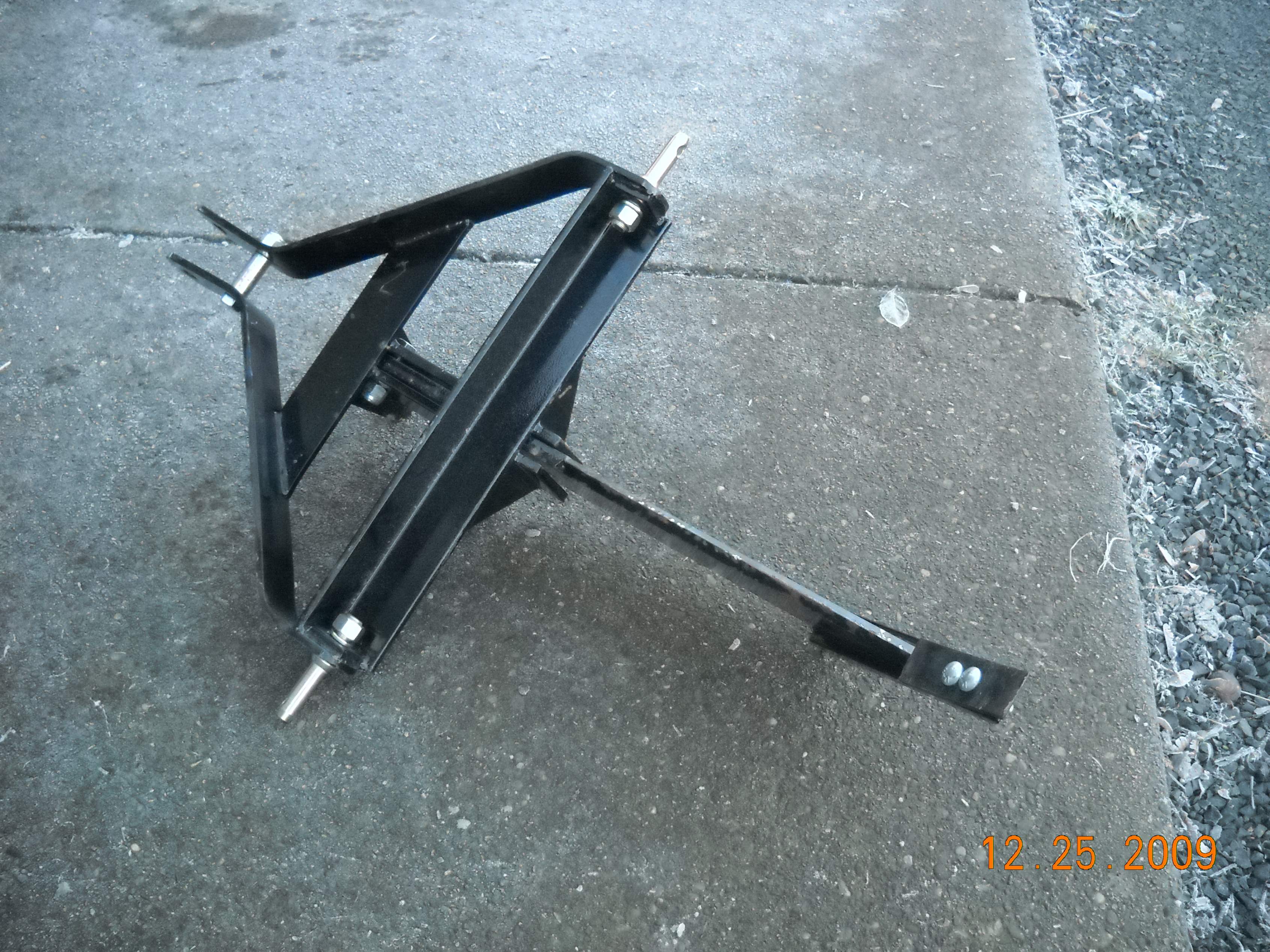

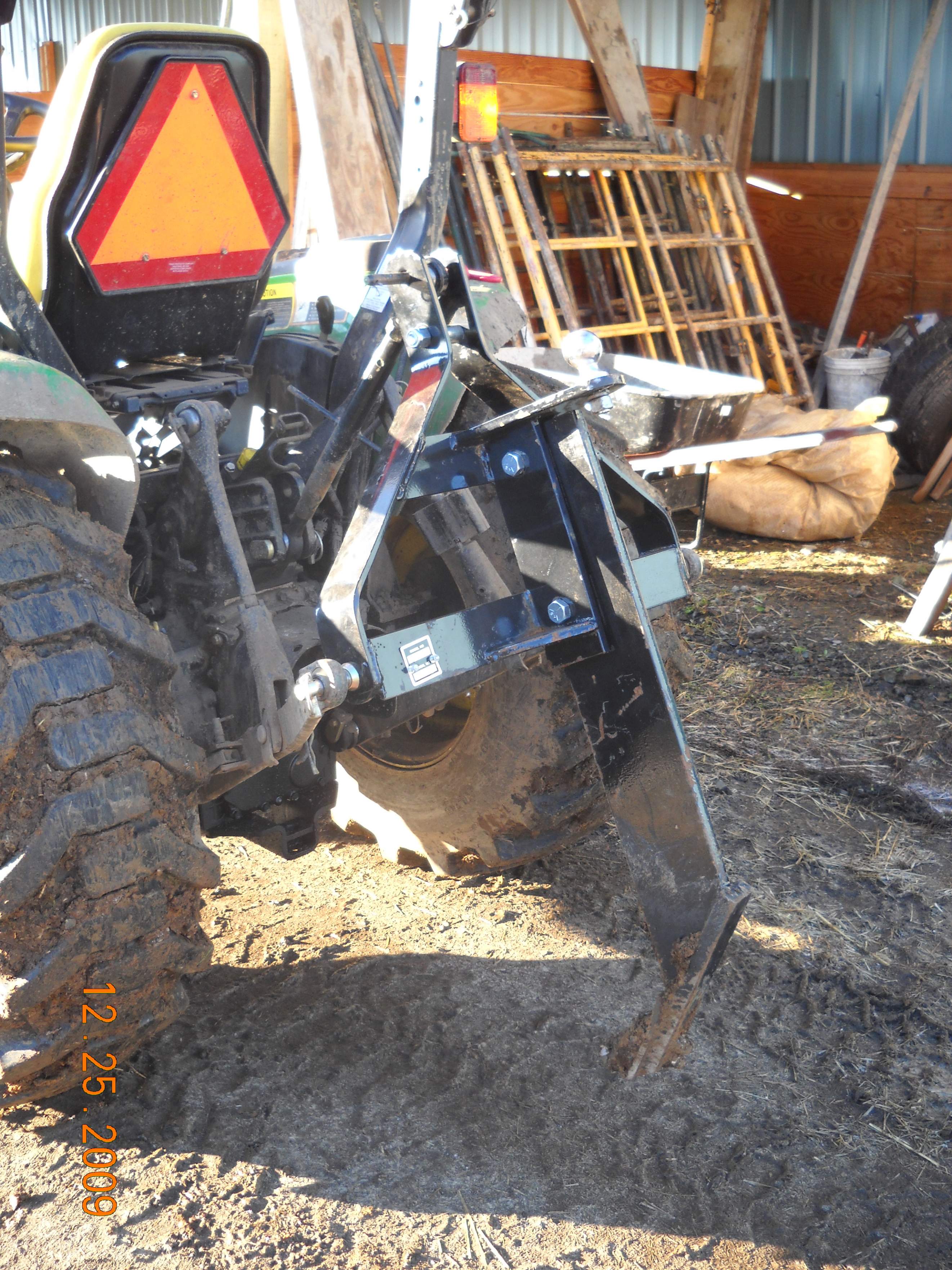

   / Added a Subsoiler to my collection #16
I have a General Implements middle buster/subsoiler/trailer mover and it is one tough attachment. My dad's 3720 gets it about 3-4" off the ground with the top link shortened all the way and it mounted on the bottom hole on the tractor. I really like the ability to simply unbolt the tooth and be able to pull trailers around, that comes in handy quite a bit. :thumbsup: I have dug ditches with mine and it does a pretty good job, watch out for rocks though! Mine is built so heavy that it just stops the 3720 in its tracks and i have to pick it up and move so i can pull it again. :confused2:

   / Added a Subsoiler to my collection #17
That looks like the unit I saw at a local dealer that has a shear bolt. It was $200 which is slightly higher than the not protected ones sold at TSC and KK.
