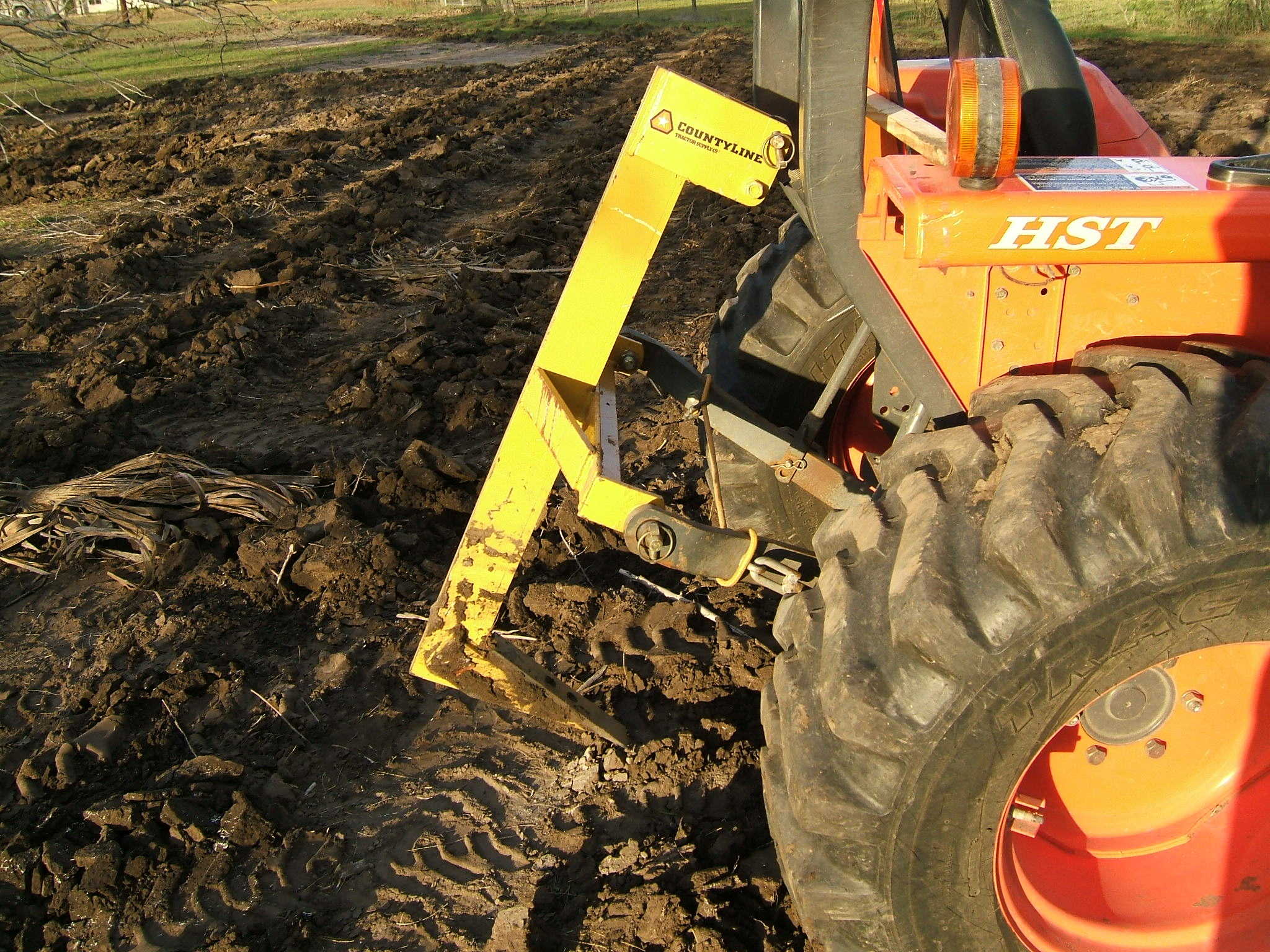

On second look, the plow I got from TSC is built differently from either of the two shown damaged in this thread - and differently built also from the pic in TSC's web catalog.
The main vertical member measures 1x4 inches.
It is, after all, a Class 1 hitch item. Hooked to a Class 2 hitch tractor, well .......
http://www.tractorbynet.com/forums/attachment.php?attachmentid=246640&stc=1&d=1326669449
Have had favorable results carefully passing close to some of the mesquite stumps I left at ground level when I first cleared the place 6 or 8 years back; breaking the roots with the subsoil plow and then harrying the stumps out with the corner of the FEL. (Might put the tooth bar back on the FEL for more of this work).
The worst part? I hooked a PVC water line - TWICE, doggone it! Not one I installed, but should have remembered about.
-shu
-shu
Yes that is different then what I had - It looks like the King Kutter version that everythingattachments sells.

I have one of these Countyline subsoilers in perfect condition after two years of ownership.;) Probably the reason it is still like new is because I am reluctant to use it, been leaning against a tree for two years now.:laughing:
If you need a subsoiler I recommend you spend more and get a good one, this thing is a waste of $160.
