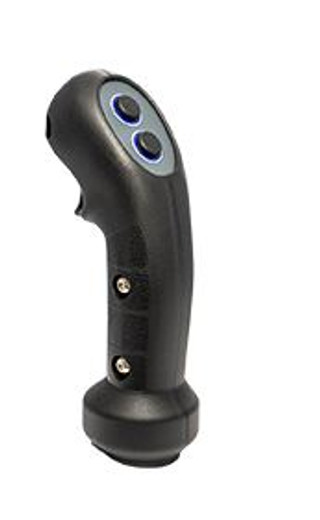

What I don't get Ken is why you didn't go for one of those groovey multi function handles ;-)

I was wondering if the switch on your Eight Ball is a toggle, or if you need to keep it pressed down to change what the joystick operates...

i had extra toggles but i decided it was better for me to have a momentary on switch instead of an on/off switch so I went out and got one.

If anyone feels like spending money, Bailey's has a nice control handle with 3 switches.
