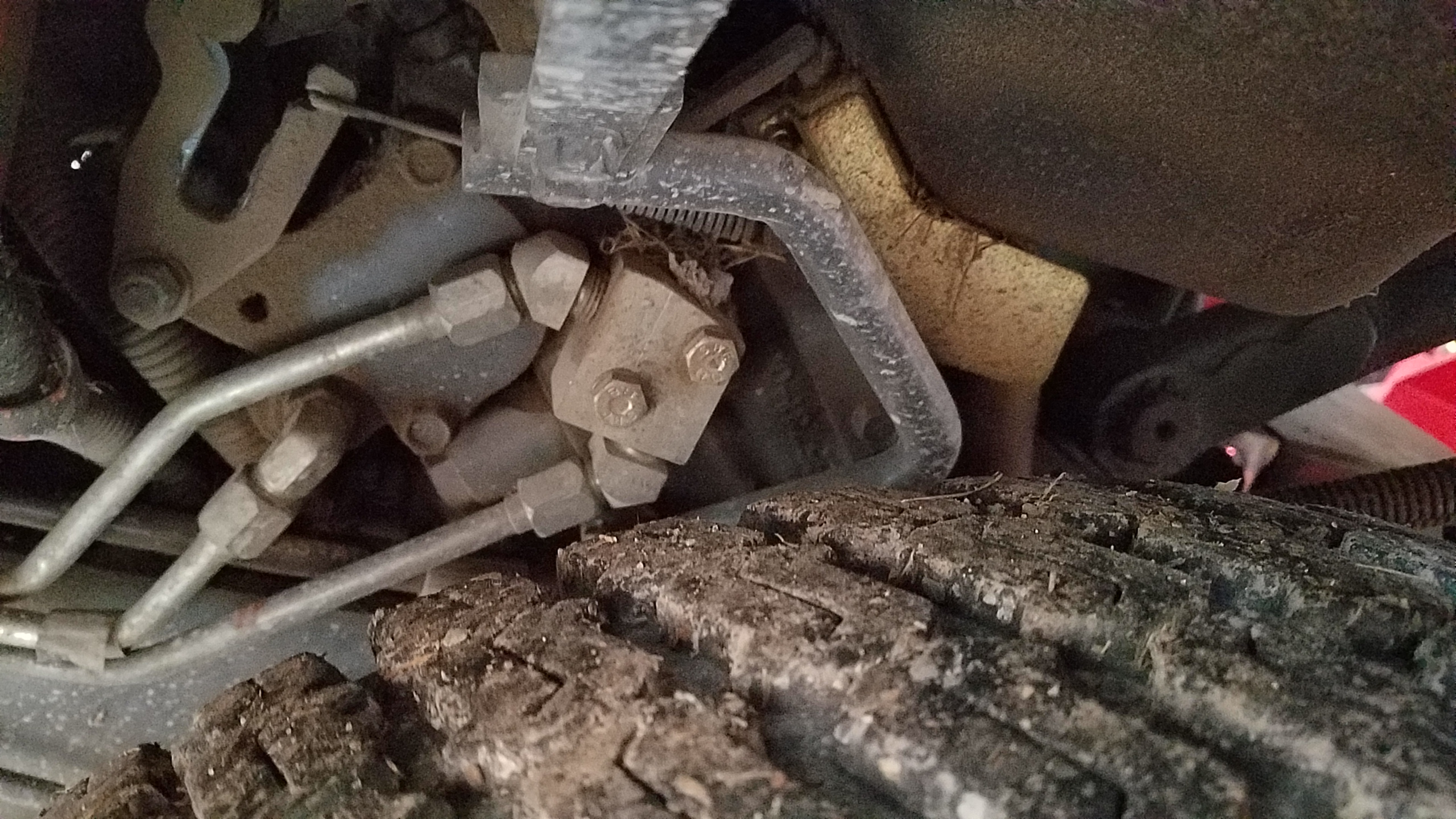

The old posts stays alive. Been a long time lurker/learner.. now I have a question and need some guidance please!
I am trying to add a rear remote to my BX2200 (2001) w/ LA211 loader. Primary use: hydraulic top link.
I located a BX7322 Kit. Have that in hand. I took the parts list from this thread (pg1) and located all the parts (not yet in hand).
What I can not tell.. mainly because the BX7322 kit has a valve with 5 ports (includes a power-beyond port?), yet, the Ref:01J210 "hose kit" parts list has no power-beyond return to reservoir plumbing for the rear remote that I can tell. So:
a) do I need power-beyond capabilities for the rear remote at all? Ie. to use the BX7322 valve, I have to plug the PB port?
b) will a simple single spool (even a log-splitter open-center type valve work) .. ie. can I return the BX7322 kit since it was $3-4x what a single spool OC valve costs?
c) To use the FEL, does the rear OC valve remote need be plumbed in permanently, or does the pressure/return from the "hose kit" need looped? Or is "E" in the WSM pg 244, the Power-beyond port (described as "From Implement", the FEL in my case), and it does not need looped if there is no valve/rear implement connected?
Thanks in advance for a guiding hand!
Screen Shot 2019-03-26 at 4.13.54 PM.png20190319_155952.jpg20190326_161108.jpg20190326_161129.jpg
   / Added rear hydraulics to BX2200 #30
Generally...the PB port on the old valve will go to the pressure port on the new valve and the PB port on the new valve will be plumbed to where the old PB port went (usually 3PH)... the return or tank line can be 'Tee'd into the return line on the old valve...
There should be no need for any loop if the remotes are not being used...
