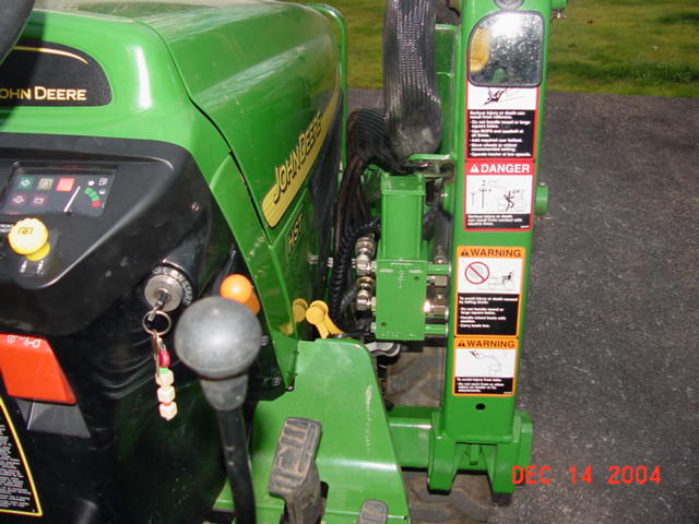

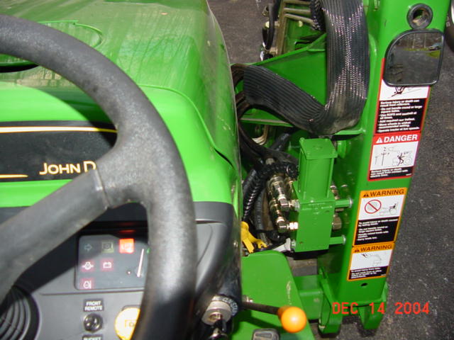

You are right, not much room on there, I forgot that the Kubotas have the loader valve on the mast.
My Suggestion: Get the valve and start playing with it.
Do you have a hydraulic shop near you that sells fittings and hoses? This helped me alot!
As far as mounting, Since you can't get to the insinde of that loader arm to put nuts on, I think I would suggest welding a bracket to the arm to hold the valve.

Yes Kenny, I do have access to hydraulic supplies and I like your bracket idea and I think that's the only way to go.
Thanks for your help

I have owned, the FEL valves already had PB and were up on the loader
mast. The JDs I have owned had their FEL valves under the seat and so a
lot more hose was needed to get up to the FEL bucket. The PB plugs for the
JDs were only a couple of dollars, so that aspect did not significantly cost
more.

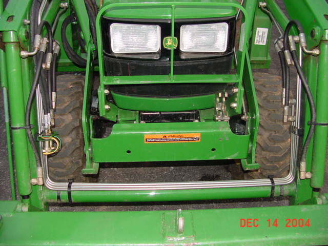

My own goal in such a front AUX connection was to eliminate ALL extra
plumbing along the FEL arms, so I chose a solenoid valve mounted up near
the FEL bucket.
