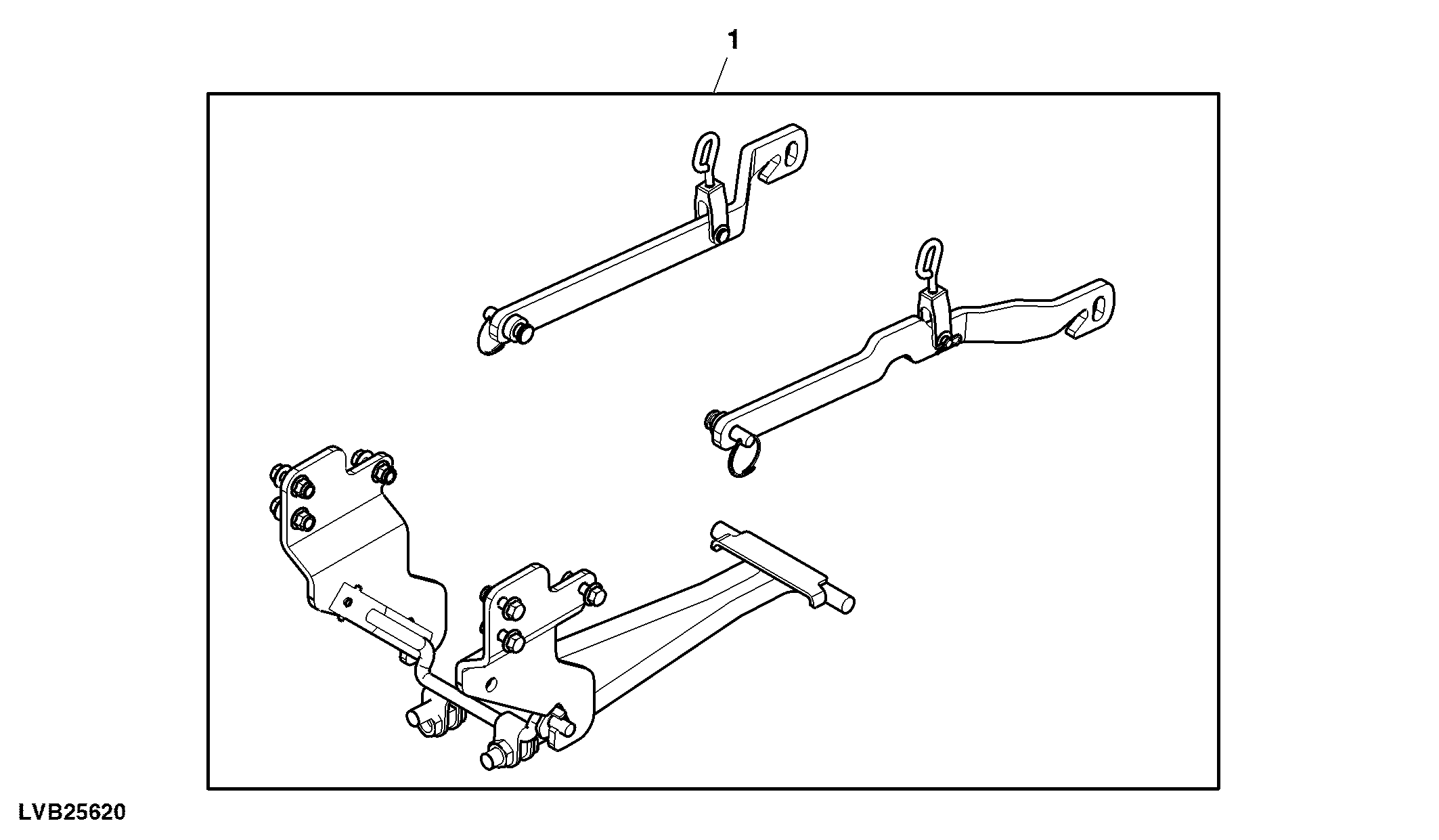

You'll also need this for attaching the front of the mower deck to the 2320. Front draft arms.
I may be mistaken but I believe that the front draft link which is also listed separately is included with the LVB25620 kit. This photo shows the entire kit:
   / Adding 62D mower to a 2320 advice needed please.
#12
This picture with the LVB25620 part number is very helpful, Thank You, I was wondering where that part number came into play.

There's a member on GTT that has a LVB25620 2320 Mower attaching parts kit for sale. It's new and unused and you'll need it if you pick up a 62D1 for your new 2320. He also has the LVB25630 Independent Lift Kit which would nice a nice option as well.
Do you know if its still available? I searched and couldn't find it.
   / Adding 62D mower to a 2320 advice needed please. #19
Yes. It's still posted in the Swap Meet Forums under "For Sale" on GTT / Green Tractor Talk. I believe you need to be a member to see it though.
Frank
   / Adding 62D mower to a 2320 advice needed please. #20
Frank
Thanks, I pm the guy this morning. I mistakenly bought a 62d2 version with all the attaching hardware. I hoping if I buy this kit I can see what I need to convert the deck over to a 62d1 version
