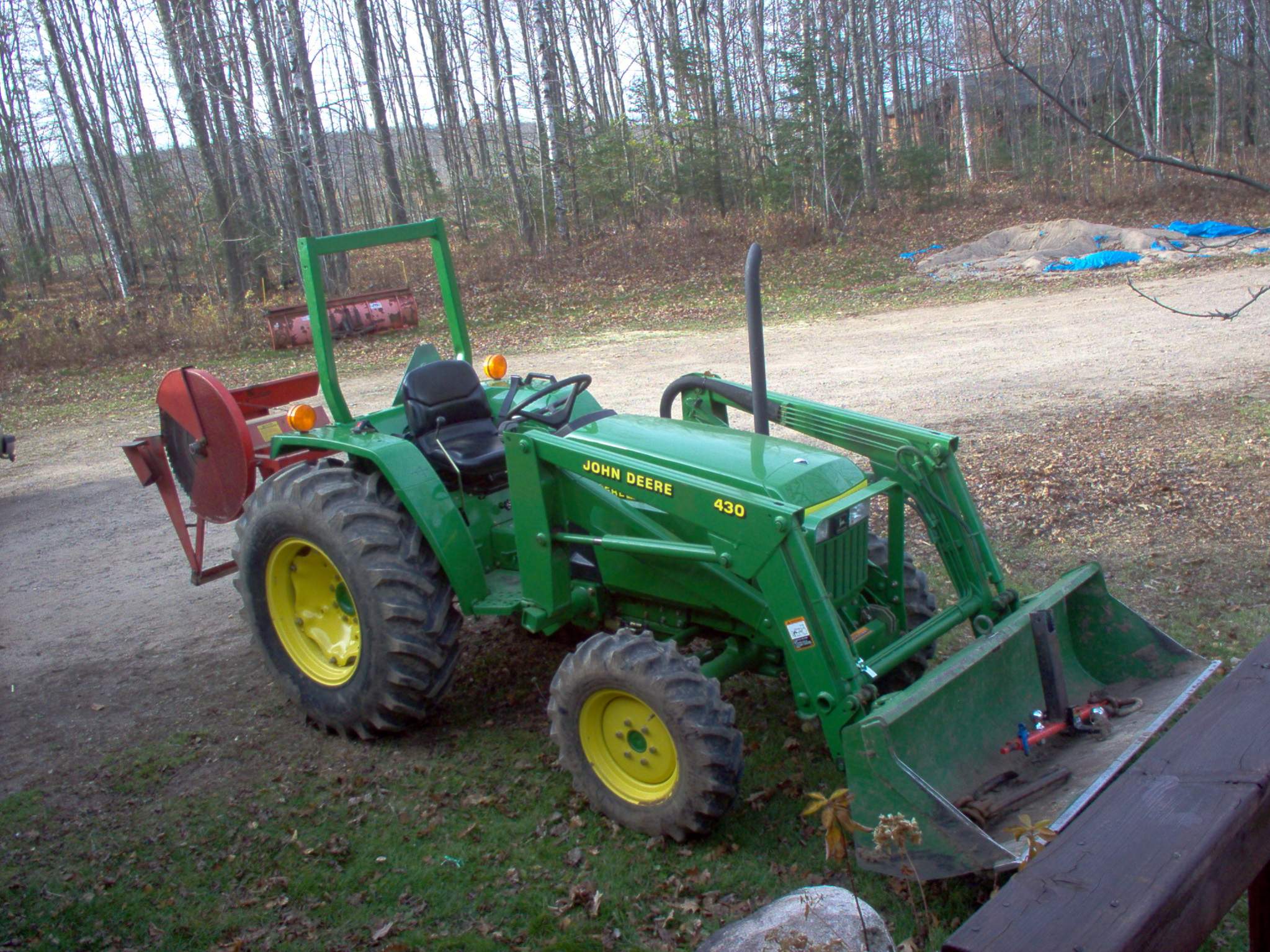

I cant get the part for a 430 loader! Darn dealer had be all excited for a while then they let me down. Kenny now I really need help!

I put the 3rd valve on my 4300 last year relitive easy if you have 4 hours and a brother in law who use to be a John Deere on the road mechanic. When I was looking for the part other dealers could not find it butmy regular dealer, ( Shaws Ridge in Dover NH ) found it he said that John Deere changed the part number. If I remember the right the numbers were the same but they added letters to the beginning, I think Q might have been one.

i don't remember what i paid, but $255 sounds cheap! i swapped out the joystick on my tc40da for one w/ 4 buttons.. 2 buttons for open/close on my grapple and 2 for my turtle/rabbit function.. my kit had the joystick, hoses/couplings, diverter valve, and electric solenoid valve.. not hard to install, but the little plate for the fittings on the front was my first welding job! :eek: ... now if i can get a GRINDER in there!
