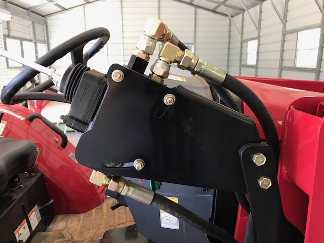

Seems there is a factory kit and aftermarket. Is the factory kit easier to install compared to say a WR Long kit? I'm a car mechanic but don't have experience with tractors and hydraulics. I "get it" with an overview of what needs to be done but that's just from my underexperienced point of view. Is it a big deal to add it? Any and all comments/suggestions welcome.

The WR Long kit is a true third function- it allows lift, curl and the third function at once. The Mahindra kit is a diverter that diverts from curl to the third function when an electric button is pushed. The diverter style is available from several sources for far less than Mahindra. The diverter is seen as the easy way to do it but looses some function. I personally have a true third function (WR Long style) and wouldn't be without it.
If you are a mechanic I'd recommend buying the valve and FEL control grip with the needed switch. Then have the hoses needed made. It will take the price from about $1000 to well under $500. Say an hour of research and an hour to have hoses made. You are still ahead.

Your loader control valve will have a "power beyond port" that is full hydraulic pressure (regulated pressure used for FEL). You would go out of that and into an electric valve. Out of the electric valve and up to your third function. From third function and back into hydraulic tank.
Use the Scorpion electric grip switch and an electric valve from a reputable source.
