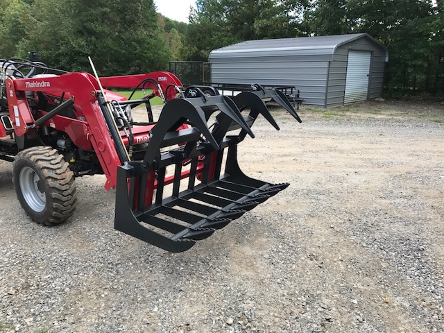

Got the right connectors. The hydraulics shop says they are called PCN6 connectors.
The WR Long kit install was easy for anyone considering it. I ran the power from the keyed power supply off the ignition switch. Everything works as expected. Not sure what this grapple weighs but it is certainly heavy and heavy duty. Will report back more once I spend some time moving those piles from my other thread!

Yes I think they use a different name in Salisbury but that's them. This is the 60" version.

Ya he sells the 60 and the 72 for the same money. That 72 would be way too heavy in my opinion. You feel it with this 60" on.
