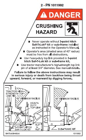

Regardless what that hoe is on, I don't like the outriggers at all.
Try filling the bucket, then swing to the left or right and extend the boom with that bucket full of material. Or try digging and filling the bucket in that position.
A backhoe of this size puts a tremendous amount of stress on whatever it's attached to. I'm guessing this hoe will drag the splitter around with no hesitation. Will probably do the same to your tractor. Make sure you have some means of locking the wheel brakes on the tractor with it in 4wd. Don't depend on a "park" transmission lock to hold the tractor.

If itエs only for occasional lightweight work, go ahead and adapt the backhoe to your three point hitch however you can. Be gentle and careful with it, though. I broke a 24hp Kubota b7610 in half with a backhoe that was designed for it. Of course, I was abusing it. But it can happen to you! Hope it doesnエt, but keep it in mind.
I put the back feet down and it closed the gaping crack in the center frame. Welded it up and sold it cheap(er) to a friend that knew about it. Used the cash to buy an old deere 310d construction backhoe. That thingエs awesome! but now Iエve got to pay a lot to fix it up cuz itエs been abused too. But if you want to do a lot of digging consider changing out machines

Grandad4 you are right. I did dig a hole with the unit mounted as shown,lots of rocks really pushed it . I did get the job done, but I bent the top link. I have since fabbed a anchor point for those two top mounting points. Now It's plenty strong on the splitter. Not sure If I can figure a way to add those mounting points to the tractor.
Take a look at what Woods sells for their "3point saf-t-lock" kit

Could you expand on this tale? I've a B7610 w/ a Woods BH70X w/ subframe.
