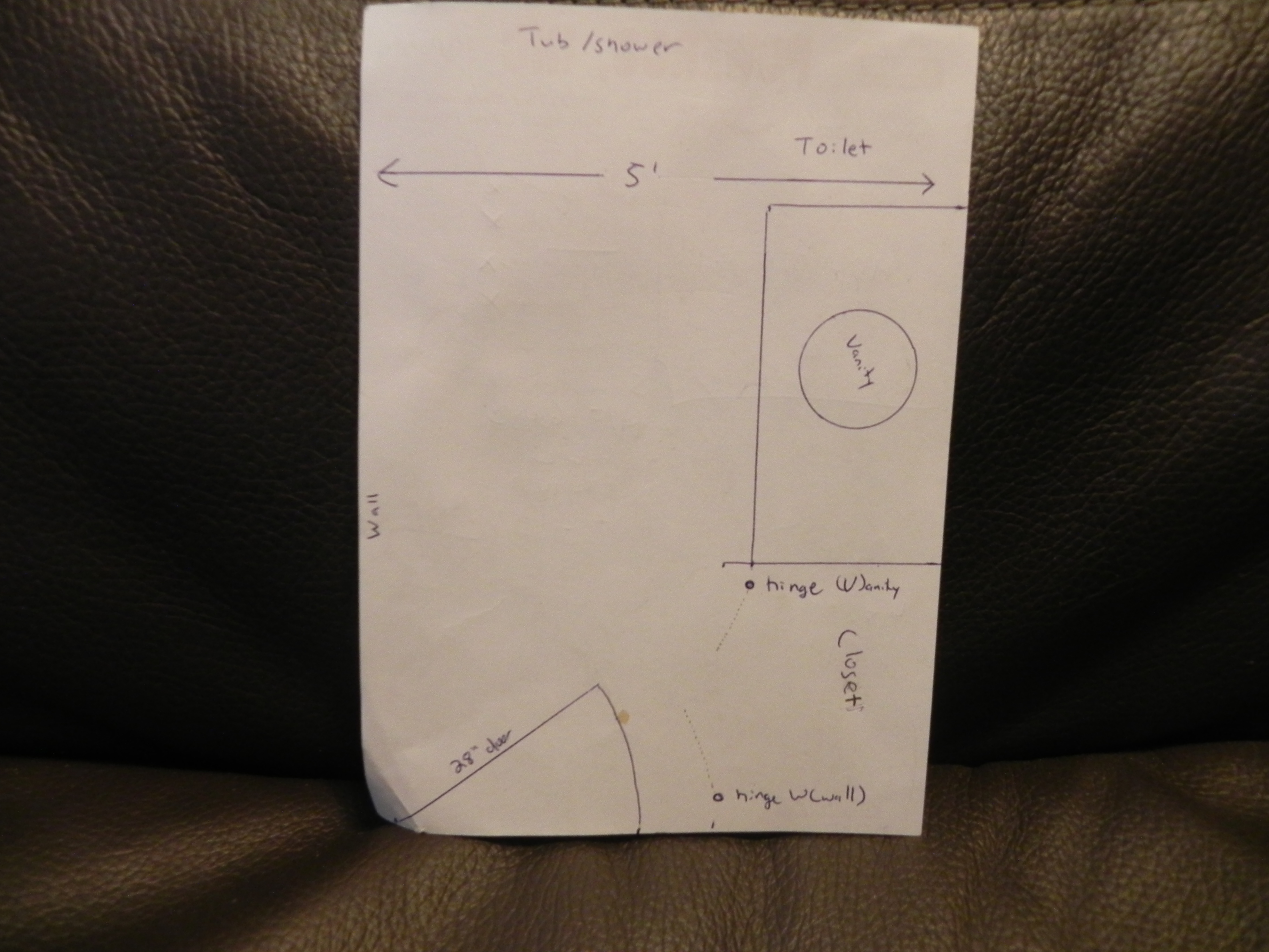

My house has no pantry and only one non-bedroom closest, so storage space is inconvenient and cramped. I planning on removing a 66" long vanity from guest/non master bath, and installing 36" vanity, and using the rest as closet. Cant seem to decide where to put the hinge/ which way the door should open. Not interested in folding/bi folding doors, slider not possible. (Digital) penny for your thoughts?
Hopefully you can get a general idea from my rough, mostly to scale sketch. 'V' for hinge near vanity, or 'W' for near wall. The new closet door would likely be about 24", so it would hit the main bath door if trying to open both at same time, but if main door already open, no issues...
Definately the wall. Checked w/ the Mrs and she said the wall also. She said if your in the bath, the main door would be closed, you forgot to get a towel, you can open the closet towards the closed main door much easier than grabbing the door knob close to the wall, stepping back in order to open the closet.

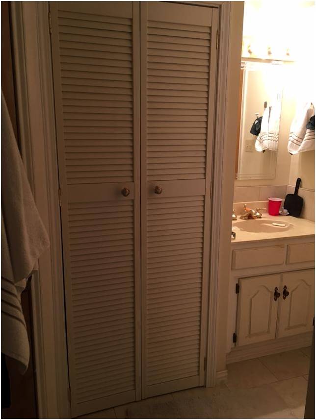

I did almost exactly what you are planning to do. I also did not like a bi-fold solution so I went to Home Depot and bought a bi-fold door and an additional 3 hinges. I separated the halves of the bi-fold and mounted each half separately. See pic.
Very good.

Two of our bathrooms have closets in similar locations, and both have closet door hinges on the wall side. For normal use it provides the best access to the closet and is only an issue if someone tries to open the bathroom door while 1) someone else is in there and has the door closed, and 2) the person in the bathroom has the closet door more than halfway open. If doing mine again, I would do the same as it is now.
