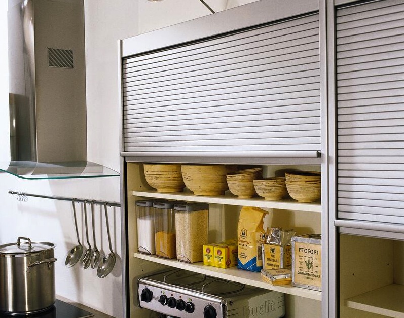

Would some type of roll-up door work?
Mesmerizing-Wood-Roll-Up-Cabinet-Doors-23-On-Home-Wallpaper-with-Wood-Roll-Up-Cabinet-Doors.jpg
Other ideas:
roll up closet door | Roselawnlutheran
