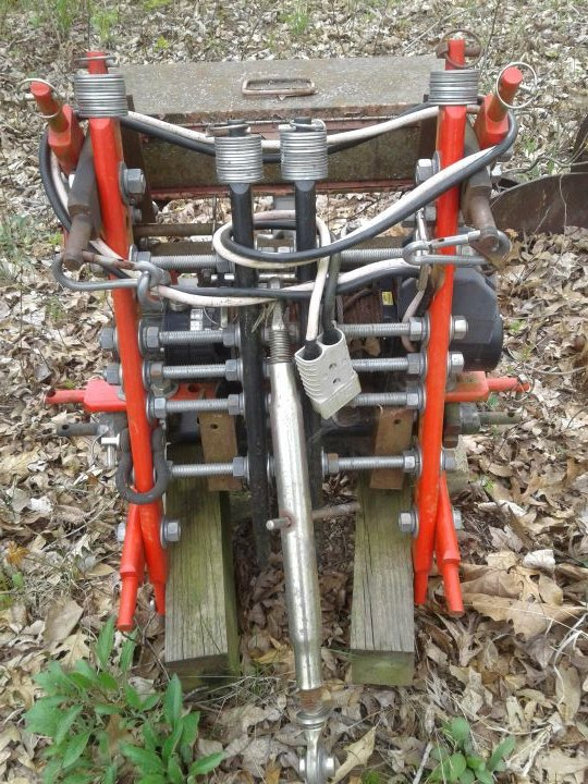

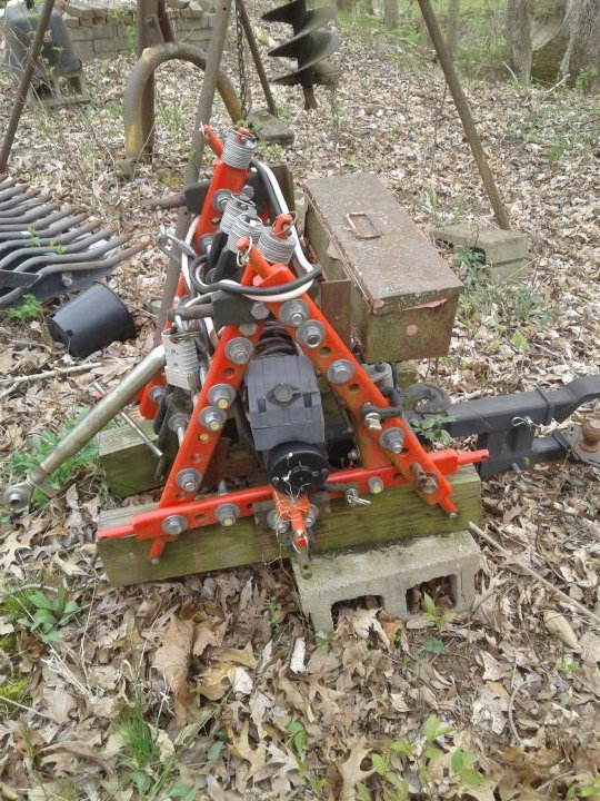

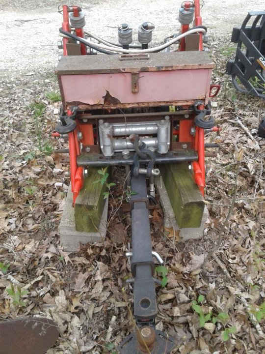

I don’t understand what you’ve got going with the second winch, maybe some more pictures and explication? Bonus points for using a real plug though.

That’s about the craziest contraption I’ve ever seen. You have some interesting engineering ideas.

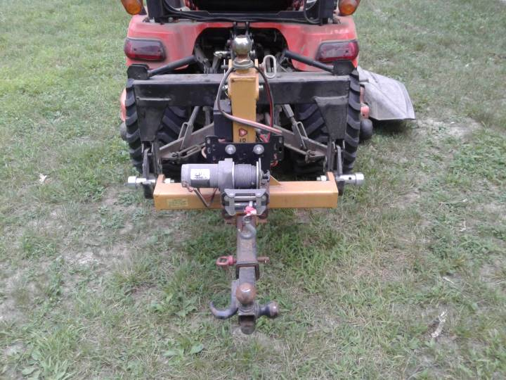

The other option that no one is mentioning is to mount the winch low on a 3point hitch trailer adapter and add a tray to hold a deep cycle battery. I only cut enough wood for firewood and the winch is used very infrequently for hard to get at logs. I have a couple of deep cycle batteries around all the time for my boat and dump trailer. Also the winch is that smallest that HF sells. It works for me.

I had good luck pulling small logs with the HF 12k winch on my Jinma 254 tractor. I found that I would sometimes pull the tractor instead of the load so I mounted the winch on top of my box blade and set the scarfer teeth into the ground. Works great although I'm not logging big wood. I'm clearing red alder only 4-5 at butt. I run a cat-of-nine-tails out and grab onto several cut down trees and winch them in....then drag them to the burn pile.
