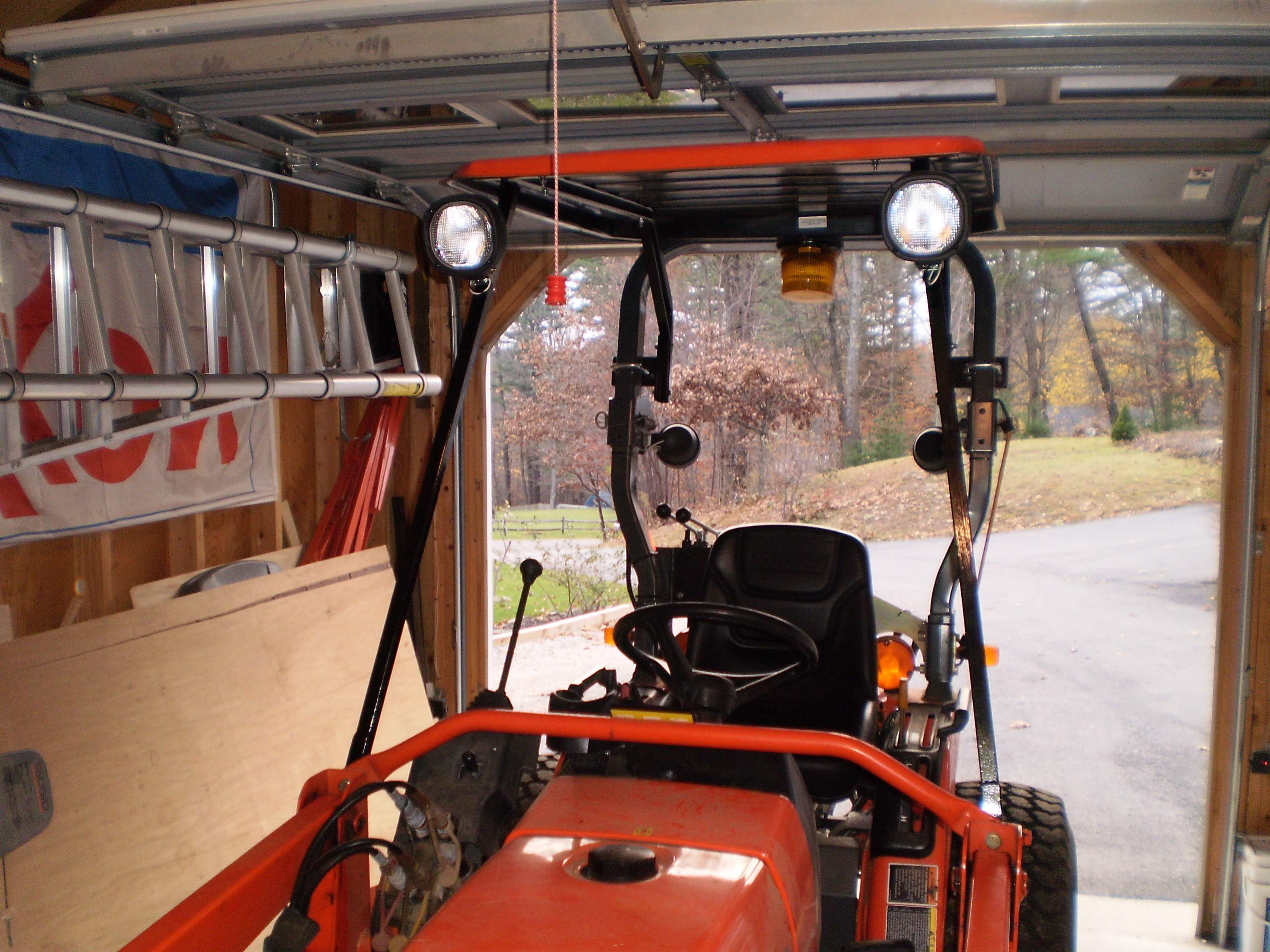

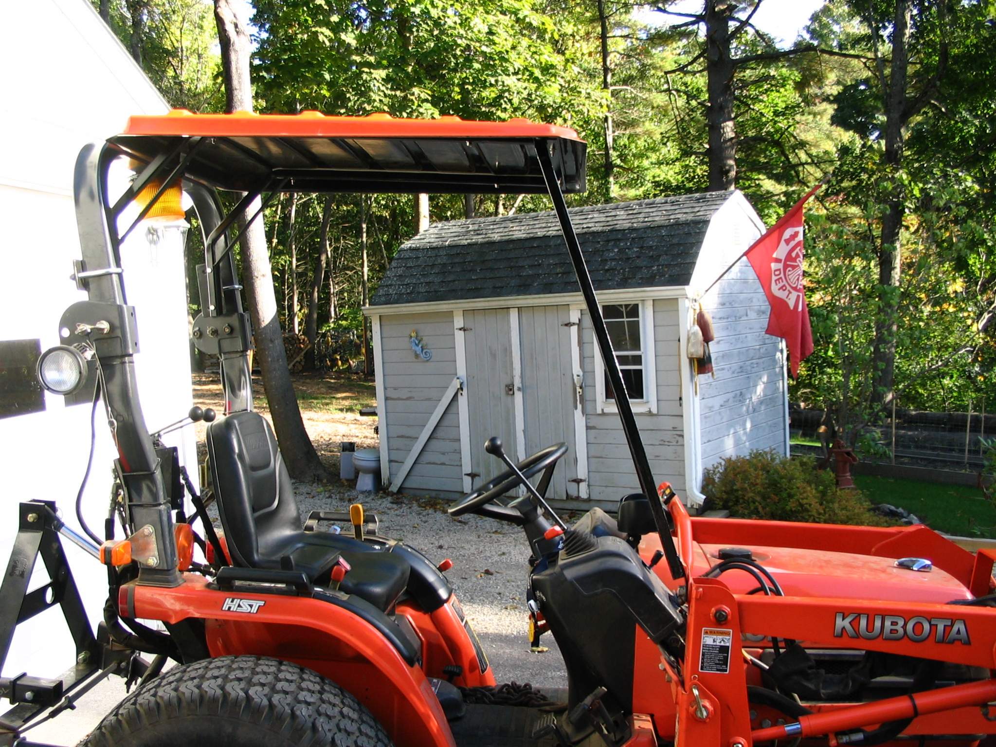

This canopy can be mounted in front of the Rops..
Tractor Canopies | Tractor Canopy Sunshades | Sunguard LLC
Well built for the $$$. Very satisfied w mine...I've knocked off a few trees and yes even the garage..Still holding up fine, No cracks.
But highly recommend lowering the rops...1/4 isn't alot of room....I took 3: off mine...
I added the forward support brackets, for trailering with the canopy still mounted...

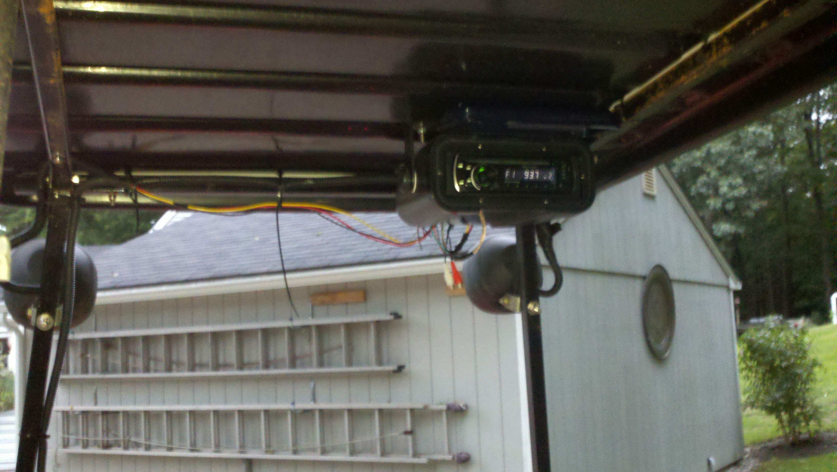

No worries of sagging, but I tow mine and could see how it would fold back if loaded forward , had I not installed the forward braces..,,,Also gives me mounts, for lights and I also installed a marine radio....
I plan to plexiglass or make a clear view window up front and a marine awning surround...All in time...

Firefighter,
That looks like a really nice canopy. I went to their site and was surprised how reasonable the prices are. Always good to get an independent review of how their product performs.
Also, thanks for the picture!
