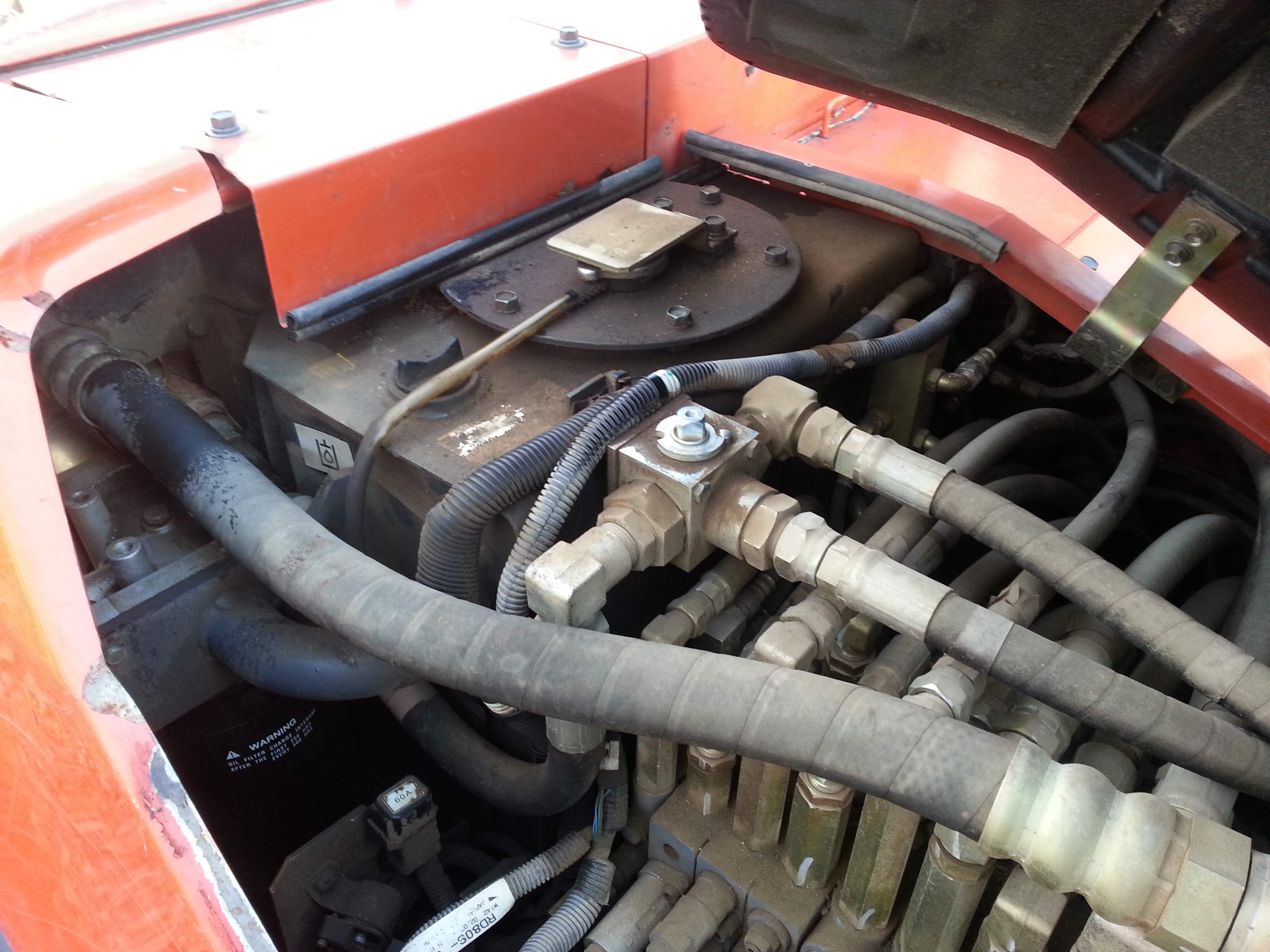

Case drain line needs to have minimum back pressure possible. It is fine to run it through the oil cooler if cooler has no pressure drop acorss it, or less than 5 psi. Case drain should also have a filter in case of motor bearing failure or internal motor failure, to keep the debris from dumping into the reservoir and contaminating the entire hydraulic system. Northern Tool (among others) has 10 micron return fitlers for about $25 which will handle upto 20 GPM. Case drain line normally will only be running about 10% of the pump flow to the motor. So a 20 GPM pump to motor flow will only be around 2 GPM case drain flow. If you don't go through the cooler, dump it into the tank below the fuild level and make sure it is as far away from the suction outlet as possible. Dumping into the suction or close to it can cause a swirl action that could cause areation to oil going into the pump.

Refer to the way your PT100 is plumbed. Heat is the biggest cause of failure in mulching equipment especialy in open loop hydraulics which is what you have. At the end of the day it's your machine and your money your sending, just hope you spend it wisely and once.:thumbsup::)

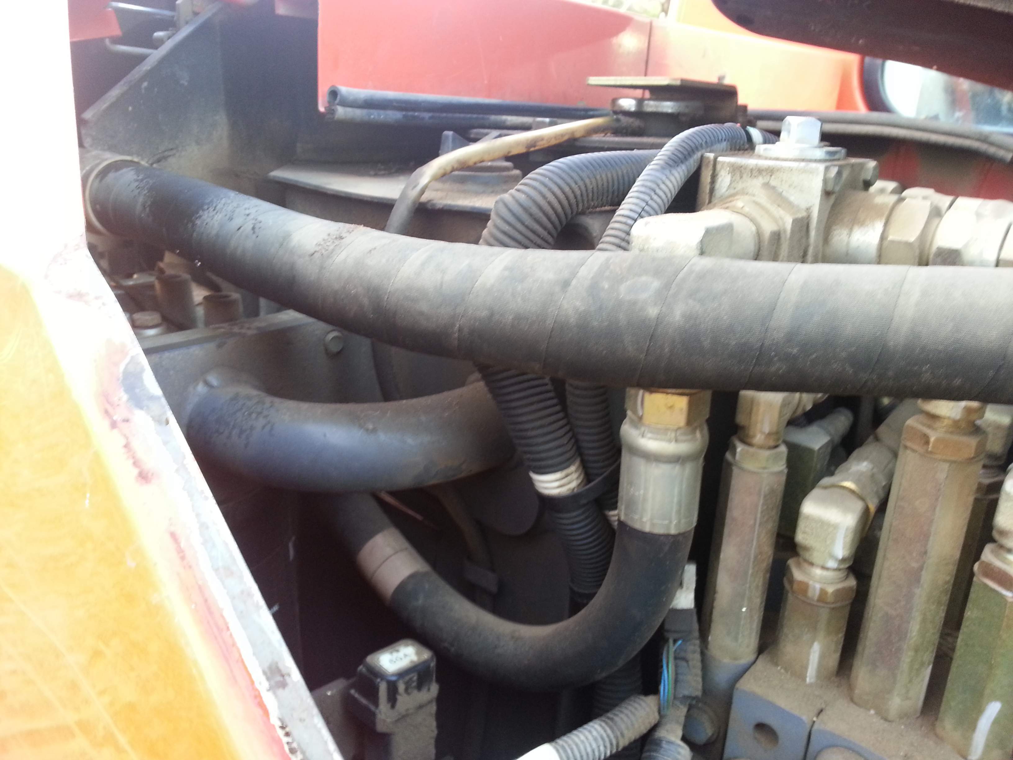

Thanks for the help so far.....here's what I'm working with. Looks like that top access lid may be the way to go. 20121229_152939.jpg20121229_152944.jpg

As SS said , the case drain must be below the fluid level in the tank . Most lines going into the tank below the fluid level are drains , a "TEE" into one of these at the tank works well and eliminates the need for welding and drilling .

It appears my tank is pressurized. Would this affect anything installing the line coming in through the top of the tank but returning below the fluid level?
