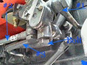

Here is a similar post that we have been discussing about the hyd block.
Kubota L3130 Hydraulic accessory block - Page 2
You need to have the adapter plate on the hyd block that has the threaded ports for supply and PB return.
In the picture, #1 is input to the hyd block from the pump supply.
#2 PB out
#3 off the back of the hyd block is return to tank.
Hex bolt on bottom covers the relief valve.
The plate with the three bolts is a cover plate and you replace that with a plate with threaded ports, and this is your pressure and PB return line.

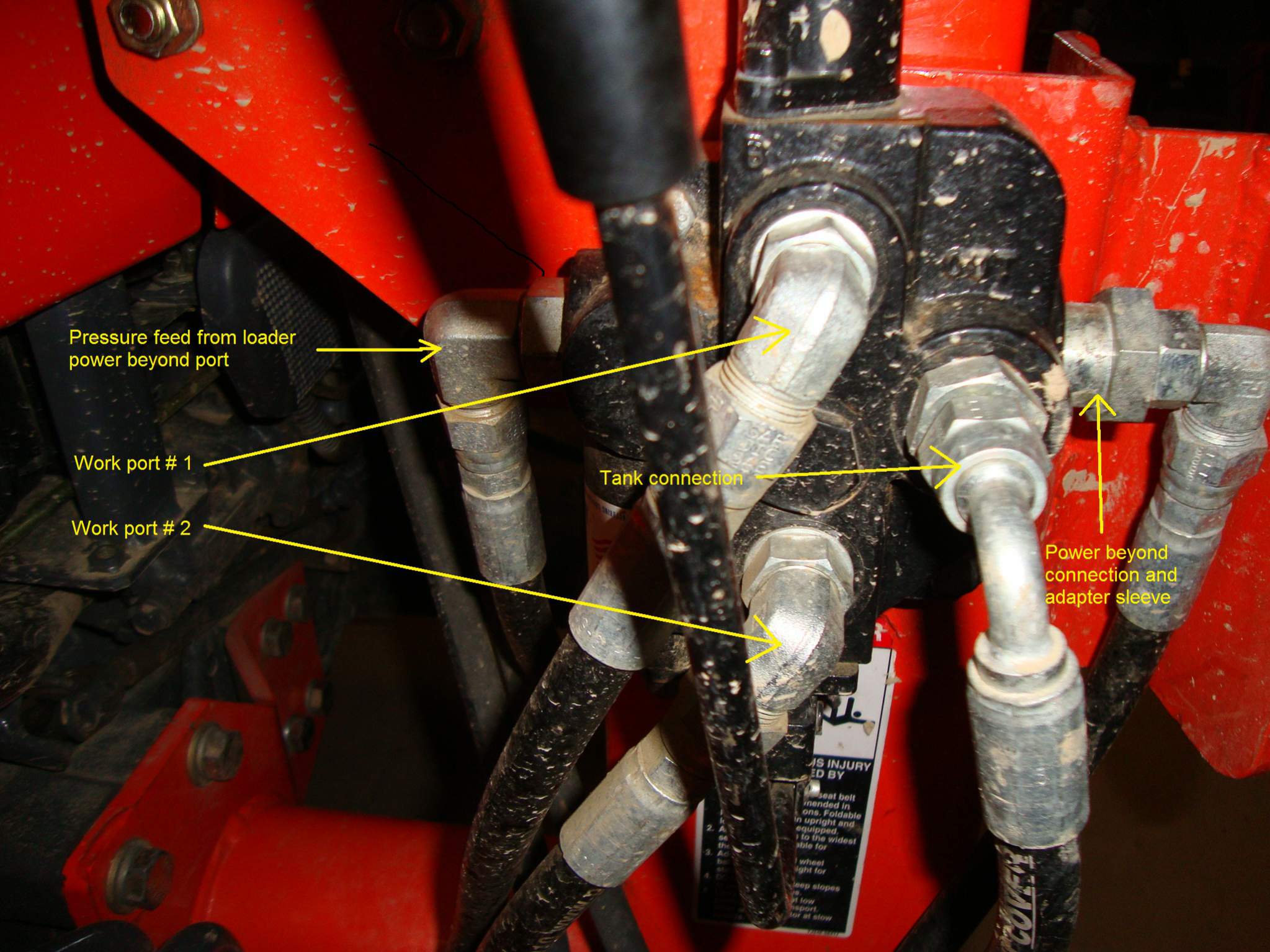

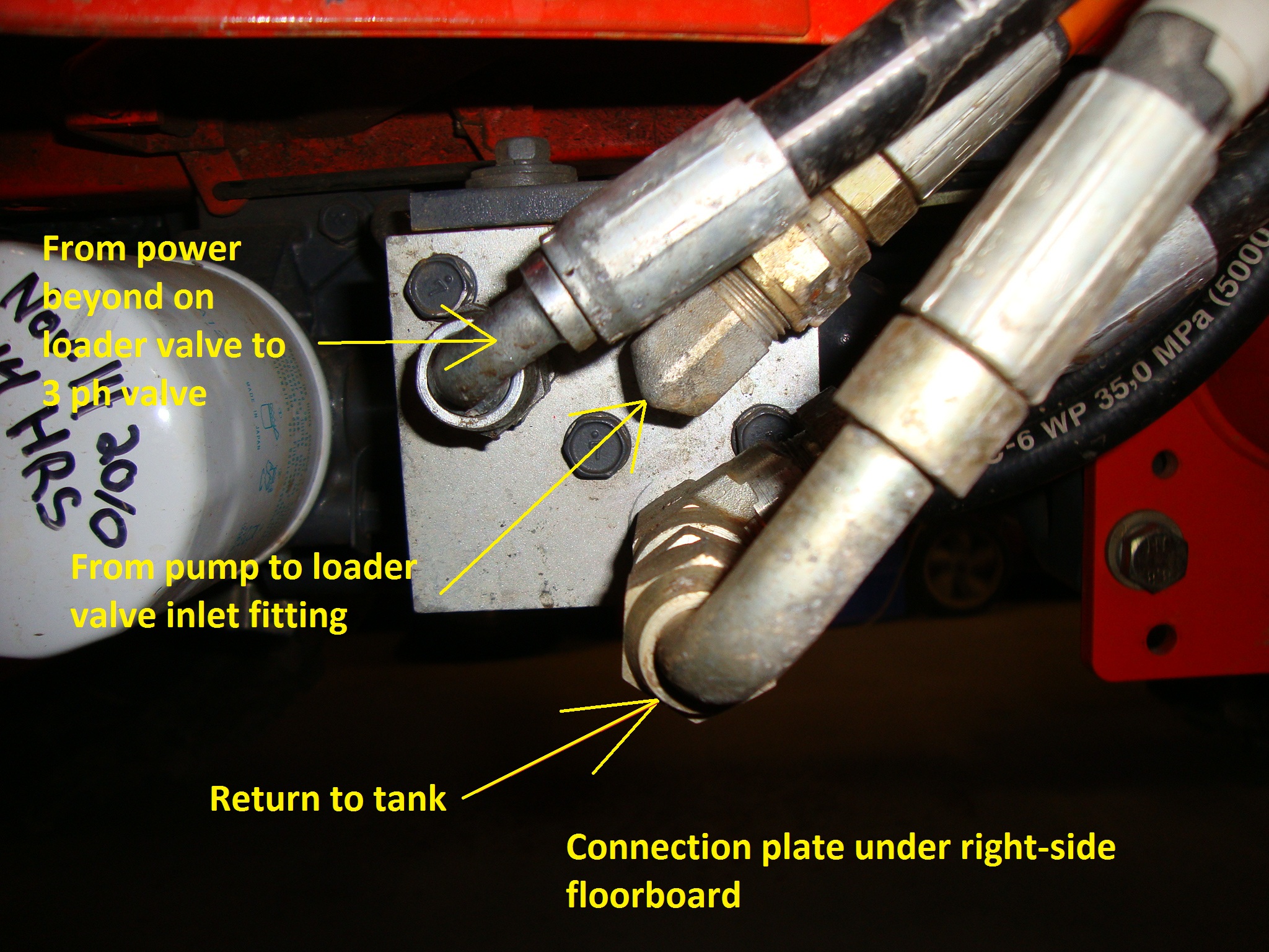

I did the same thing you're talking about with my L3400 with loader. I added one set of remotes and a non-Kubota valve to control the new remote. Here's the link to that thread..
http://www.tractorbynet.com/forums/hydraulics/188519-adding-rear-remote-kubota-l3400.html
You should be able to see enough of the connection plate to help you out. I used the (green) hose from the power beyond connection on the loader valve to go to the inlet on the new remote valve, the outlet and power beyond adapter from the new valve attach where the green hose was connected on the junction block. The return or tank connection from the new valve is teed into the drain connection on the block. I think it's the grey connector. If you want I'll try to get a few more pics if you need them.
The first pic shows the upper left connection from the power beyond adaptor on the remote valve (second pic, yellow arrow) going to the 3 point hitch valve, which is third and last in line. The loader is first, the remote valve is 2nd, and the 3ph is last, which is nearly always the case. This is because there is no way to connect the 3ph valve outlet with a power beyond adapter since it's buried in the transmission case.

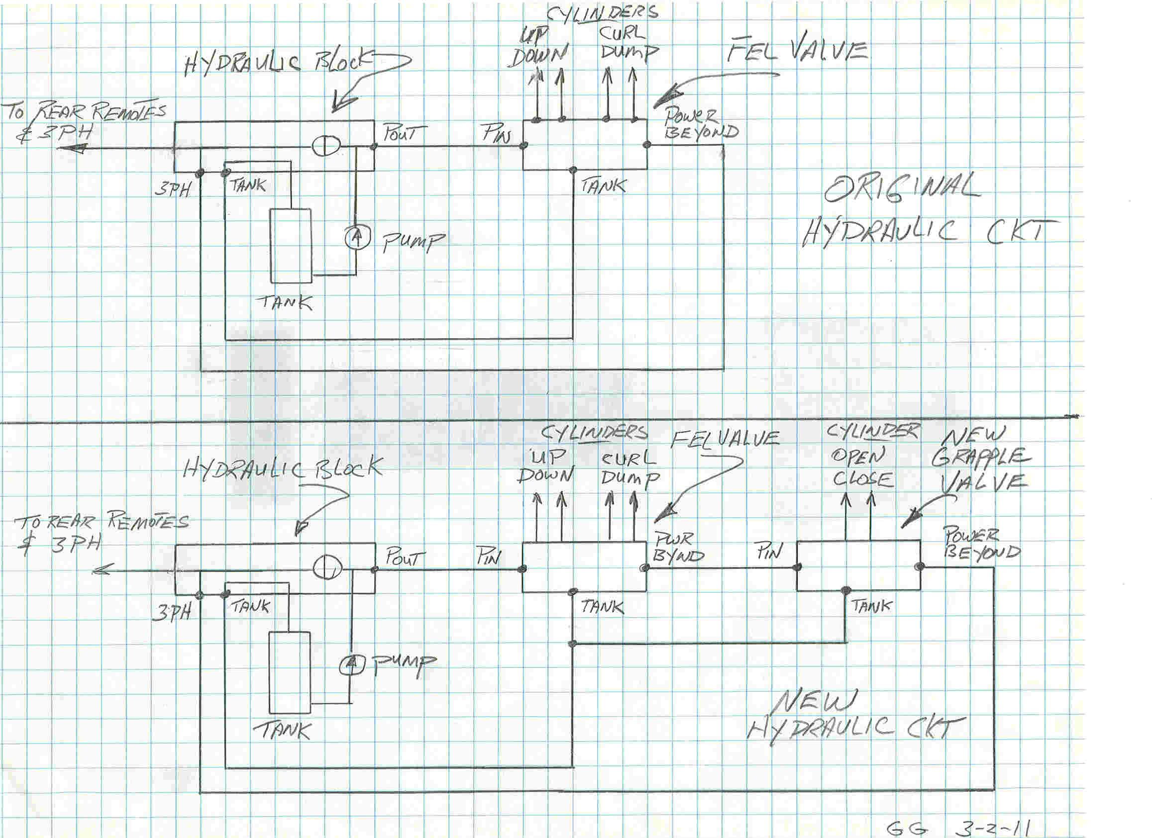

Here is a diagram of the way I added a valve to my L3010. My added valve had a power beyond port. If yours does not you would run your added valve tank port to the same spot that I ran the new valve power beyond output and you would ignor the tee'ed tank connection between the two valves on my diagram like Sean did.

Further to my previous post. I just got everything working properly THANKS to you fellows. After I read all 3 posts thoroughly and made sense of Gordons drawing it worked. I thought I needed the power beyond valve but after getting Gordons diagram through my thick head it worked.I ran the tank port from the new valve to the top left 3ph on the tractor block and plumbed it as per the drawing and Sean's pictures. I really appreciate the help. I was starting to lose it. Now i can install my Kubota quick attach and try out my new 7 foot Bobcat front blade. You all saved my weekend. Thanks again fellows. JOHN
   / adding a control valve and rear remotes to Kubota L2800 and LA 463 loader #10
Hmm... have you tried operating the 3 point hitch yet? Possibly with any load on it? Unless I'm missing something, the valve "tank" connection you hooked to the 3PH (at the block) only has flow available when the remote valve is operating and oil is being returned from a cylinder or motor. In other words, you're using "second-hand" oil flow to operate your 3PH. I think you do need a different valve, one with 5 connections, those being "pressure in", "tank", "power beyond" (usually with an adapter) and the 2 work ports.
This is because the oil being returned from the cylinder or motor needs somewhere to go when the cylinder or motor is being operated. In this case, you have it flowing to the 3 point hitch instead of the tank. What I THINK will happen is that once the accessory cylinder is at it's maximum stroke (either extended or retracted), is that the 3 point hitch will stop lifting, since there's no more flow to it at that point. There's also the issue of back pressure on the remote valve. If you have a load on the 3PH and the valve calling for more oil, that load pressure will be felt at the tank port as well, and may bind the remote valve.
I hope I'm wrong, but I don't think so.
The way the power beyond system works, is that it is a series circuit in which the items that are first in the flow path take priority over those that come after them. 95% of these are plumbed with the loader coming first, the remote valves second, and the 3PH coming third in line. The 3PH is almost always the last item in line. When you're using the loader, if you're using all the oil flow (i.e. the valve is fully open), there is no oil flow to the remotes or the 3 PH. Same with the remote.. if it's fully opened there is no flow to the 3PH valve. This can be a problem if you're using a hydraulic motor to drive a spreader for example and want to raise the 3 PH while the spreader is running. I think a flow divider would work in that instance, but we're getting beyond where we need to be.
I've added some more pictures of my valve hookup. Just in case. From what I can see, Gordon's is virtually identical to mine.
Sean
