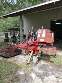

How far down in the ditch will that unit angle? This cutter head floats upward but is limited to going down and it will go down in the ditchbank up to 90 degrees. The problem comes when you hit something solid in the ditch, which would apply to this old cutter or new flails. I have a 10' Maschio slide flail as well.
   / Adding a float function to my rear Remotes for a ditch bank mower. #12
He didn't specify, but I'm guessing he's going with a side shifting style ditch bank.
Like this one
goes 90° up(vertical) and about 60° down
