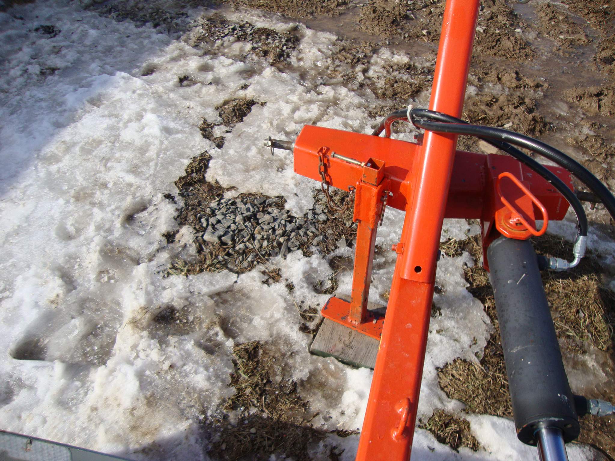

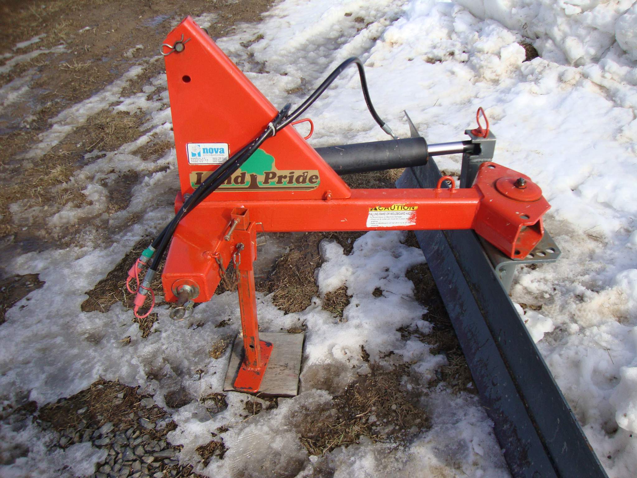

   / Adding a foot stand to an angle blade. #25
Ok, finally got some pics of the stand. I didn't have the exact right size square tube to use for the outer sleeve, so I welded a cap where it needed to be between the two side supports.
Sean
   / Adding a foot stand to an angle blade. #26
For those of us without welders, is there a cost-effective add on stand you could buy that might clamp or bolt on?
A no weld solution is a piece of pipe drilled through and bolted to the blade with a heavy duty spring between the pipe and the blade frame...The spring allows the pipe to pivot or invert...you can get thread on base plates for common sized galv. pipe...
FWIW...This is the type of (kick) stand that came on my tiller...
