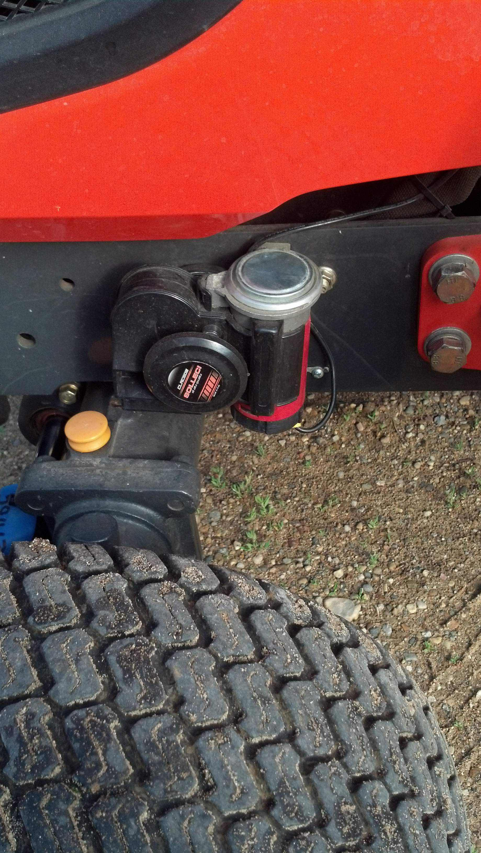

<img src="http://www.tractorbynet.com/forums/attachment.php?attachmentid=336421"/> Mount up that baby and you will be the envy of all the other TBN'ers
I started looking for a good place to mount the horn and to my surprise, there was a perfect spot just below the air cleaner. The mounting bolt even fit into the pre-threaded hole in the cross brace. I'm guessing this is a standard bracket used on cab models and they mount the standard Kubota horn there. The Strebel horn bolt just happens to be the same size.
I did a quick test on the horn sound and it is definitely LOUD! Time to run the wiring.

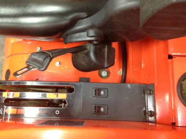

Since I'm adding addition fuses, I decided to go ahead and add a 12v power outlet. I saw how someone else on TBN used the existing hole near the seat, so I decided to try it as well and it's nearly a perfect fit. Not sure what this hole is for, but it was from the factory and came with a rubber cover over it. Just popped off the cover, inserted the outlet and tightened up the nut underneath. Will use one of the 10amp circuits on the new PowerHub once it is installed.
Now I'll be able to add a portable strobe or bring along my phone car charger.
Could have been me as I did the exact same thing three years ago :), It is the hole for the mid pto kit control if you have a Grand L40 like I do.
Norm,
I think it was you! Thanks for the great idea and for clearing up the mystery about this hole. Makes a lot of sense now that you mention it.
