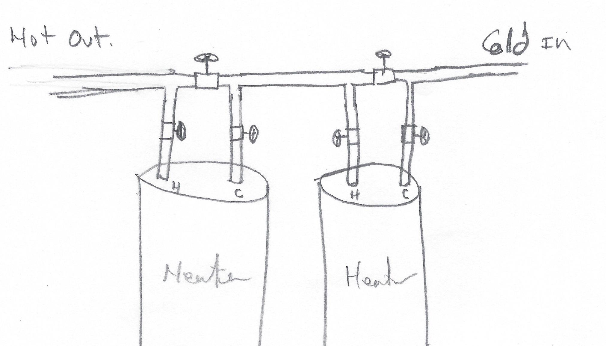

Our house came with a 40 gal water heater. We have 3 bathrooms and four daughters. two of the baths are on one end of the home and the Master is on the other end with the kitchen in between but on the other side of the house (baths are near back while kitchen is near front).
We had an existing 40 gal water heater from our old house (it was only about a year old) so I installed that in the master area. Well, it did some odd things. Seems when the baths on the other end of the house were used it pulled the hot water from the master tank and when we used the master shower, it pulled the water from the other tank. I tried backflow preventers on the outflow but it did not help.
In the end, I had to disconnect the hot at the master tank coming from the other tank and use the master tank for ONLY the master and let the other one handle the rest of the house. It works great!

Say you've got two 50-gal tanks.
Right, for 100 gallons AT TEMPERATURE.
You use 50 gallons of hot water for your shower. In series, the first heater has to heat up the entire 50 gallons again while the second tank experiences no load. In parallel, both tanks have to heat up 25 gallons.
Either way, you've got 50 gallons to heat, and that's going to take X amount of BTUs to heat it, regardless of whether one unit is doing all the heating or two units are each doing half the heating.
Yes, the energy used is the same, but that is not the only issue...part of the issue is the amount of hot water available at the moment of demand. With parallel tanks you are pulling out hot, but they are being refilled with cold, cooling off all the water in both tanks. So by the end of the 50 gallons of use, the water in both tanks is half as warm. Stratification helps some, but it is still mixing in and cooling off.
In series, the water drawing into the 1st tank being warm to start with means that the chilling effect of the cold water is delayed, and the water stays hotter to the end of your 50 gallons. But if you keep going from there to the end of the 100 gallons, yes it's all cold and it doesn't matter.
So to my mind at least, hooking in series is a way to mess with the timing of availability of hot water, not total energy use.

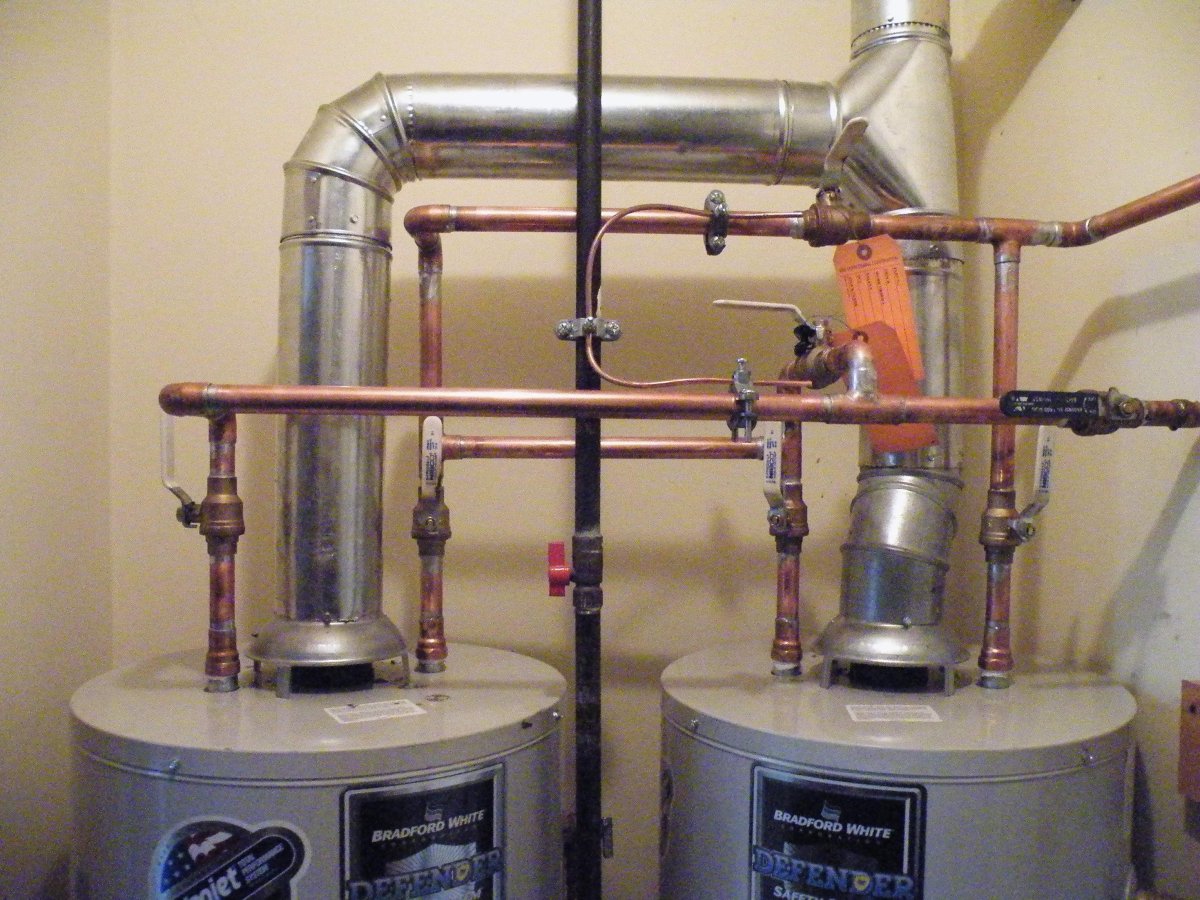

I understand your precedent. Like you, I have a large household in my 6k sq ft house. It has two 50g tanks plumbed in series but on natural gas so I couldn't help too much with regards to that BUT,

Every double installed hot water tank I have seen is piped in series so the first is preheating and the second heats to final temp. Energy used is the same but the amount of hot water you can get is almost unlimited. Dual hot water heaters can heat water from a 3/4" inlet just about as fast as it can run thru.
You can get the same result running them in parallel. Either way, you've got twice the BTUs going into the water on it's way through as you would have with a single tank. Cold supply water will come out the other end with the same total temperature rise in either configuration. Well, actually, the parallel setup has the advantage here because both of them are starting with cold water, whereas when in series the second tank will be starting with "half warmed" water resulting in slightly less efficient heat transfer in the second tank. But I'm sure that difference would not be noticeable to the person taking a shower.
Well, that depends on their BTU output size, of course. And of course it can be true for both a series setup and for a parallel setup. For a given water flow...with a series setup the water gets to go through twice, but at full speed...with a parallel setup it's only going through one or the other, but it's in there being heated twice as long. The result at the shower head is the same.
The only really valid reason to pick series or parallel is for serviceability, and I think parallel has the edge unless you want to put in bypass lines/valves on the series setup, in which case it becomes a moot point.

There is no advantage to that.
Say you've got two 50-gal tanks. You use 50 gallons of hot water for your shower. In series, the first heater has to heat up the entire 50 gallons again while the second tank experiences no load. In parallel, both tanks have to heat up 25 gallons.
True. The advantage to series is, considering cyclic use as a norm, it can be set up for better efficiency:
Yes, definitely in series -- the 1st at minimum T setting and the 2nd at your desired hot water temp. Bite the bullet on elec circuits and use the stock elements. You will have unlimited hot water and much more efficient than holding 2 tanks at full desired T.
...... Better yet use an on demand heater as the second. That way youre only storing a tank of water prewarmed and ready for the boost. Very little quiescent heat loss and unlimited hot water.
