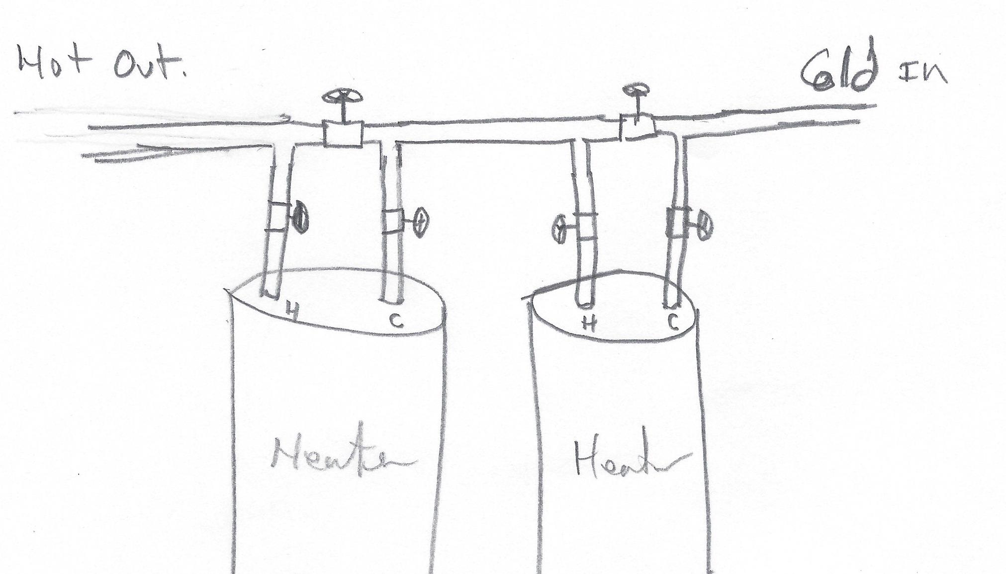

I have a rooms in the shop/barn (meat room, milk room), but most of the time I I use a compact under counter 30 gallon heater, and use that 90% of the time, but when I cut meat, I have a 30 gallon gas heater on the other side of the room there hooked up in series, I have them valve-ed, so I can use one or both, I will run out of hot water when washing up with the electric 30, but with both working I have yet to run out,
but I would hook them up in series, yes one will bear most of the load, but with a little valve-ing one could use one or both and if one dies you will still have hot water, while one repairs or replaces the other,

I've got three teenagers in the house and the 50 gallon electric water heater isn't keeping up, so I'm thinking about adding another. I have two questions I'm pondering.
The first is whether I have to run another circuit, I'd rather not. I have a run of 10-2 right now with a 30A breaker. My understanding is that each 220V device needs it's own circuit so I'm thinking of adding a panel at the water heaters with two 15A breakers. At 80% loading each could get 12A, which is 2600 Watts at 220V. I can get 2500W elements. Would it be OK just to replace all four elements with 2500 Watt ones?
Second question is serial or parallel for the hookup of the water heaters. It seems that with parallel you spread the load, while with serial the back one does all the work while the front one loafs, only coming on when you've exhausted the back. But with parallel you have to somehow balance the load, and if you don't you could drain one tank while the other one still has hot water.
Thoughts?
Thanks.

... I would hook them up in series, yes one will bear most of the load, but with a little valve-ing one could use one or both and if one dies you will still have hot water, while one repairs or replaces the other,

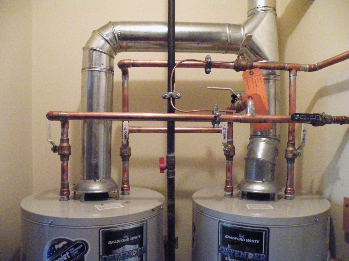

Here's another example that someone posted a while back. It's the same design as the one in the sketch above, but it sure looks a lot more complicated in real life.
Yes, definitely in series -- the 1st at minimum T setting and the 2nd at your desired hot water temp. Bite the bullet on elec circuits and use the stock elements. You will have unlimited hot water and much more efficient than holding 2 tanks at full desired T.
That complex look is because that is a setup with valving that allows every tank combination. ... Either tank alone, or tanks running in series or in parallel.

They appear to me to be set up to run in series only. And by the valve orientations. They are plumbed with a bypass so that either one could be removed from the system while the other does the work, but in order to run parallel you would want a valve in the bypass line as well...otherwise you'd be bypassing at least a third of your cold water right to the hot water side.

With this setup and the previous sketched drawing, both the cold and hot lines are valved at the water heater, not a safe installation by any means. Each heater could be totally isolated, if the tank stat called for heat, the water would expand causing the relief valve to blow and possibly damage the tank itself. Another note, both water heaters vent with 4" draft hood and combine into a 4" tee, another serious design flaw.
Yes. Youre right. The setup only provides sequestered flow for series or individually.
