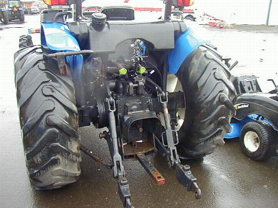

I looked at the parts manual for the TN65 and TN75. They have the same cubic inches but the block, pistons, rings, and others parts are different part numbers.
The reasons why I don't trade up? There isn't any used TN75's around my area and I couldn't afford one if there was. I am 17, bought the tractor just recently with cashed saved up for $10,500, which, I would like to ask if anybody else thinks that was a deal. I included the dealer pictures below of the tractor. Once I get the turbo done, I will get better pictures. The newest tractor that I was able to find for a price close to mine was a 1995 CaseIh with 4000 hours, they had it listed at $11,500 and I have been looking for a few months.
I like tinkering and especially modifying things. There's no such thing as can't in my vocabulary. I usually tear into something before I actually know what I am doing and it bites me in the butt most of the time. Someone once told me, the best way to learn is to just do it!
Scott, Thats a impressive car.:cool: It must have been exciting to build it.
To get back on the subject, The TN65 is a 179ci engine putting out 65HP. You asked if I can hear when it loads. What would I be trying to hear? Would that be when it starts to whistle? It does whistle at higher rpm's.
I tried but couldn't figure out the air flow part on those maps. Do you have the link to the website you mentioned?
Thanks,
Dan

Well, I just saw your pics of the recommendations by IHI on turbo applications, for just "picking any old turbo" you got pretty lucky, that turbo is great for your application if perhaps just a little too big.
IHI does a decent job of recommending "power ranges" and your tractor falls right in the lower end of recommended diesel applications for that particular turbo.
Usually guys don't even plumb the water lines, on a tractor it might be a good idea though... I think your fab work is fine.
Here's a map for the IHI units:
I'd recommend getting a boost gauge and perhaps weakening the wastegate spring (cut a coil? make it adjustable? should be pretty easy) to get the max boost down to a low level for starters (so you don't hurt anything). Then find out what PSI it boosts to (a boost gauge is cheap! few bucks from a parts store for a basic fuel pressure gauge would do fine!) loaded, and unloaded at higher RPMs.
I think the wastegate is big enough on that turbo that all you'd need to do is have it open sooner, at lower boost pressure. You are going to have to watch EGTs, there's no two ways about that - Autometer's decent EGT setup with gauge is like $160, there are cheaper ones out there or go used and get a replacement thermocouple for $30 from Aircraft Spruce.
Anyways, before using it you need boost pressure control (wastegate) and EGT monitoring. Start on small boost. The wastegate shoudl be big enough to let you regulate as low as 2-3 psi.
Set that up then get back with us, and we'll make sure it's working to help and not hurt the motor,

What are you planning on using this tractor for? One thing that jumped to my head was the rear tires are R-4's and worn at that. For what you paid you could have bought a brand new TT75 for just a few grand more. I know you are on a limited budget but I would talk to a dealer and try to trade this TN back in on a TT with the hp and new tires. Tires alone will set you back quite a bit and if you want to go R-1s you will need new rims which will easily justify the cost of a new TT.
I have no problem with what you are doing as I always enjoy threads like yours but I know where you are roughly in your life and what you are trying to do. Buy the proper tractor, finance the difference if you have to and I assure you that everytime you are on your new tractor you will be smiling:)
For a price comparison, I bought my 1987 Ford 7710-II with 4800 hours and putting out 120 hp. It was 2wd with a cab and cost me around $14k. Plus, it already had a turbo:D
Best of luck to you and if you need any help with anything just post it and I am sure someone on here will be able to help you.

Heres a picture of the wastegate that I already ordered a couple days ago.
Internal Wastegate Actuator
The min is 7psi. I already opened my old one and I would be worried that I would not be able to crimp it back together tight enough so that the rubber doesn't slip out. Any thing else I could do, short of having to open the wastegate up?
Through Summit Racing, I can get 2 identical looking egt and boost gauges with illumination for about $200 altogether.

I will using it to cut, rake, bale and pull a balewagon. Before I went out to look at my tractor, I already got pricing to put on 16.9x30's. But the tires have more tread then what it looks like in the pictures. I hoping they will last a few more years. I don't plan on having this tractor for more then 2-3 years.
I didn't want to borrow money for a tractor. I try to have the money before I buy anything, so that I won't ever bury myself in debt.
