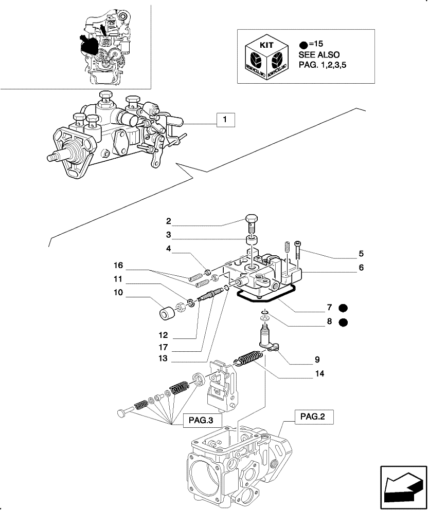

Everybody here has been very helpful to me and I am very thankful for that.
My friend who gave me the turbo came by tonight to see what I had accomplished. We got to talking about fuel metering. He said that everyone he talked to that rebuilt injector pumps told him it can't be done.
Can anyone explain how this is done? What are we looking for on the injector pump?
I said I didn't plan on touching my injector pump but now I have to be careful. I'm getting all excited over the tuning that can be done!:D I can assure you that I will not touch the injector pump before I get my gauges.;)
   / Adding a turbo to a TN65 #22
What altitude/elevation do you live at?
Also, I am *not* knowledgable about the injector pumps on your tractor, but in general on diesels with mechanical pumps, one pump design usually serves a range of engines with different HP levels.
For example, on a Cummins 6BT diesel (the old mechanically-pumped versions up to early 1998 models), it takes hardly anything to install a new "torque plate" or even pump up the base fuel pressure (with a screwdriver!) to increase fueling... both are simple and cheap mods, and the engine runs happily with them. Another possbile way to add fuel to the engine is to have the injectors modified for reduced opening pressure. This has the effect of allowing more fuel to pass into the prechamber but beware, it also has the effect of advancing ignition timing. Most people don't even think about ignition timing on a diesel, but it plays an important role in the power produced, and safety of the tune.
-scott
#24
According to google earth, I am at 427'.

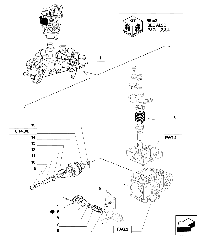

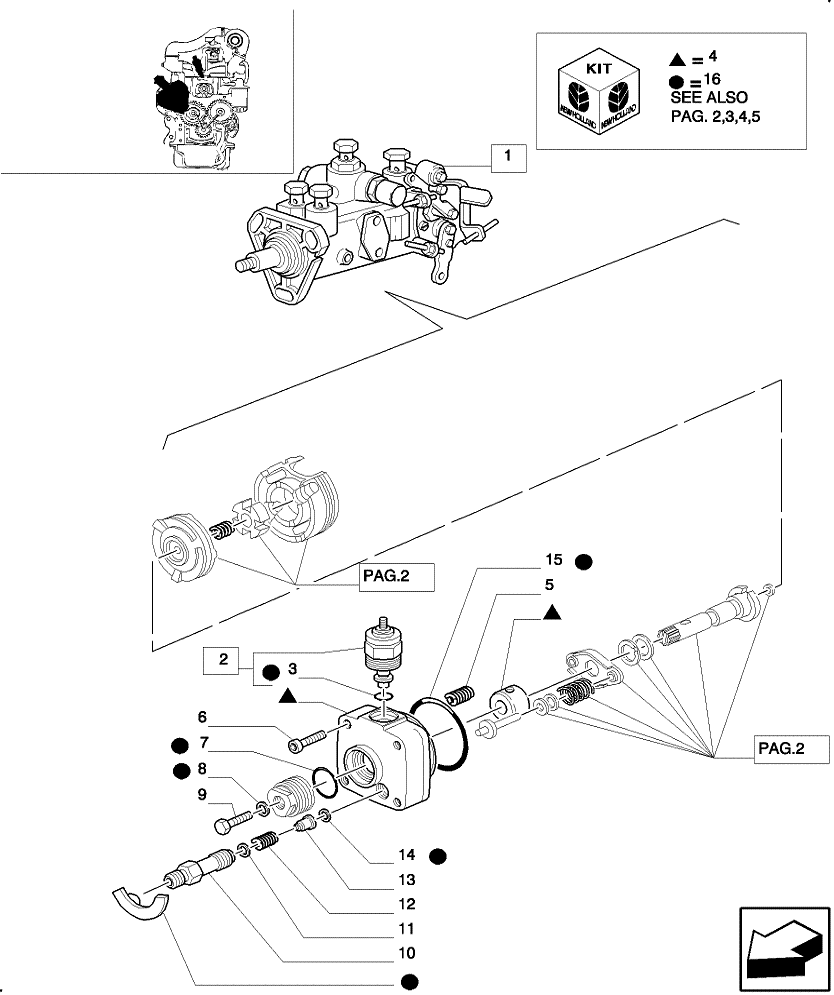

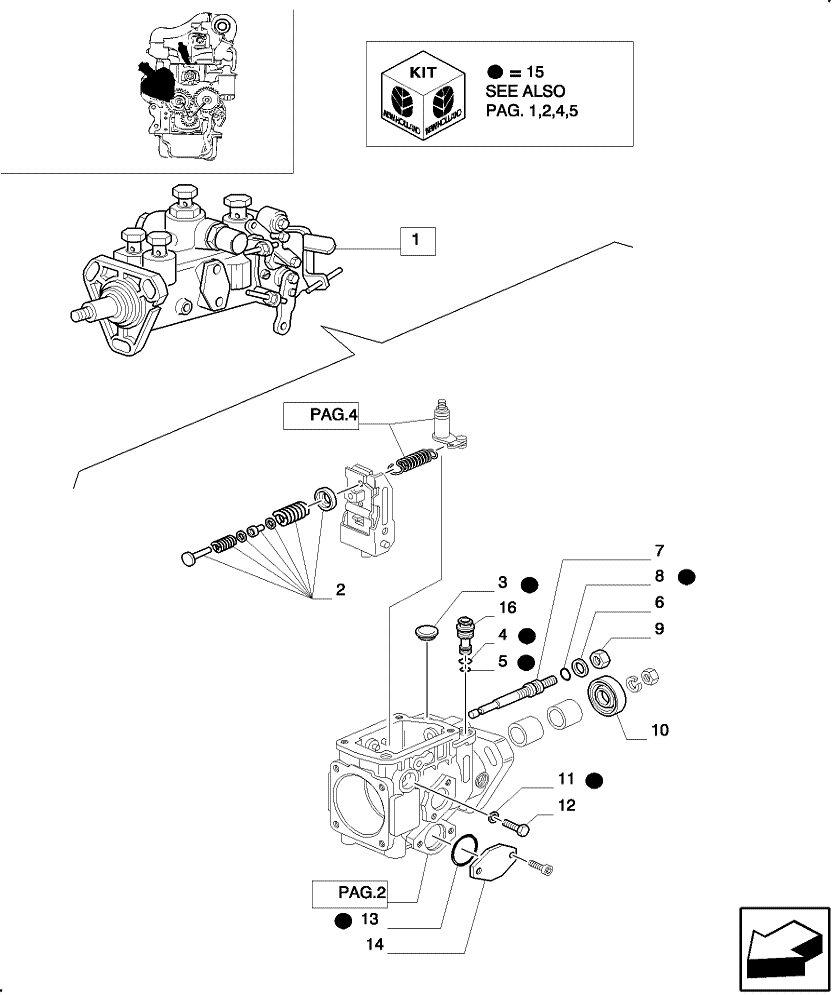

I was looking at the parts breakdown of the injector pump and was wondering if you could tell which adjustment it would be just by looking at the diagrams.
In picture #2, I can see #7 and #12 being adjustments.
In picture #3, There's #17.
Thanks again,
Dan
