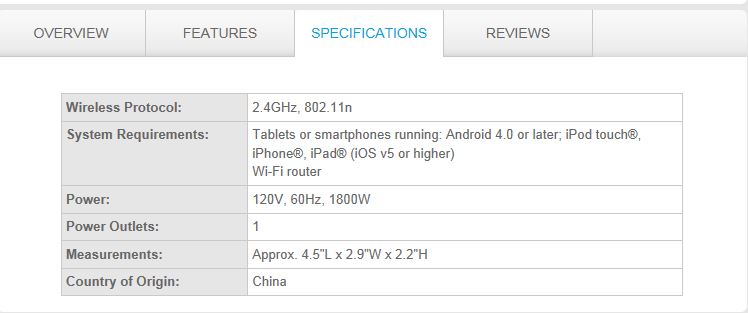

Belkin WeMo Insight Switch Review - Watch CNET's Video Review here's CNET article this would probably be cheapest route @$49 -$59 . I'm considering going buying the light switch and testing it in the house now. I created an and account on IFTTT no charge. Belkin has free simple routines that you add to use it as a simple switch there is also a free WEMO app for android and Iphone
if you wanted a hub wemo devices are fully compatible Revolv with http://amzn.com/B00EWJQ9PK

I would like to add a Wi Fi outlet that I can plug my tractor into. I did a short search on the internet and saw some Wi Fi plug in outlets. I was wondering if those would handle the 1500 watts of a block heater. It would be nice to be able to "plug" my tractor in while I was still at work so I can start it once I get home.
I would also like to add a second one to plug my work vehicle into. Something with a timer function so instead of paying to have the block heater plugged in all night it would energize it a couple of hours before I go to work.
Has anyone done something like this? What are my options? What would I need and how difficult is it to install?
Thanks for the help.
For high watt/amp draw devices like a block heater just buy a programmable heavy duty timer and plug it into an outlet and then the heater into it Set it to trip on at a certain time and then unplug it when you get home. Simple, no setup, no wireless BS, and no problems with wi-fi not working, not working remotely, lost signals etc., etc. JMHO
