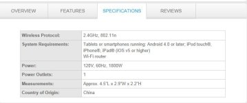

here are the specs on the belkin. it is suppose to handle 1800 watts.

The chance of a WiFi being able to handle more than 15 amps is remote. Personally I wouldn't want to control anything that generates large amounts of heat when I'm not in the nearby vicinity to handle potential circumstances gone awry.
Most block heaters are 400 watts or so, aren't they?
So if the Wemo handles 1,800 Watts (ie 15 amps @ 120V) that is more than sufficient.

Most block heaters are only 300-400 watts: way less than a toaster or a microwave or even a coffee maker. so I don't understand where these power requirements in excess of 15 Amps / 1,800 watts are coming from.
