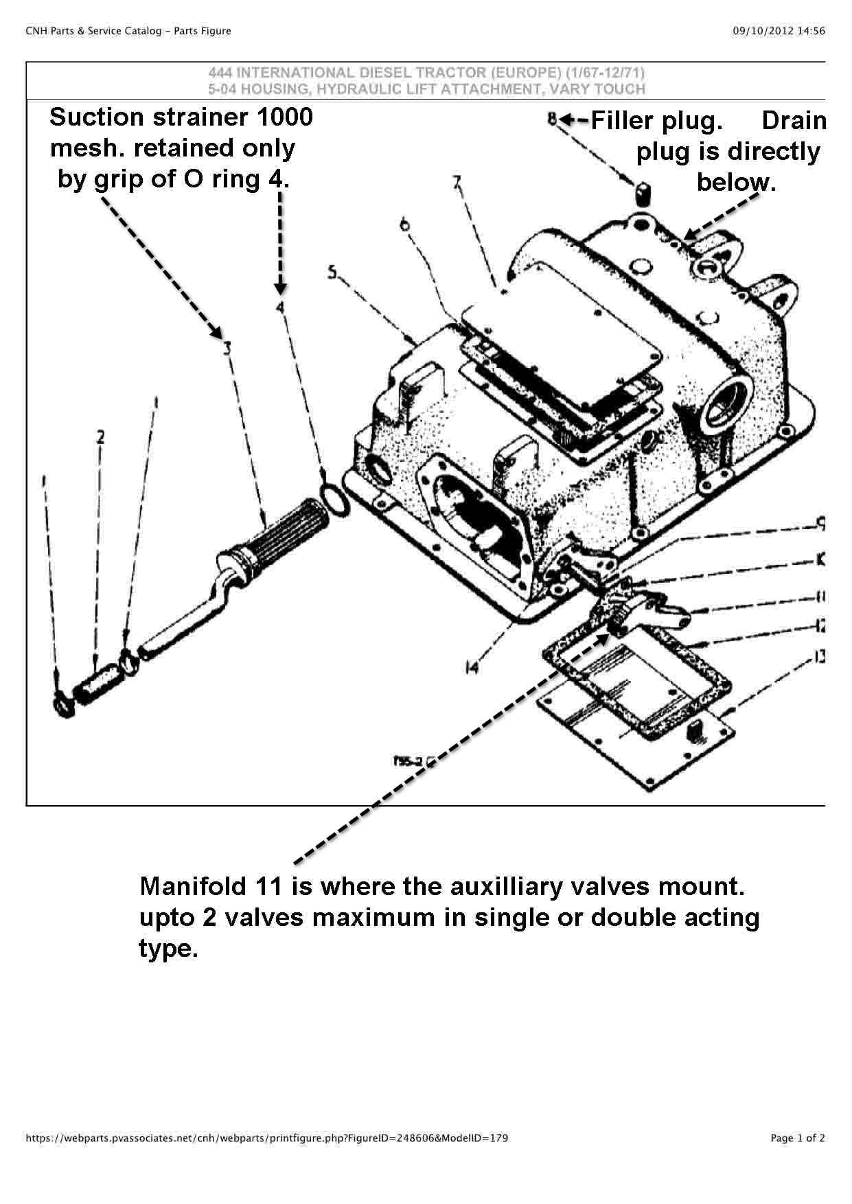

Im new to farming and tractor use so, this might be a dumb question. Can I add additional hydraulic hook ups to our International 444 to run implements that require hydraulic use? I would like to upgrade from our very old sickle bar to a newer disk mower that requires the hydraulics to raise and lower it from the horizontal position. Is this possible? I know some of the 444 had FEL so is there a way to utilize this ability for other implements or is it a different system for non FEL like our tractor? Thanks for the replys!
/ Adding additional Hydraulic hookups? #2
Hi again i assume from your question you have no auxiliary hydraulic valves on the tractor at present??

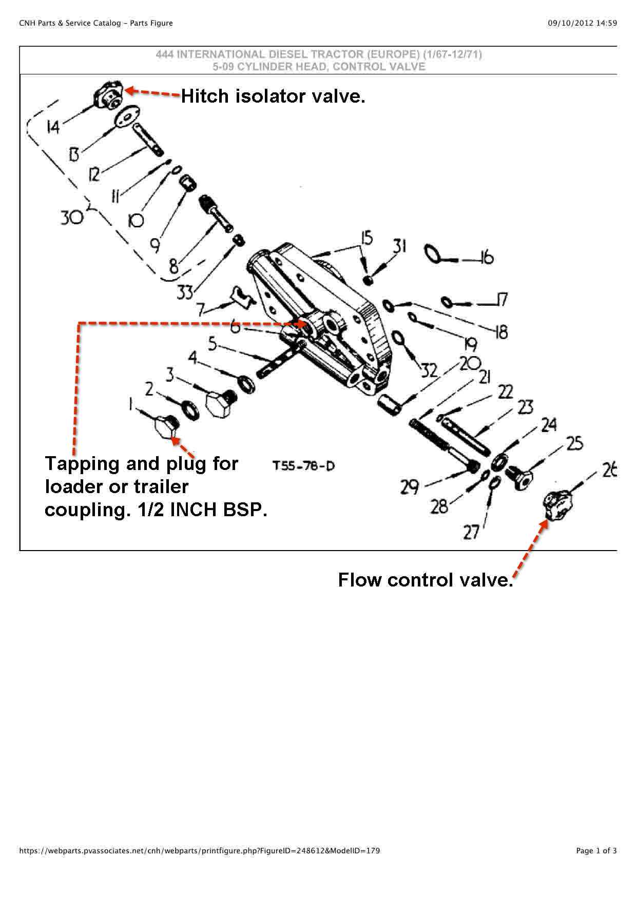

To simply tip a trailer you can use the FEL tapping to provide a single acting service using the levers and control valves already on the tractor.
For extra service you can add 2 extra valves, single or double acting to the manifold on the l/hand side of the hydraulic housing under seat , behind your left knee.
I will find a parts layout with part no's and post later.!!!

Yes, in its simplest form it could, but this will only give you 1 service, single acting to lift the loader, if you have gravity tip for bucket./fork o/k, if you have hydraulic tip/crowd on bucket then you need extra valves.
You can c still fit a loader valve bank and supply them from hitch valve, without fitting extra auxiliary valves on tractor.

Birch hill farm see atts for info previously discussed, this should answer your questions
I have used the 444 European parts book as diagrams are clearer !!!!

If I use the existing tapping on the control head can I hook a duel action valve to that port or will it only be able to be used as a single action, like a simple lift with gravity drop?
/ Adding additional Hydraulic hookups? #20
The existing tapping can be used as a supply, it will only work when the hydraulic lever is in the raised position.
The return will have to go to the filler point at the rear, it would be better if the returnwas tapped into the point where the drain plug is !!
