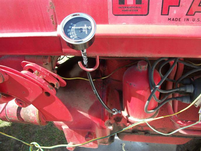

my rec, for a gauge on a liquid tire, is to use a grease gun hose coupled to a gauge, with a tire valve end on the hose.
the liquid will never hit the gauge.
I have oil pressure gauges with whips like this for checking tractors. many times i go look at tractors with no gauge, and it's easy to pull an old sendor or plug, thread int he gauge on a hose with an adapter if needed, then check pressure. here's the one i use, and this is an actual pic of me using it on a farmall C i bought at auction that had no gauge! :)

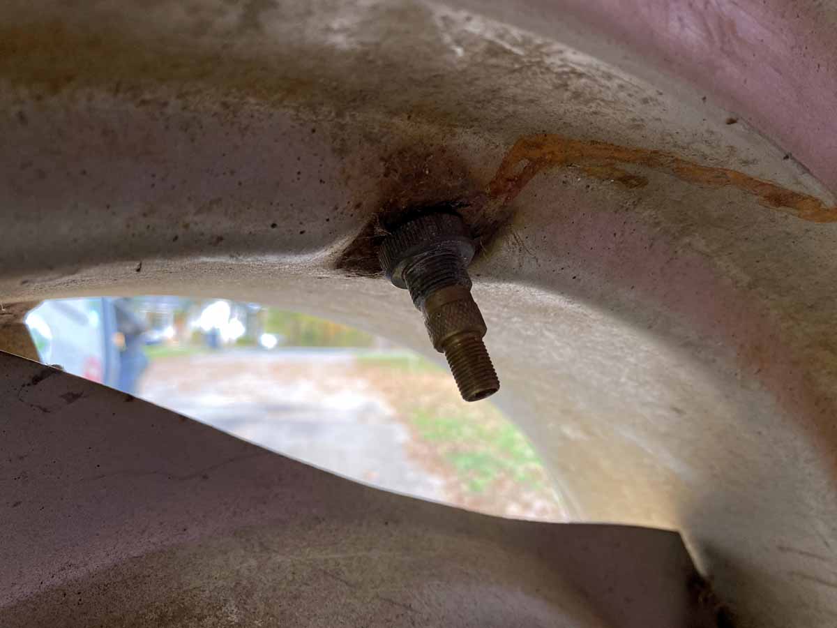

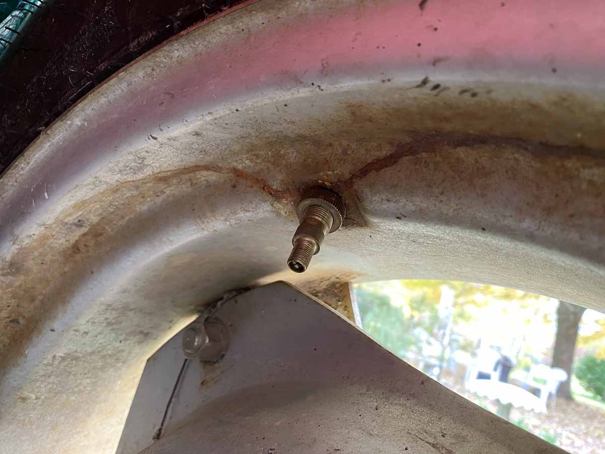

Bumping an old thread to ask a follow-up question. I was having the same problem as the OP with an inability to check the pressure in my tires due to high pressure stream of fluid shooting out even with the valves at the 12 o'clock position. So, I put the tractor up on jack stands, removed the valve cores and let the fluid drain... for nearly an hour. Once the valves were free of fluid; I ran a small gauge bottle brush in them to clean out, then gave them a burst of air, and re-seated the valve cores.
As soon as I added air pressure to the tires; they started leaking around the edges of the valve base, like it was not properly sealing the rubber to the inside of the rim. I tightened the knurled nut on the valve body as tight as I could but it's still leaking air like a screen door on a submarine. Can I replace the entire valves without removing the wheels and taking them in to a tire shop?
Photos of my valve bodies.
   / Adding air to a loaded tire #25
^^^^^Do you know if your tires are tubed or tubeless,
If tubed when you had it jacked up and draining it could have gotten air between the tube and the tire,
as you add air to the tube it has to push that air out someplace and around the base of the valve stem is about the only place.
   / Adding air to a loaded tire #26
They are two piece, tubeless type valves and I recall the tire shop that installed them telling me tubeless.
