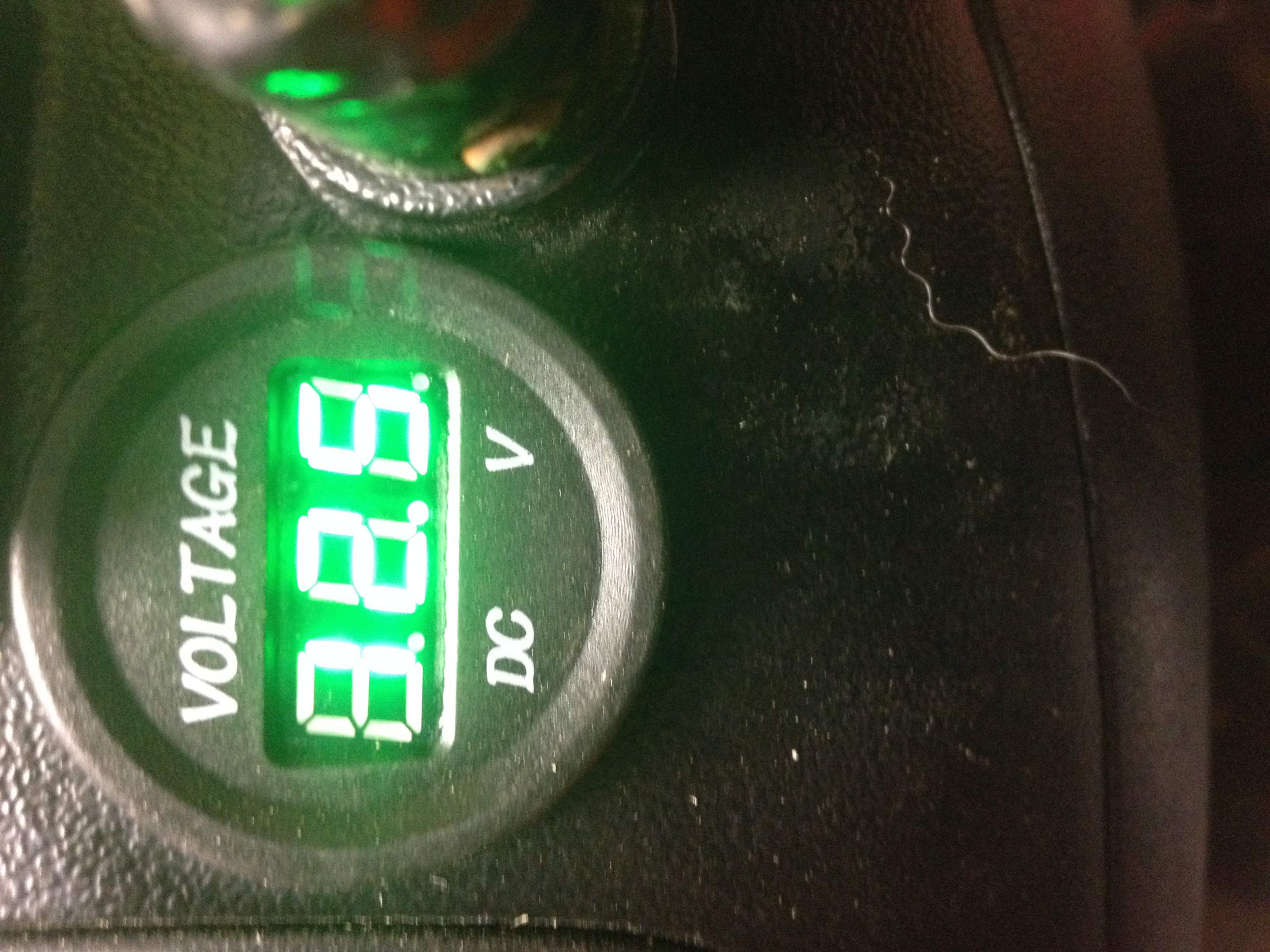

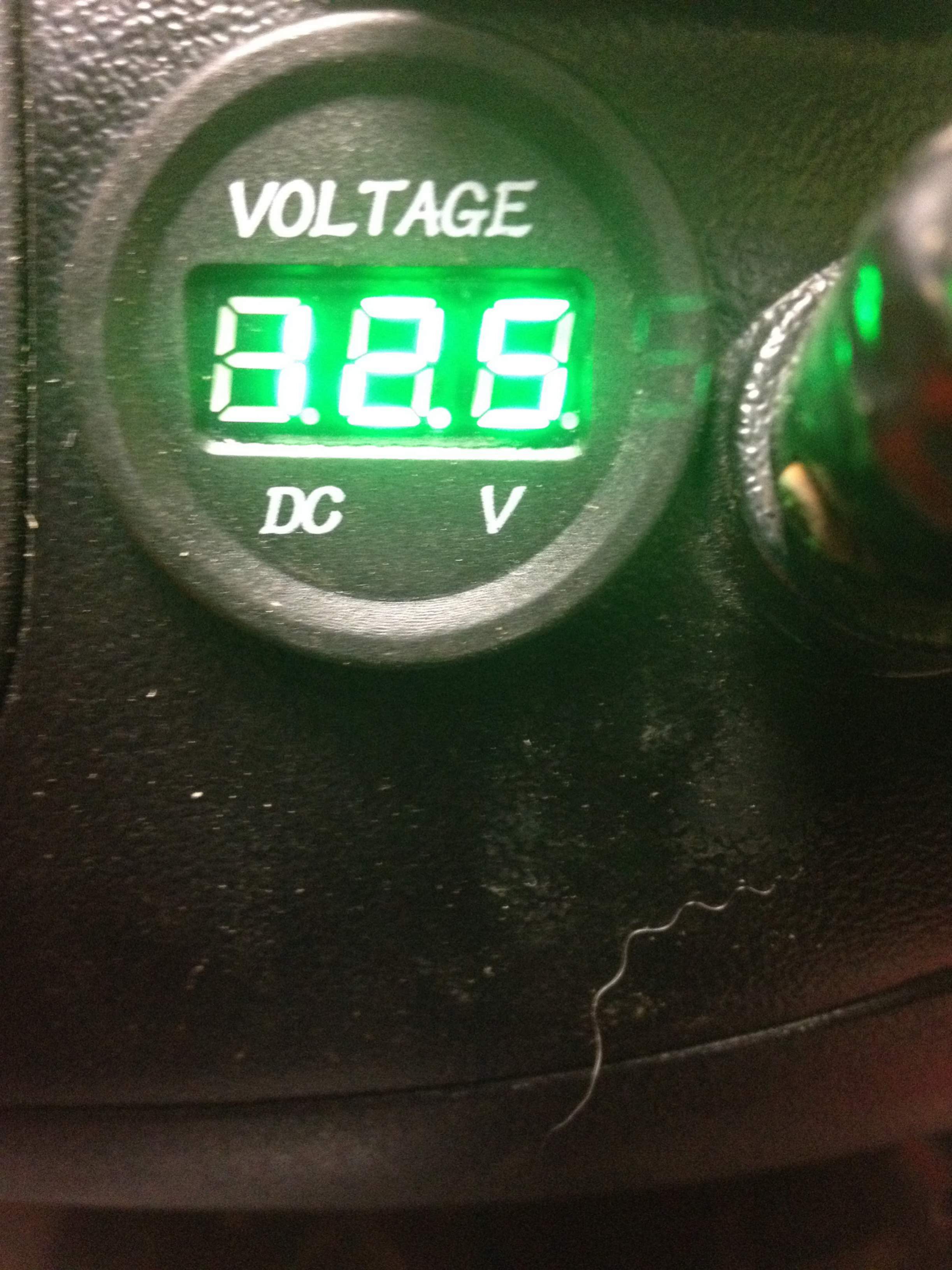

Yes, the green stands out and is really visible. I don't why the camera would not pick it up. I tried with and without the lights on in the pole barn.
Maybe the segments in the display are strobed by the display driver. Of course our eyes would integrate that and look continuous in the way a movie looks like continuous action when it is really just 24 frames a second stop motion.
   / Adding an LED voltmeter to my Kioti DK35se #22
------ I have attached pics although I am not sure why the camera did not pick up the voltage when on.-----------------------------
The camera did pick it up, it also got the other segments, maybe due to reflected light.
I see 12.5, the ones that are lit show up slightly wider.
On my picture, which shows up a little better, I "doctored" the picture, trying different filters and contrast controls until I got tired of playing with the picture and just posted it.

I added one to my Branson 2400h. It is round, though works great. Tied it into the cruise control fuse so it is only on when the tractor is on. I have attached pics although I am not sure why the camera did not pick up the voltage when on. Also added a 12v outlet, which is tied to a fuse block attached to the battery.
