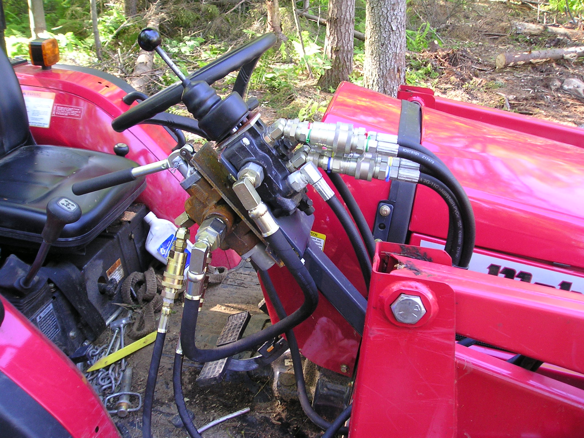

doug i found this pic of my 2810 with the valve. sorry it's only a side pic
but it should give you a idea of it j

doug i found this pic of my 2810 with the valve. sorry it's only a side pic but it should give you a idea of it j
Thanks very much. This is quite helpful. I think my FEL control valve is the alternate brand (can't remember which is which), but the concept would be the same. You appear to be using the power beyond port for the added grapple control. I am still trying to figure out why that is better than drawing directly from the high pressure supply line (other than fewer fittings, shorter hose, etc.). Perhaps I just answered my own question... or are there other advantages? Could a grapple spool have been directly mounted to the power beyond port with no hose or separate bracket?
The advatange to using the auxillary remotes (which you refer to as power beyond) is that it is already plumbed and valved. You can operate the grapple with the valve at the operator station that works the auxilary hydraulics.

JPM appears to have used the "power beyond port" of his stock FEL control valve to supply pressure to his added grapple valve. When I was initially looking at installing a separate grapple control valve, it appeared that teeing off the main pressure and dump lines made the most sense. What I would like to understand is what is the advantage of using the "power beyond port" of the FEL control valve for pressure rather than tapping directly into the main pressure supply line. I'd also like to know if an auxiliary spool can be added directly to the power beyond port of the FEL control valve such that no separate supply hose or separate mounting bracket would be necessary for the added grapple control valve.
The power beyond port of the FEL valve IS the pressure out to the next valve in line. You cannot tee off of any pressure line as all valves must be in series in the open center circuit of your tractor. Typically, fluid flows from the pump to the FEL valve inlet, then out thru the FEL power beyond port to the next valve in line which is usually the 3pt or an aux valve for the remotes. The third line on the FEL valve is the return to tank line which may be teed with other return to tank lines.
A seperate aux valve block with 1 or more spools can be added in series with the FEL valve by connecting the FEL valve's power beyond port to the inlet of the aux valve and the power beyond port of the aux valve to where ever the power beyond of the FEL valve went.
Some manufacturers make valve blocks than can be connected directly to each other. Some manufacturers make valve blocks whereby you can split them and add addtitional spools (ex. A Prince SV valve). Most likely your FEL valve does NOT support either of these two methods so a mounting scheme and additional hoses will be necessary to connect an additional aux valve.
