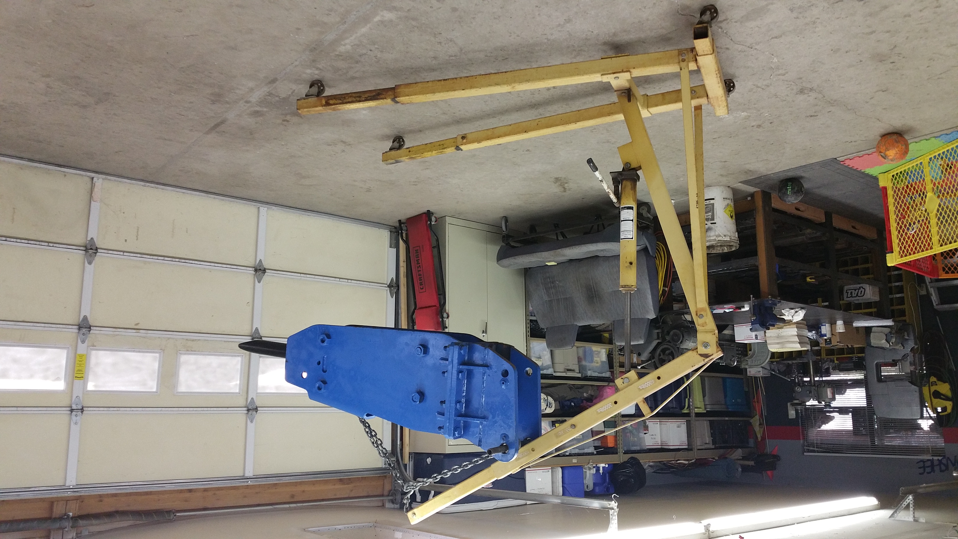

Adding auxiliary hydraulics to a 310C backhoe for a Okada hammer, please help

I have the rebuild of the hammer almost finished, waiting on seals from Hercules.

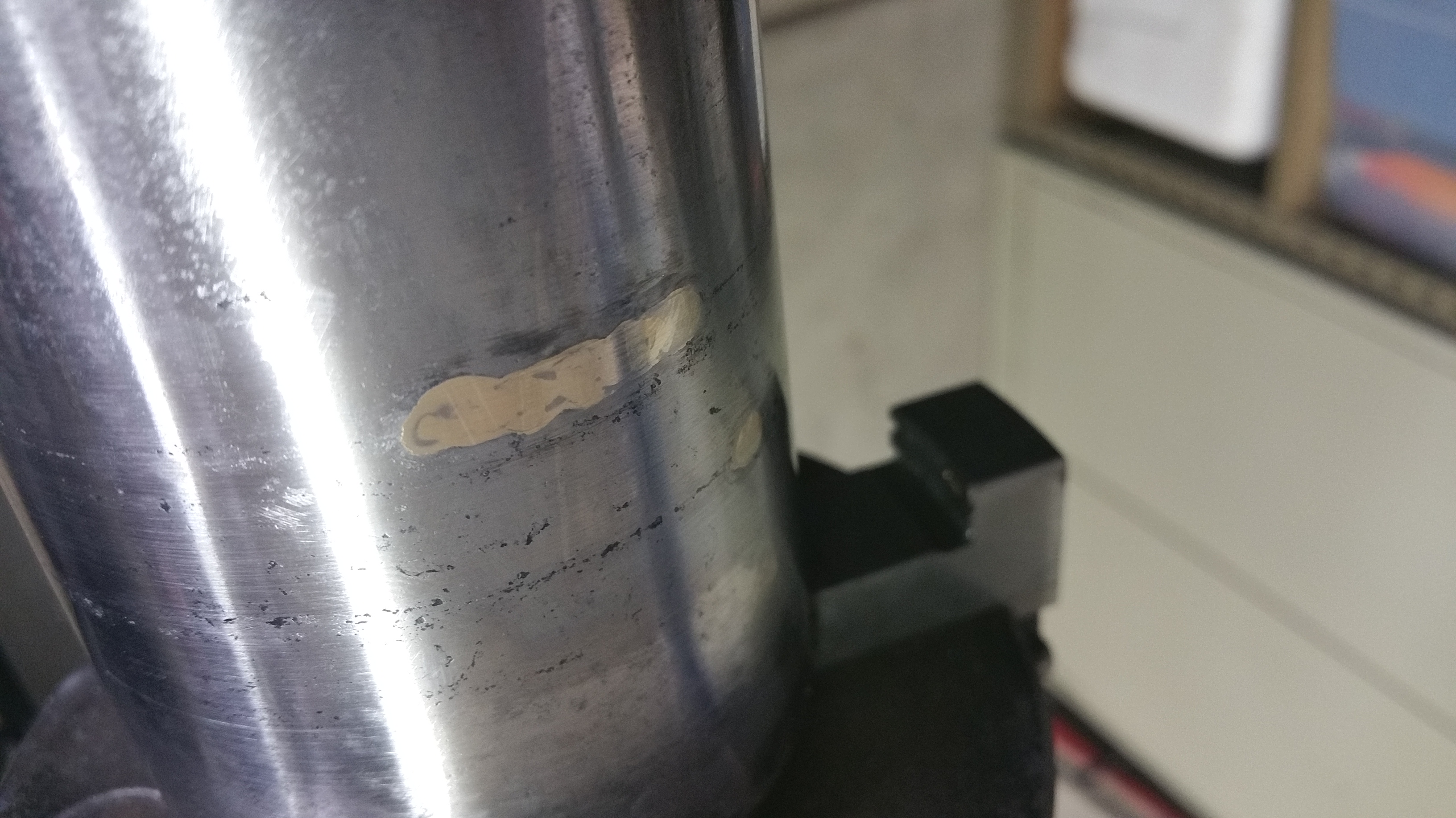

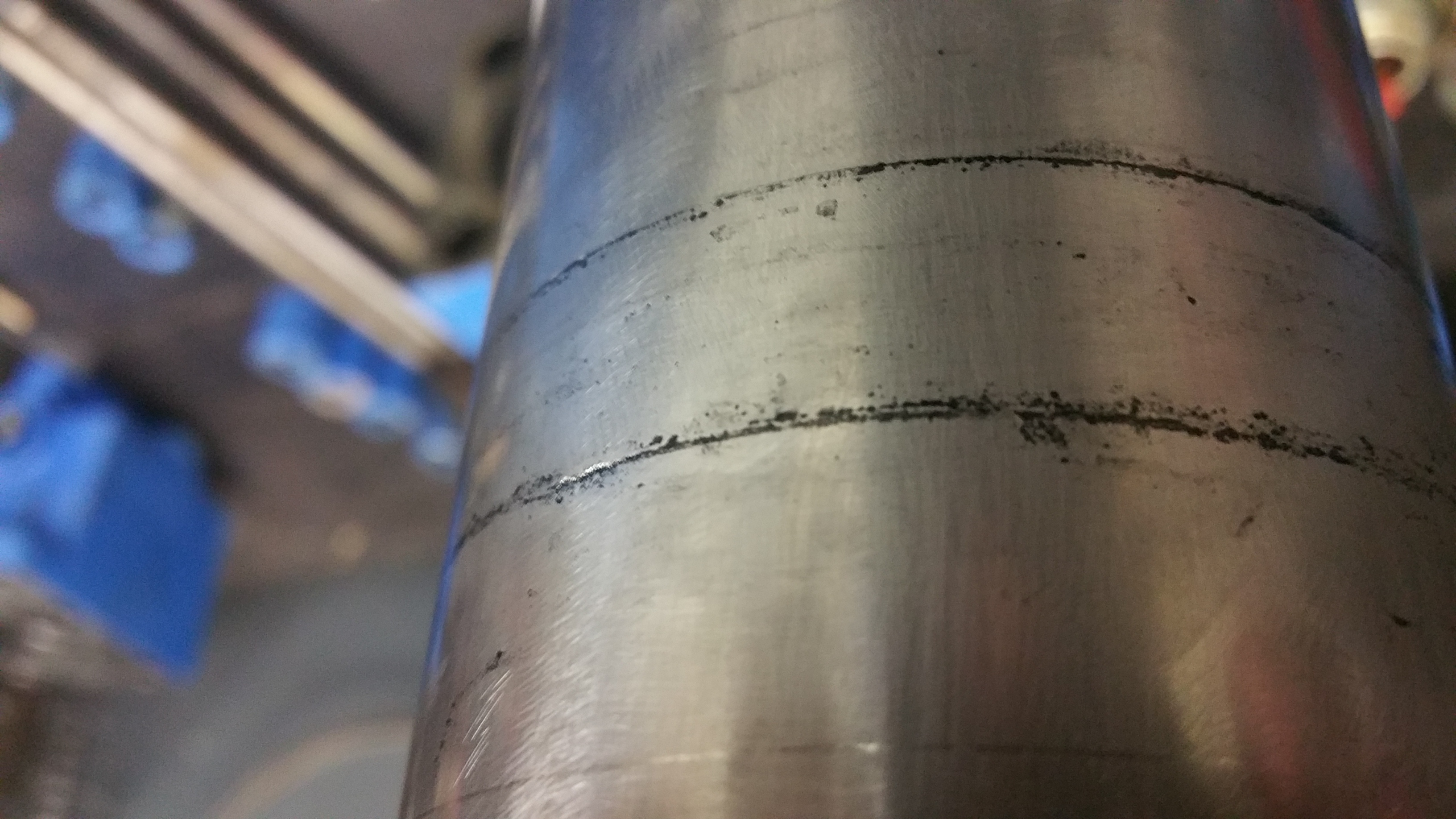

That shaft in the pics looks pretty rough.
You might have better luck finding knowledgeable help on the Heavy Equipment Forum but some of those guys are members here as well.

The piston/shaft is not chrome plated on these so those are before and after pics, I've TIG welded some repairs with silicon bronze and machined it back to smooth.
Thanks for the advice, I'll try over there.
