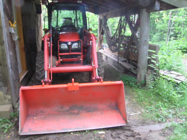

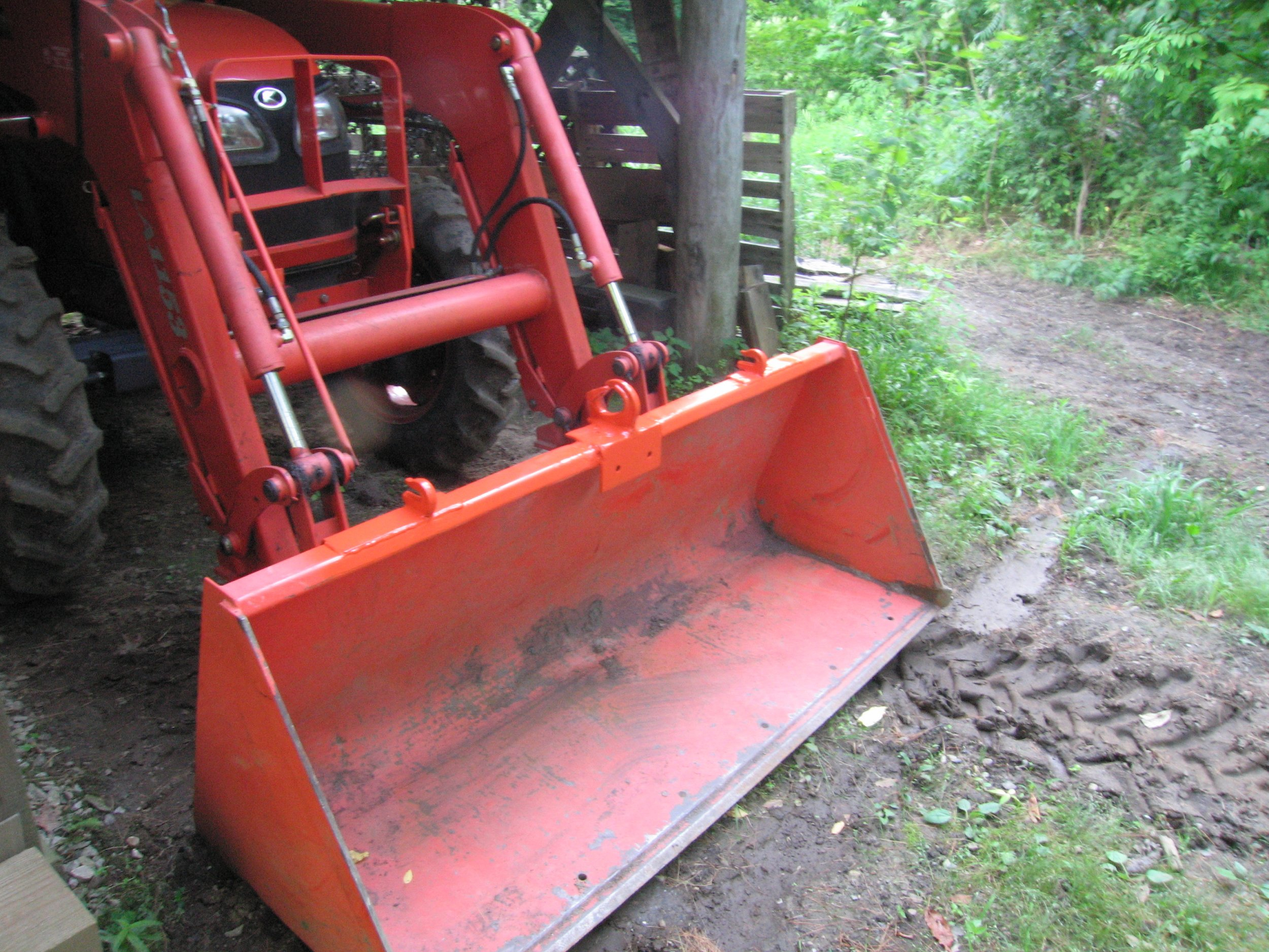

After reading all this, I need to add a middle hook. Got a picture of that setup?
   / Adding grab hooks on front bucket, 2 or 3 hooks? #83
This is my setup

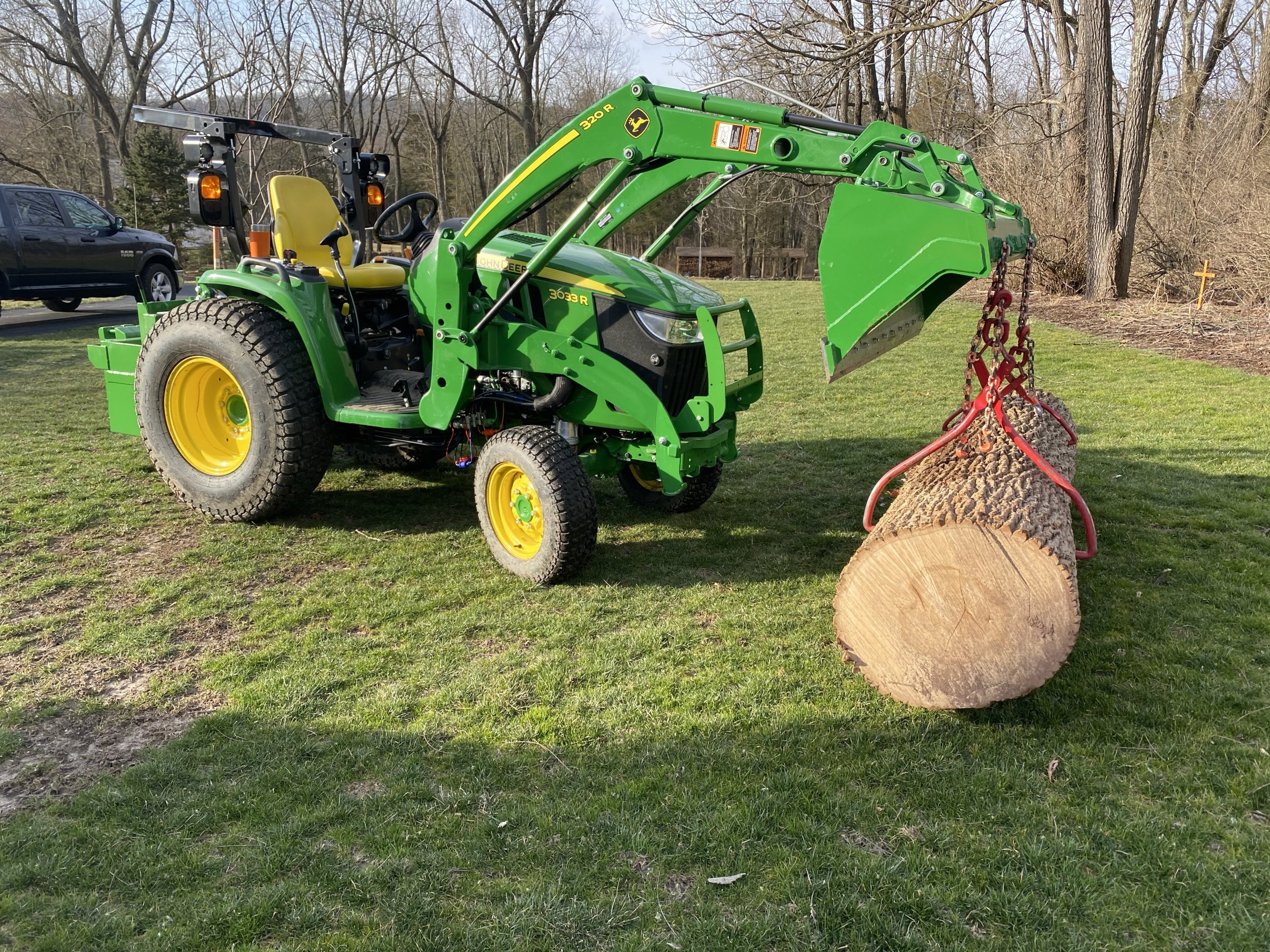

My favorite means of lifting, which I use with utterly countless logs every year, is a pair of 12.5' long chains, each having a slip hook on one end. I throw it around the log, two chain spaced 3' off the mid-point of the log such that they're about 6' apart, and use the slip hook to make a choker out of the chain. Then I hook the loose ends to the grab hooks on either end of my bucket, and lift.
Just realized I don't have any photos of this log choker sling method, but it's very similar to what I'm doing here with tongs, just with choker loops instead. These tongs work too, but you need to have a pair of tongs in each size, for each range of log sizes, not practical for everyone. The choker slings are also better for keeping the log closer to the bucket, such that you can curl and lift high over a trailer side, etc.

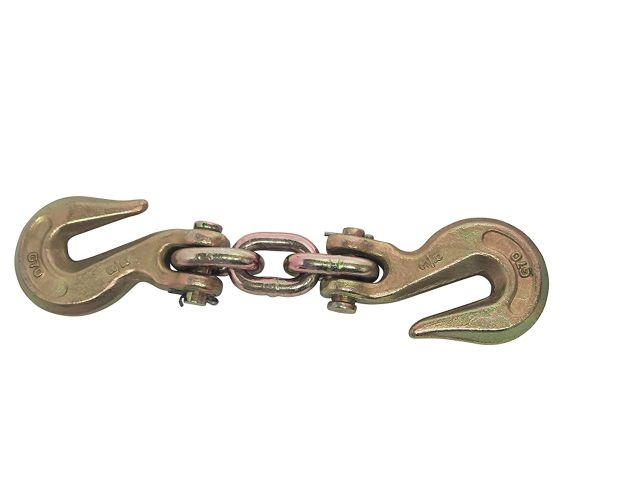

The thing with straps is you are limited to "length" by using loops on straps or doubling straps, the thing is with chains and grab hooks you have a infinite amount length adjustment as to size of individual links in chain....
My goto chains is about an 8 foot and 30 foot (1/4 inch chain) and I find the double hook great for quick length adjustments....
back2back-hooks-jpg.729178
And trying not to use chain slots on bucket for heavy pulls, been using ring attached to tractor chassis for heavy pulls after I realized I have stretched all the links on a 3/16 chain to their max and probably just short of breaking chain, its now retired....
