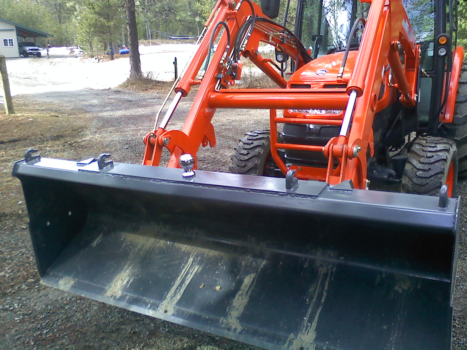

I welded strengthening plate to too center and added 2-5/16” ball for moving trailers, then added hooks. Use them all the time.
