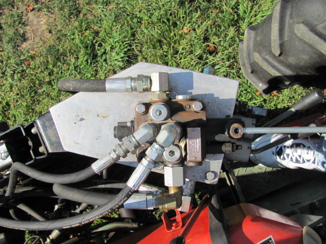

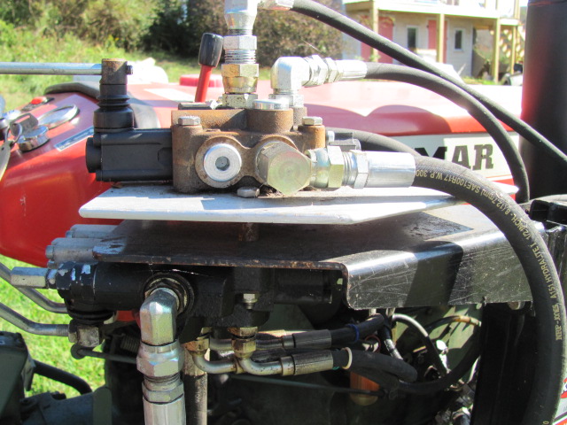

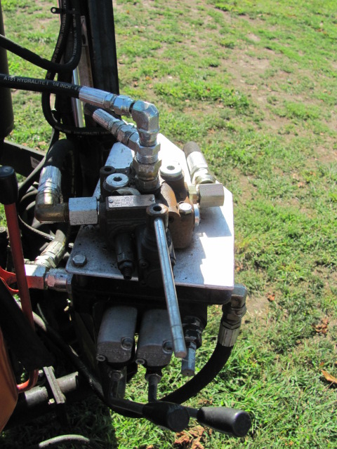

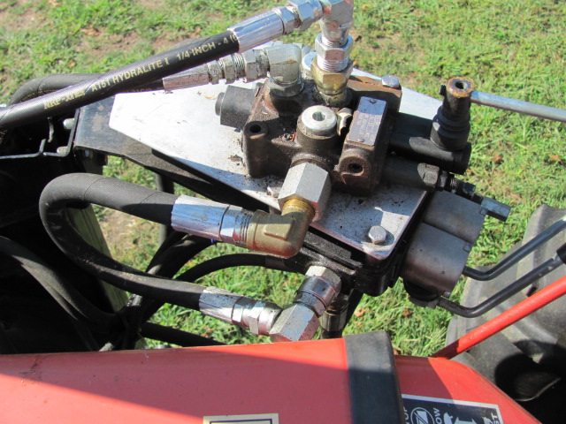

All right, I'm gonna weigh in here. I must confess though, all the three point talk and parallel whatevers? They have me lost!!! The reason I haven't thrown in my two cents is that it sounded like your system was different from mine.
I can tell you what I did. I contacted Koyker, where they were nice enough to sell me a power beyond plug. Once I understood the basic mechanics of it (which took me WEEKS) it was easy. (thanks J.J.:)
The supply to the grapple valve comes from the power beyond plug from the loader valve. The operating lines go from the grapple valve to the grapple, and back to the grapple valve. The used hydraulic fluid goes from the "out" plug in the grapple valve, and tees into the hydraulic return line. It's that simple.
In the photos, you can see how I made an aluminum plate to fit over the existing loader valve, and you can see the "feed" line going from the power beyond plug in the loader valve to the grapple valve (which is the upper of the two).
So....the grapple valve is being fed from the loader valve on the left side in the photos, and the "used" hydraulic fluid exits the grapple valve from the right side of the valve, where it "tees" into the return line from the loader valve.......
All the plugs, lines, grapple, and grapple valve cost around $1,000 (!!!!!!)
