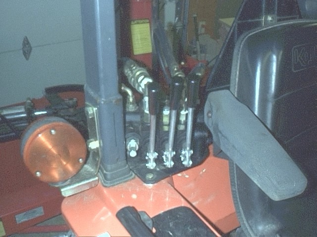

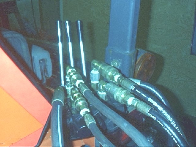

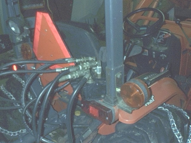

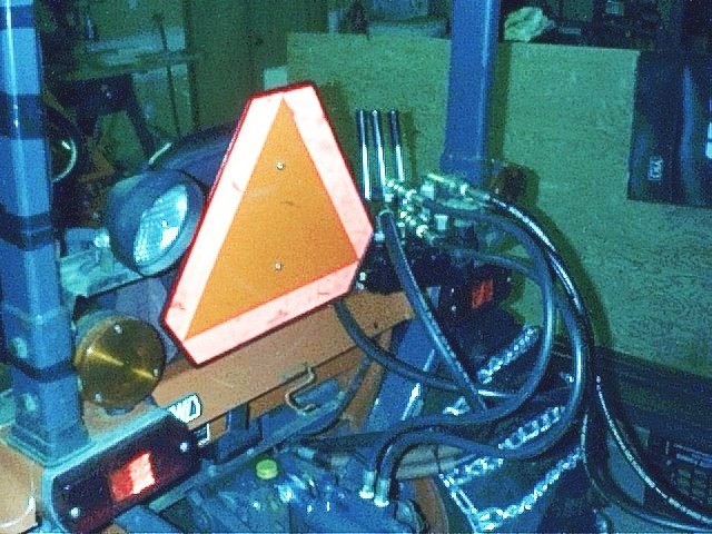

Yes there is a kit but it's way too expensive (>$1000). You need to use a solution like mine (around $450 total), a multi-spool Prince SV valve. Plumbing is simple and at most you would have to make a mounting plate. Plenty of people have gone this route.
