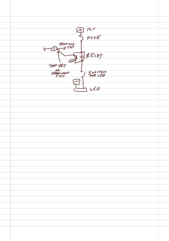

I had to go to the fuse box with the front lights as they drew nearly 25 amps. For the rear lights I tapped into the existing wiring since they only drew 3 amps.

Well....I rummage through a drawer label Truck...and found two relays from a longgggg time ago that I used on some aux lights on a 1979 Ford. So the die is set.
Headlight switch works off key ------> LED switches ------->Fused, relays next to battery --------> LED lights.

I went with a relay and an aux fuse panel when I installed my LEDs. Love the ability to have the lights on with out engine running for short needs and the key off shutting down the lights. I mounted two switches on the dash, one for the two lights facing forward and the other for the rears. The aux fuse panel allows for easy expansion should I add additional electrical devices.

I agree that is nice but I am always fearful that a barn cat will turn the dang things on and run down the battery. Has happened several times with the hazards on my old tractor.
oh sorry I may not have explained it well... unless your cats are good with keys no issue. With key off, the switches are not powered... with key on, whether engine running or not, there is power to them. One mistake I made was to locate them such that they get easily bumped by my knee. But there is not a lot of real estate on the BX25D dash to mount switches so I guess I didn't have much choice. A pain working in cramped space but I am glad I wired to the ignition switch.

The majority of toggle switches will handle 10 amps at 12 volts DC.
A few major brand names will go 15 amps.
That is for the normal size vs the mini styles.
With most LED systems I would not hesitate to switch direct DC without using any relays.
I even switched dual 3" halogen spots with a standard toggle.

The current draws are so low that you can use just about any size wire with the only drawback being physical strength of that wire size.
With just about any LED installation you could go 22 g and still be OK. but for the demands of the rugged environment a tractor lives in I prefer to stay with 16g mainly for the mechanical characteristics (or min 18g)'

Amp draw on 12v LEDs is very small. IMO no relay is needed. I had 6 50w LED flood lights running on a 24v system on my boat wired on one switch with no relay.

I actually don't think so either, except for the circuit I'm pulling from. It takes little effort to add them, so I'm going to.

I'm surprised by many of the comments about LED current draw. Maybe I'm interpreting what people are saying incorrectly, and if so ignore what I'm about to say.
Watts = Volts X Amps (for DC circuits)
This is true regardless of what type of device you are using. A 55 watt LED draws the same amps as a 55 watt halogen bulb. Size switches and wire gauge accordingly. A 55 watt LED is more efficient and will put out much more light than a 55 watt halogen bulb. Conversely, because the LED is more efficient, it will produce much less heat than a 55 watt halogen bulb.
A 70 watt LED light bar draws 5.8 amps (70 watts/12 volts). A 5.8 amp circuit should use 14 gauge wire up to 10' to 15' wire length. If the wire run is longer you should use 12 gauge wire. Two 70 watt light bars and you should use at least 12 gauge wire up to about 15' of wire. These recommendations vary slightly depending on the source, but you can see that just because it's an LED does not make current draw and wire size insignificant.
Get this wrong and you could get lucky and have no problems or you could melt a wire, short it and blow a fuse. Although unlikely, the worst case scenario of undersized wiring is a fire. Please don't assume just because it's an LED fixture that it doesn't draw much current.

To add to my previous post, 6 50w LED flood lights draw 12.5 Amps on a 24 volt system. In a 12 volt system, these lights would draw 25 Amps! That's a lot of current. Better plan for it.

Watts / Volts = Amps
72 / 12 = 6
36 / 12 = 3
So with all of the lights you are looking at you will only be at 12 amps. The switch will handle it just fine. Now the trick will be finding a circuit on the vehicle that will handle the extra draw.
I like to take the draw back to the fuse box where you might be able to tap into an empty lug on the switched side of the box. Mind you, I'm not tapping into a fused circuit, I'm going to the main bus bar. The new line needs an in-line fuse.
I used these switches on my tractor light install. I had to go to the fuse box with the front lights as they drew nearly 25 amps. For the rear lights I tapped into the existing wiring since they only drew 3 amps.

I just installed 4x18 watt LEDs today. The tractor had a 10 amp "work light" fuse with wire terminating at the rear of the tractor. I wired 2 x 20 amp rated toggles each running 2x18 watt LEDs (2 front 2 rear). Each switch will only ever see 3 amps (36 watts for 2 lights divided by 12 volts). I don't see any possible way to fry the 20 amp rated switches or hurt anything upstream of the 10 amp fuse with 3 amps per switch and 6 amps total going through the fuse. If there is a short causing a current spike the fuse should blow before the switches. So I did not use a relay.
However, this thread got me thinking... I'm don't know much about this stuff, is there any benefit from adding a relay in my situation (as described above)? If so, I can't think what that benefit would be so help me out!
This is a good point. DC systems have significant voltage drop as length of run increases. There are charts available to help calculate. I use a book on marine DC wiring.
