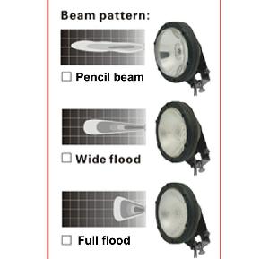

Try to stay with at least 1750 Lumen or higher, I have tried lower rated ones and they don't seem to carry as far. You can get flood, wide flood or pencil flood lights
I have wide flood and I find them great, I tried the pencil beam and it would be nice to have if you had flood or wide flood as it just casts a light straight out. Not great for an all around work light.
