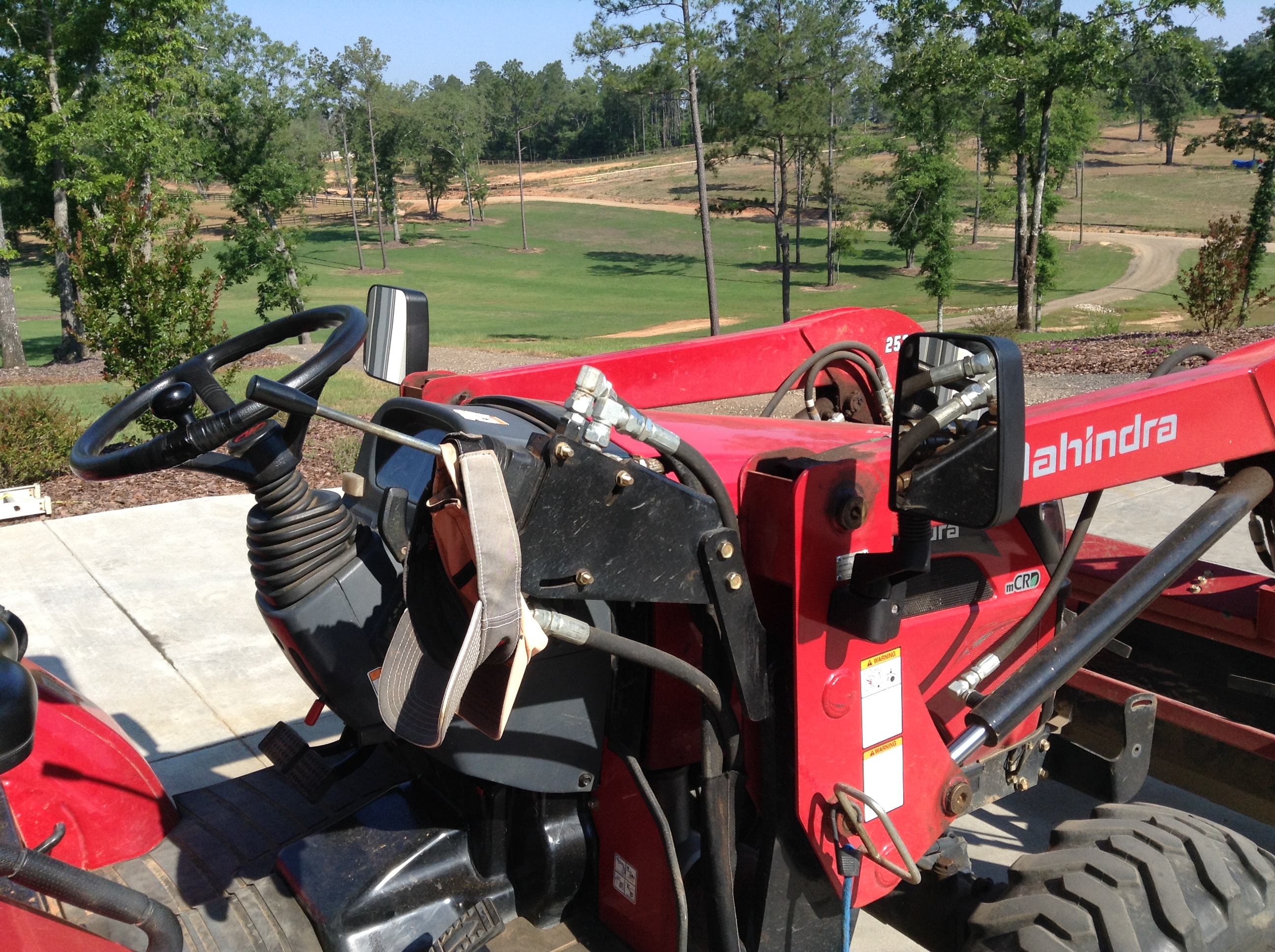

I have some old Jeep CJ mirrors I'm going to mount on my loader arms, going to check out those adhesive studs first. I used some large square U-bolts to attach my fire extinguisher bracket to my ROPS. Worked out well.

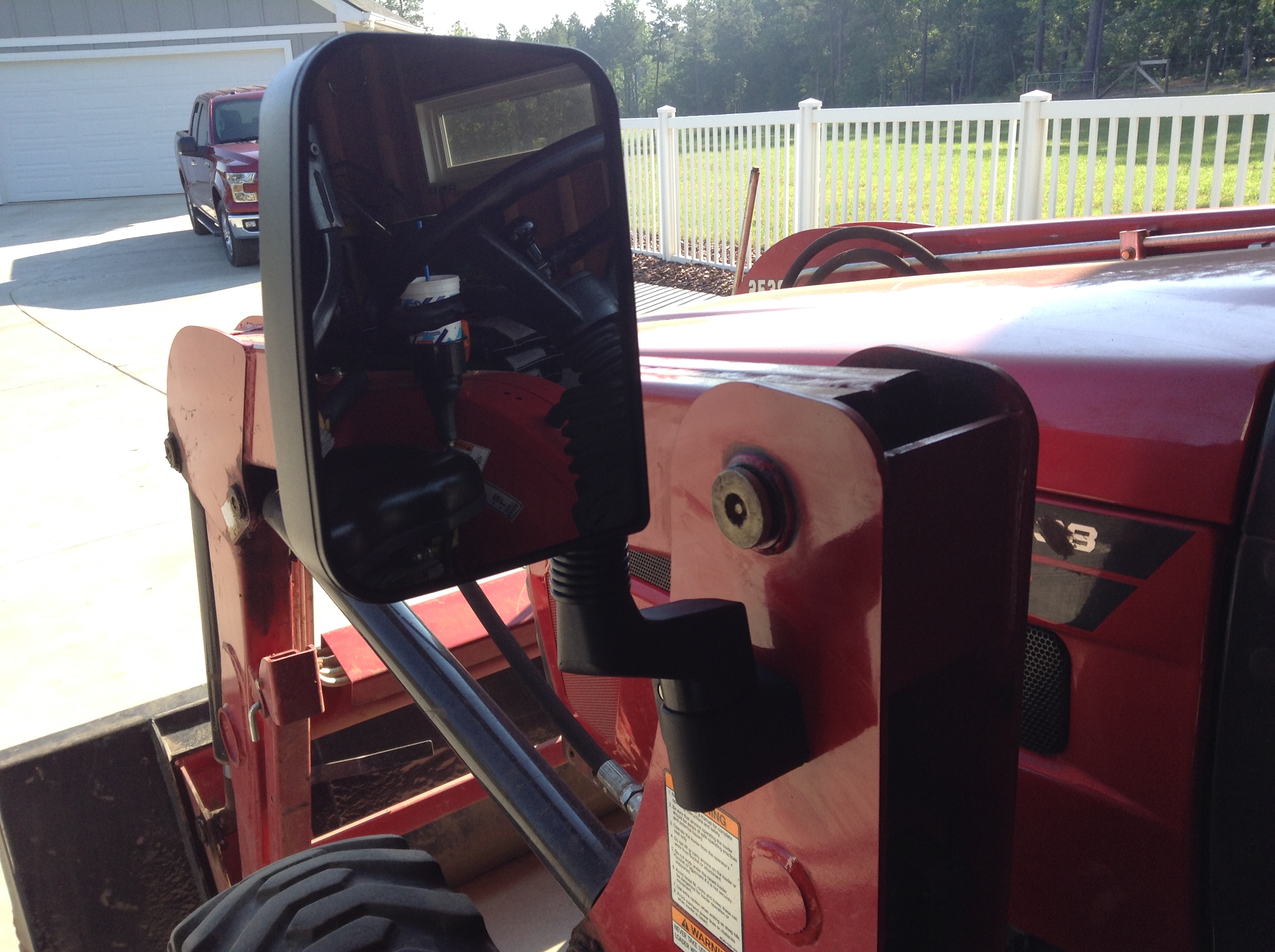

I mounted a mirror on ford years ago but it vibrated so badly, it was useless.
EDIT: I did not incoporate a gasket in the ford installation, it was bracket to aluminum roof canopy.
When I added an aftermarket cab to the kubota, it rests upon 4 dedicated rubber isolation mounts, which absorb vibration. The two exterior cab mount mirrors do NOT suffer the vibration issue.
   / Adding Mirror to Loader Frame #13
Whenever I mount something on my tractor (yes, that includes a mirror on the loader arm) I always include a 'rubber' anti-vibration gasket. It can be as simple as some cut-up floor mat or a cut-up foam-neoprene stubbie holder (koozie?).
It does help.

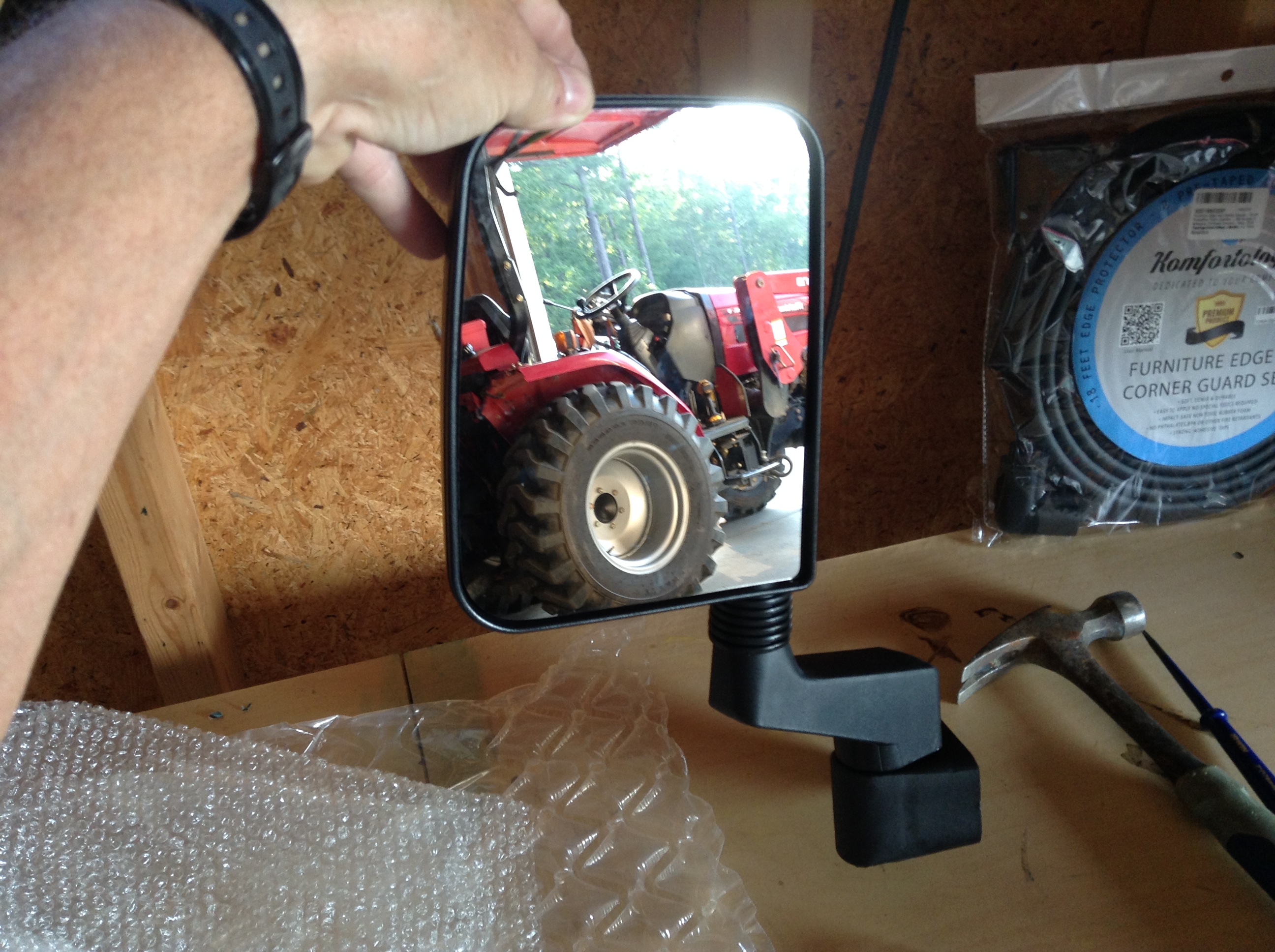

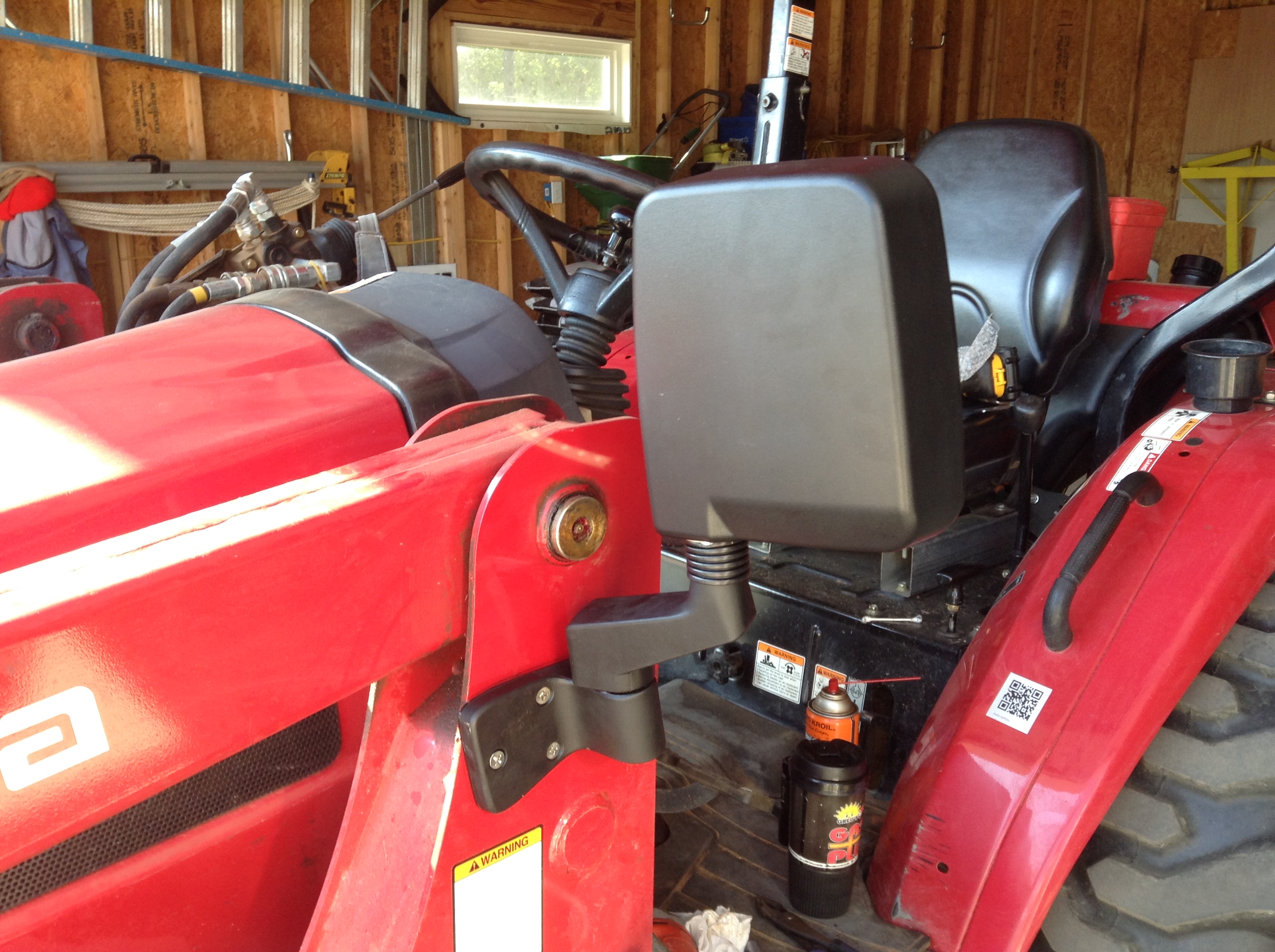

Picked up a pair of adjustable mirrors 6"x7.5" with articulated arms off of eBay. Got the pair for under $30. But the idiot seller didn't include the mounting bolts, as advertised, so I had to run to HD to pick up 6. (I'm amazed HD actually had 6 metric bolts to fit in stock!)

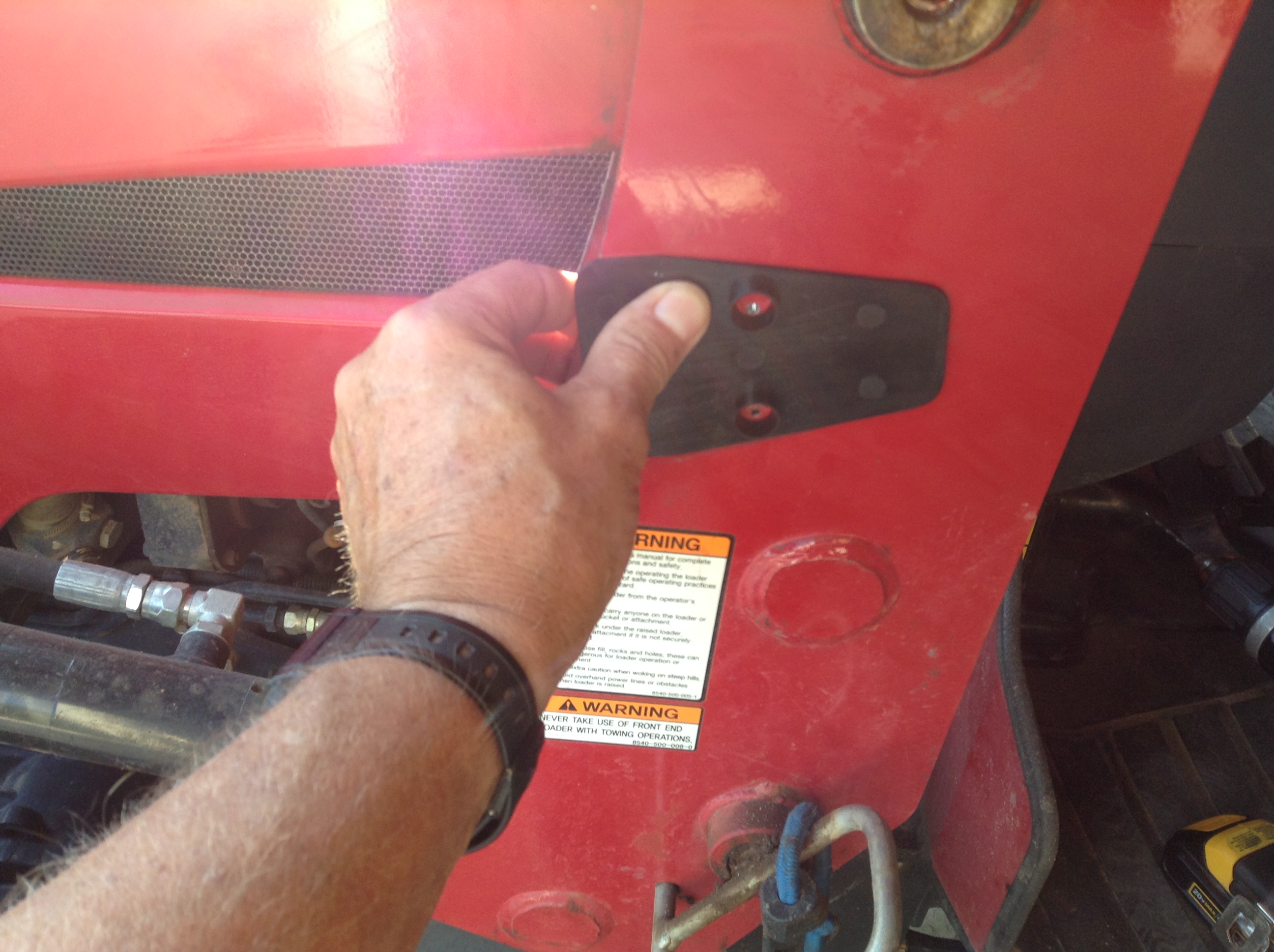

Anyway, found a place on the support structure of the FEL where I could drill and tap holes to mount them. Never had done a hole tap before, so it took me a little longer than you experts, I'm sure, but I got 'er done!
Couple of pics for those who might be interested.
